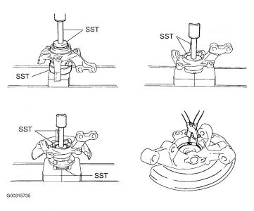

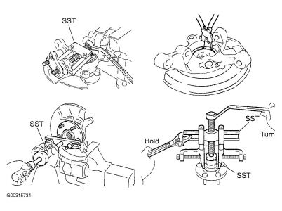

Hi, I am trying to remove the front rotor. It is not easy. How can I get them off? I also am trying to change the front bearing. What should I consider include with new bearing? I wonder what is the size of socket to remove the axel so I can change the bearing. THX. Scott
Apr 23, 2008 at 10:32 PM
BMRFIXIT
  • 19,053 POSTS
Brakes is the easy part of your job after you remove caliper use a hammer and tap the rotor as for the bearing it require removing the hub assembly out of the car and the use of special tool s remove
https://images.2carpros.com/forum/automotive_pictures/99387_toyota_bering_1.jpg
install
https://images.2carpros.com/forum/automotive_pictures/99387_toyota_bearing_1.jpg
