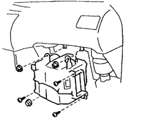

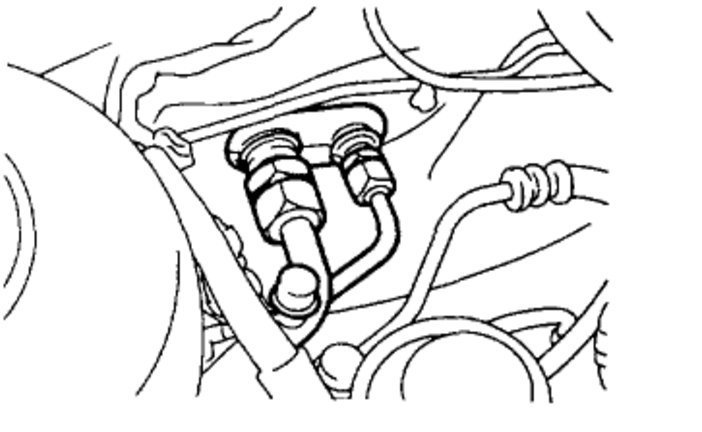

The low side pegging the gauge is telling you there is a blockage or the expansion valve is stuck on the evaporator core. This means the system will need to be vacuumed down so you can take the valve out and inspect it. If it is clogged with debris it means the compressor is coming apart and will need to be replaced.
Here is a diagram and a couple of guides to help you get the problem fixed.
