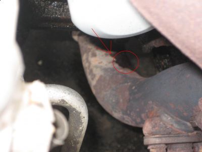

Oh, and the smoke we found out is caused by oil leaking onto a hot pipe. As soon as it hits, it's burning. I inserted a picture of the pipe and circled in red the area where it hits. Is there something I can do so that the oil doesn't burn there?

If there are any threaded bolts holes nearby, get some steel, aluminum sheet (small piece) and use it as a shield to keep oil of exhaust pipe.
The pan will have to be removed, to do this you will have to remove right engine mount, loosen the rest and lift engine about 3-6". The rear pan bolts (next to trans) are hard to get to.
Remove pan, clean all surfaces. Use a sealant called "the right stuff" made by permatex. Apply to pan surface and install pan. This sets quickly so you only have 5-10 minutes to get it on and bolted up.
Also make sure the pan bolts are clean, do not overtorque them as this will distort pan

I will definitely try that trick to get the oil to stop dripping onto the pipe. What is the risk if I drive 200 miles? I would be stopping every 50 or so to check the level of oil. I just want to get there because my dad and I can then (hopefully) do this ourselves and save about 250 in labor costs.
My only worry is that stuff under the hood is kind of corroded and rusty. Is that going to be a problem with changing the oil pan/resealing it? The bolts might not come out nicely.

Use PB blaster to loosen bolts, you may want to make sure they are tight first.
The trip is your choice, checking oil is a good idea, also if you go, get a fire estinguisher, fo oil.
