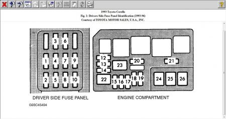

All lights or working but dont have brake lights check all fuses were good no power to brake light switch can someone help me with this

Stop lights fuse 25amp okay you have an open between the fuse and brake switch.

Is this fuse in the left kick panel or under the hood

Check fuse no.6 see below
https://www.2carpros.com/forum/automotive_pictures/12900_fuse_brake_1.jpg
