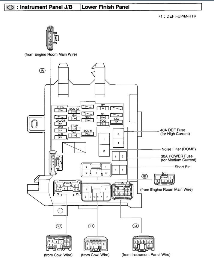

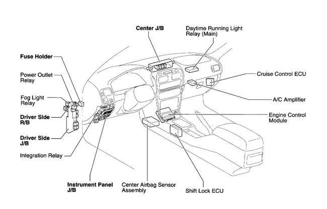

Please tell me where is the brake light located in my car? Thank you.
Feb 19, 2010 at 6:40 PM
  • 75,992 POSTS
The brake light fuse is the stop fuse 15amp in the instrument panel junction block behind left side of dash at lower finish panel-If the fuse is okay -check and test the brake switch
Heres a guide on using a test light , it will help
Attached below you will find the fuse block location and fuse ID

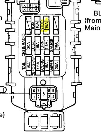

Hi, I've noticed my stop lights are not working.. I need help finding the fuse location and number. Thank it's a 1995 Toyota Corolla ae92 shape have added a pick of the fuse box.
Mar 17, 2021 at 11:16 AM (Merged)
  • 110,240 POSTS
Welcome to 2CarPros.

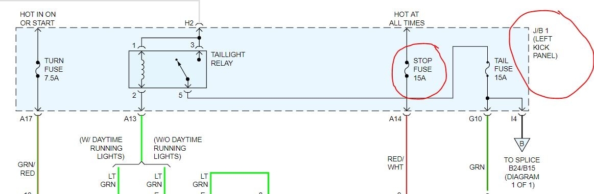

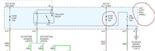

The brake light fuse is in the fuse panel above the left kick panel. I attached two pictures. First shows the fuse in a schematic and the second I included a picture of the fuse box and fuse location.
Here are a few links you may find helpful:

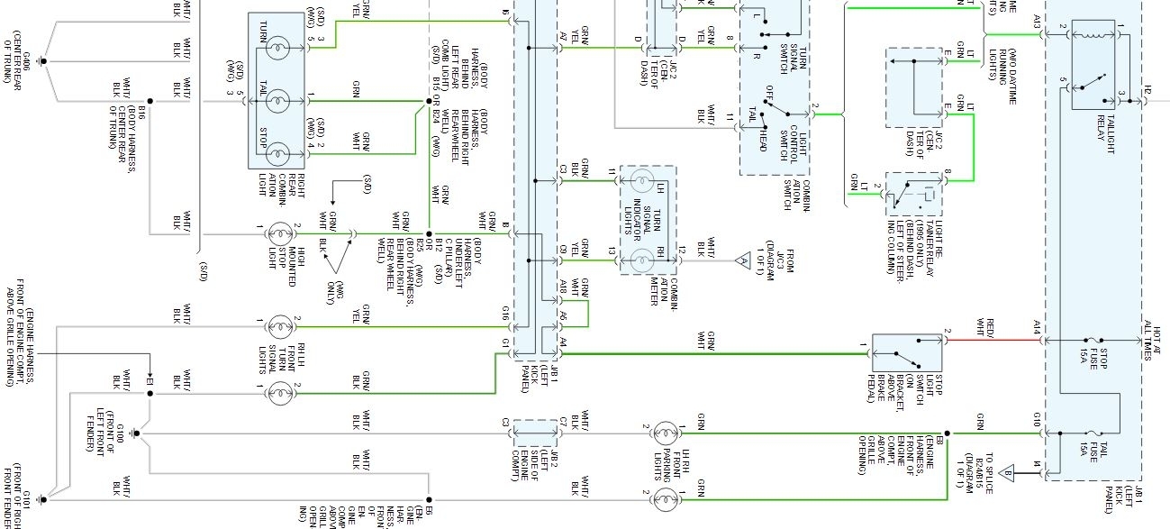

Let me know if this helps or if you have other questions. If you find the fuse isn't the issue, I'll explain what to check next. Check out the diagrams (Below). Let us know what happens and please upload pictures or videos of the problem.

Welcome back to 2CarPros. The fuse will be in the box in the left kick panel. It will be marked as the Stop Fuse. From the fuse it goes to the stop light switch on the red wire. Then out of the switch on the green wire with white stripe. It feeds power to the rear brake lights and the upper brake light. You can test for power at the switch with just a test light. Also check the brake pedal at the switch, some of these use a plastic insert that goes into a hole that activates the switch, the plastic breaks and you get no brake lights.
