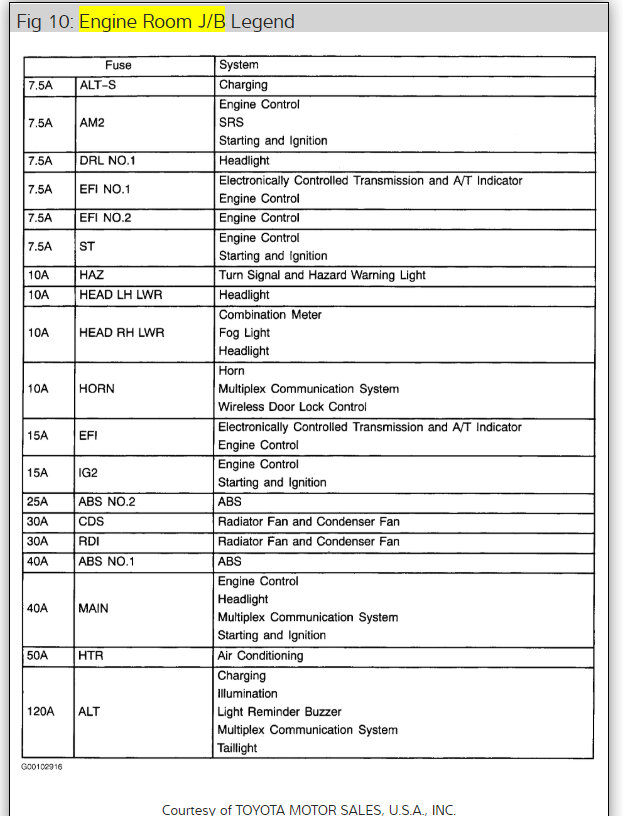

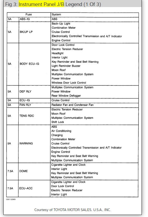

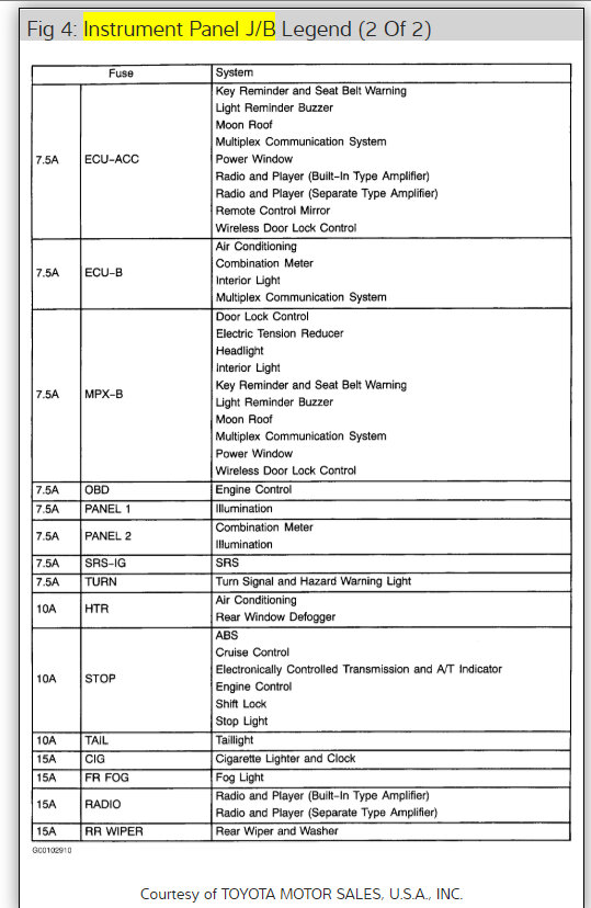

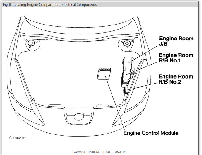

I have a 2001 Toyota Celica GTS with 41,540 miles on it. I went to start it and it goes click, click, click, click. The radio and lights all worked. My husband jumped me and it started. I drove it home and this morning it goes click, click, click. My husband was at work so I tried to jump it myself and I put the negative on the positive on the bad battery! I tried to turn my car on and nothing and the jumper cables started smoking so I took the cables off. I realized what I did wrong and put the jumpers on properly and the car started right up, but the radio is dead. What do you think is wrong and how will I know if I fried the battery? Thank you so much!!! Sincerely, HOPELESS GIRL

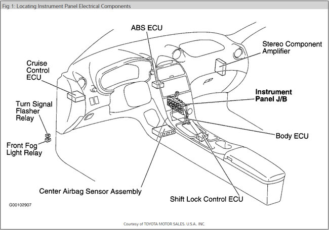

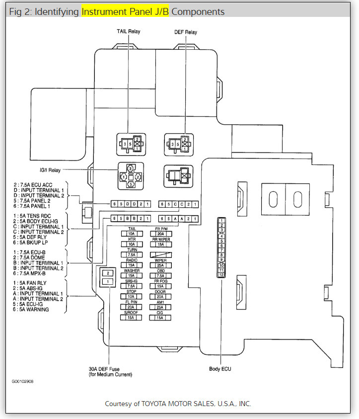

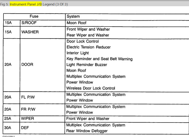

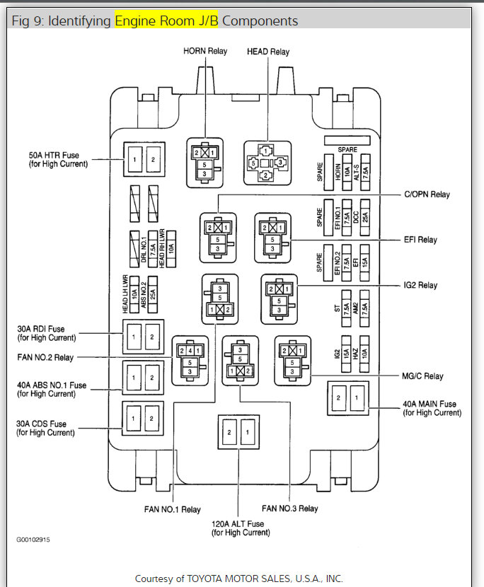

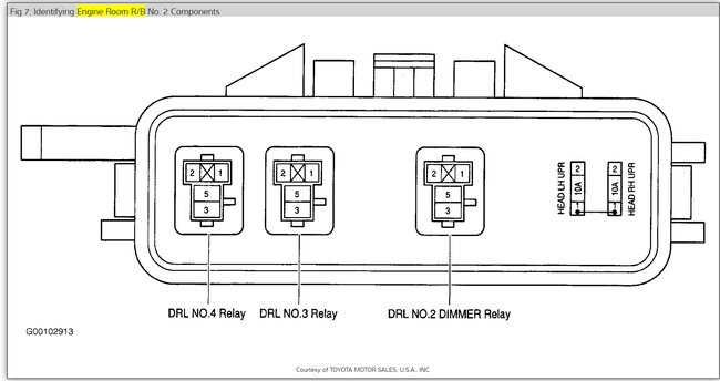

You should be okay, but you popped some fuses that need to be replaced here is a guide to help and the fuse location in the images below.
Check out the images (below). Let us know how it goes

Suggested Repair
Check and replace blown fuses, especially those feeding the radio, after the reverse-polarity jump. Use the fuse locations and the fuse-checking guide provided.
