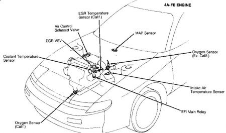

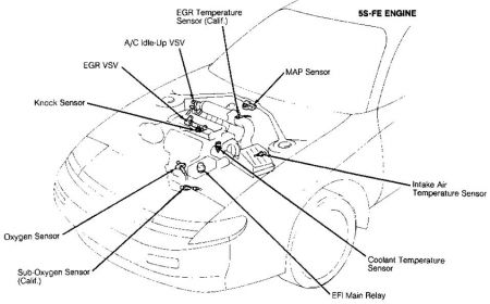

ts a 93 celica st with a newly swapped 5afe in place of the 4afe( direct swap).I swapped the engine but no starting for me. Never thought it was right changed the distributor 3 times. Noe if i jump the switch side of the relay it will run on starting fluid. but the fuel pump wont come on. The fuel pump is good the engine was just running previously with 3 holes in the block. Did the self diagnosis via engine light and it says nothing is wrong, no code at all. I'm running on low, since Friday with it and i know it has to be something small. i've studied the haynes manual but it sucks and is not a complete wiring diagram which it even tells you in the book they don't provide all diagrams. Also where or is there a fuel pump relay?
