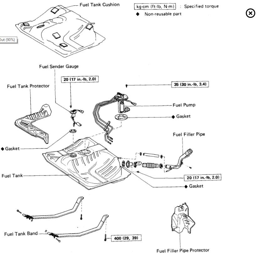

I cannot find the fuel pump. I removed the back seat there is only a sender unit. can you help please?

You will need to remove the fuel tank to gain access to the fuel pump.

Thank you. Is it difficult to remove the fule tank of this car

It is not too bad you will need to drain the fuel first. here are some guides and a diagram (below) to help you get the job done.
https://youtu.be/Q5MH2gnyFH0
This will give you an idea on what you are in for when doing the job.
https://www.2carpros.com/articles/how-to-replace-an-electric-fuel-pump
