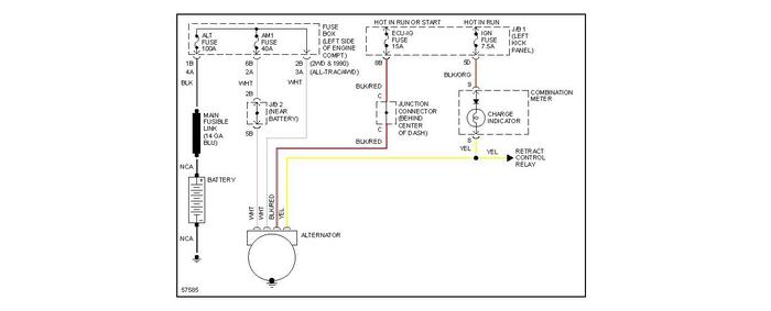

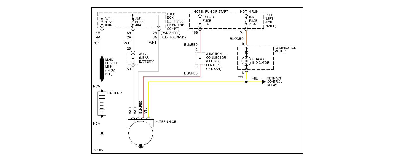

TMOOSE357
  • 1990 TOYOTA CELICA
  • 22,550 MILES
Started with turning over no start, to no signal to starter, changed the efi main solenoid, car starts battery light on, check charging system, not charging, check all connections, not charging, remove alternator have tested fail, buy new alternator install, connect battery, start engine battery light still on, check charging system started at 13.5 volts to 14.5 volts on acceleration then slowly decreases after five minutes of running, shut car off check all connection with no change. Any suggestions would be greatly appreciated.
Wednesday, December 30th, 2020 AT 5:37 PM (Merged)
  • 75,992 POSTS
Check/Test everything you see below

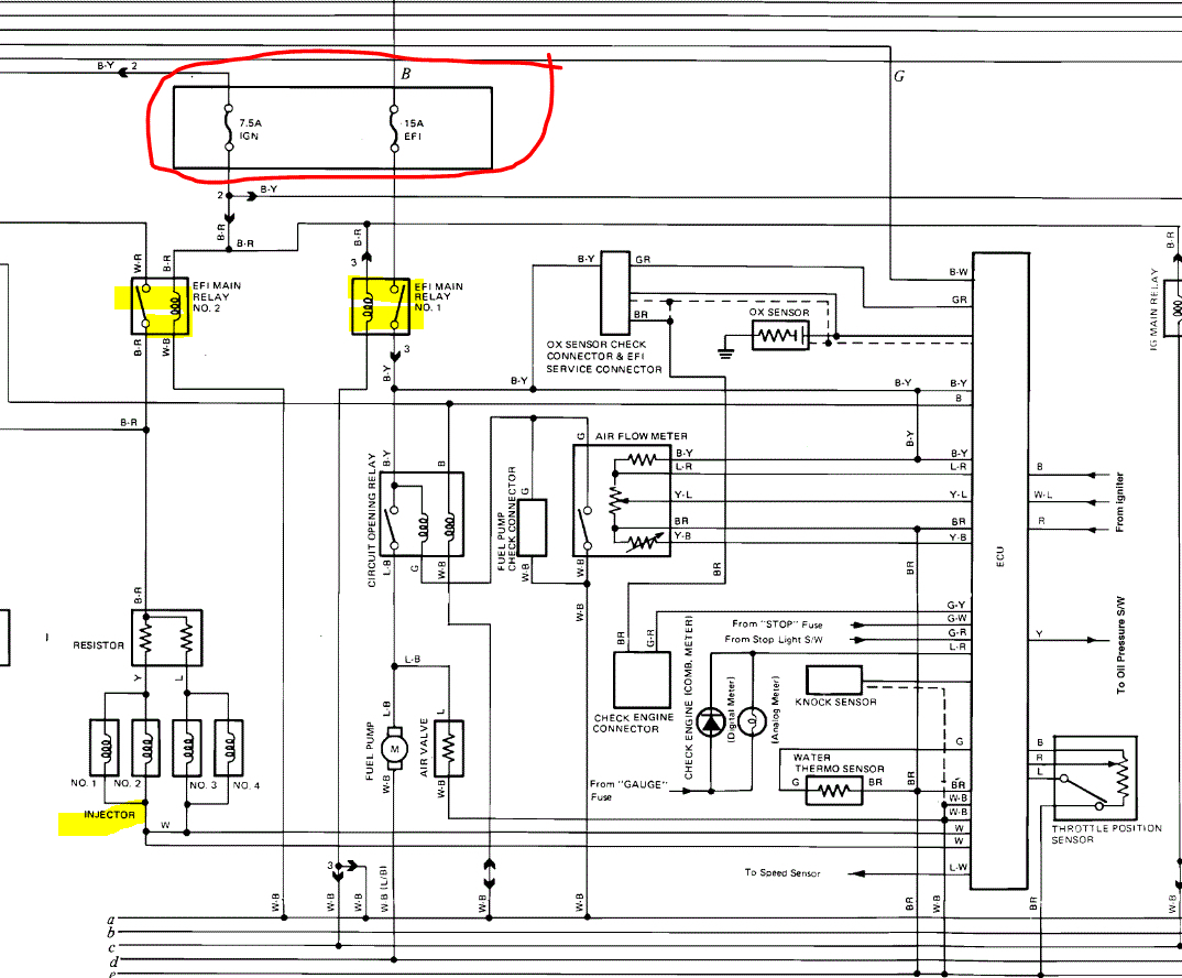

DWGJR1957
  • 7 POSTS
  • 1985 TOYOTA CELICA
  • 2.4L
  • 4 CYL
  • 2WD
  • 216,000 MILES
Crank but will not run.
Wednesday, December 30th, 2020 AT 5:38 PM (Merged)
  • 109,885 POSTS
HI:
Honestly, Ken is the owner of the site and is constantly running. LOL He wouldn't give up. Can you explain what have been covered so far? Have you determined if the is spark and fuel to the engine? Have you checked to make sure compression is where it should be?
DWGJR1957
  • 7 POSTS
Yes, there is a spark and fuel. The compression is very good.I had a mechanic look at it and he said that the fuel injectors are not getting the proper signal to fire the injectors. He hot wired the cold start injector and it runs but then it floods and stops running after a few minutes
  • 109,885 POSTS
Hi:
If there is no injector pulse, first confirm the fuses in the attached pic are good. Next, confirm that EFI relays 1 and 2 are getting power.
The signal to fire the injectors comes from the ECM, so make sure the connector is tight, clean, and not corroded. If it looks good, you will need to confirm a signal from it is present. If there is no signal and everything is in good condition, the ECM itself will need tested.
Let me know what you find.
