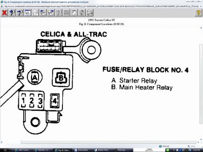

MISTAKAT123
Car wont start sometimes, does not even crank.. tryed to start it a couple hours later and fires up like new!, the battery and alternator are brand new what might be the problem? : , did the same thing before i bought a new alternator and battery which didnt help..., thanks! :), may not be an electrical problem?
Dec 30, 2020 at 9:37 AM (Merged)
MERLIN2021
  • 17,250 POSTS
Do you hear a click when you turn the key to start? If not the relay is bad, if yes the starter is bad...
MISTAKAT123
nope no click no nothing makes a lil noise like it wants to crank but it dont., which relay and what kind of relay would i need?
MERLIN2021
  • 17,250 POSTS
Relay is located in the fusebox
