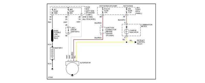

TMOOSE357
started with turning over no start, to no signal to starter, changed the efi main solenoid, car starts battery light on, check charging system, not charging, check all connections, not charging, remove alternator have tested fail, buy new alternator install, connect battery, start engine battery light still on, check charging system started at 13.5 volts to 14.5 volts on acceleration then slowly decreases after five minutes of running, shut car off check all connection with no change. Any suggestions would be greatly appreciated.
Dec 30, 2020 at 9:37 AM (Merged)
  • 75,992 POSTS
Check/Test everything you see below

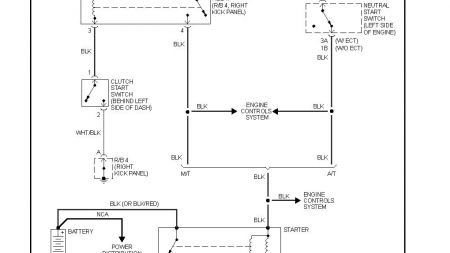

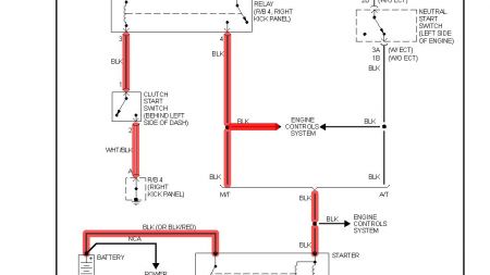

YHTAK27807
1990 Toyota Celica GT 2.2 Car won't start, starter won't turn over. got power going in. Had starter checked and was told it was good. Battery good, power in lines to starter before turning key and after.
  • 75,992 POSTS
Troubleshoot-see below schematic/diagram
https://images.2carpros.com/forum/automotive_pictures/12900_st1_8.jpg
https://images.2carpros.com/forum/automotive_pictures/12900_st2_8.jpg

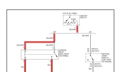

RJMAURIGI
when i try to start the car i get nothing. I pump the clutch and here the starter relay making i charged the battery and i can jump it off. Is it possible that my battery doesn't have enough cold cranking amps(500) or is possible that the alternator is not recharging the battery?
  • 75,992 POSTS
Get the battery and alternator load tested-if it checks out-troubleshoot the ignition switch/clutch switch/starter relay and starter itself see below diagram
https://images.2carpros.com/forum/automotive_pictures/12900_st1_20.jpg
https://images.2carpros.com/forum/automotive_pictures/12900_st2_18.jpg

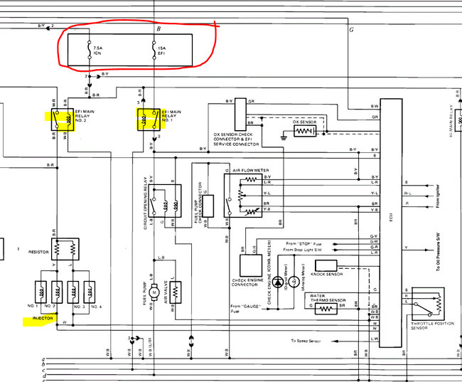

DWGJR1957
  • 7 POSTS
Yes, there is a spark and fuel.. The compression is very good.I had a mechanic look at it and he said that the fuel injectors are not getting the proper signal to fire the injectors.. He hot wired the cold start injector and it runs but then it floods and stops running after a few minutes
Dec 30, 2020 at 9:38 AM (Merged)

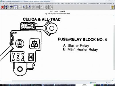

  • 110,244 POSTS
Hi:
If there is no injector pulse, first confirm the fuses in the attached pic are good. Next, confirm that EFI relays 1 and 2 are getting power.
The signal to fire the injectors comes from the ECM, so make sure the connector is tight, clean, and not corroded. If it looks good, you will need to confirm a signal from it is present. If there is no signal and everything is in good condition, the ECM itself will need tested.
Let me know what you find.
