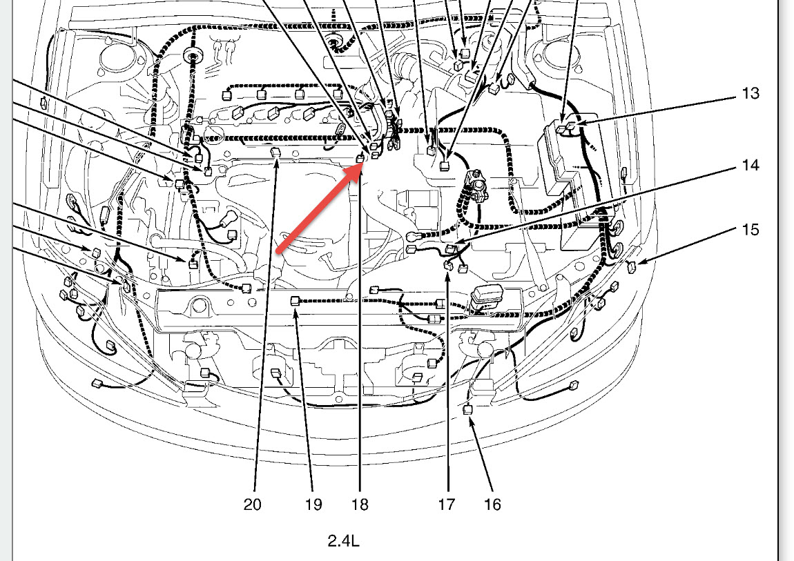

i have this issue with my car and it has been giving me headache for months.
the gear went bad and it was changed nine months ago. After a month of gear change, it started failing again, but not rampant. Took it to the gear expert and he said it was the brain-box. Changed brain-box but still not solved. Changed knock sensor, still same. Replaced gear but still the same. Scanned and saw error code P0500. Please kindly help me as I am confused.

That is the vehicle speed sensor A is giving a problem or the wiring to it. But sensor is item 18 in picture.
