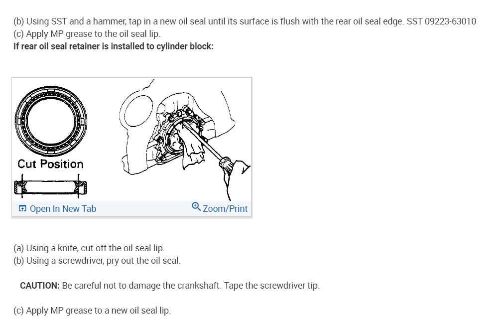

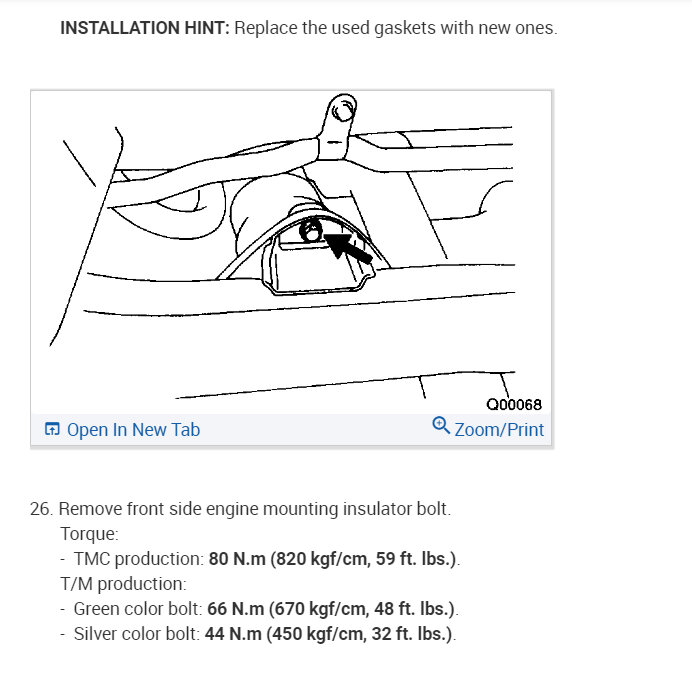

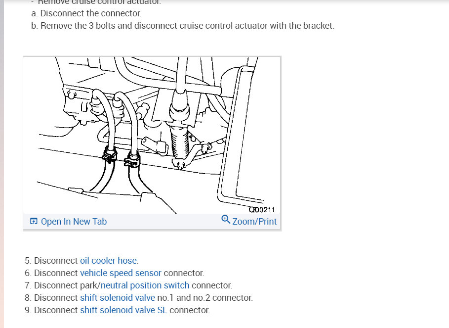

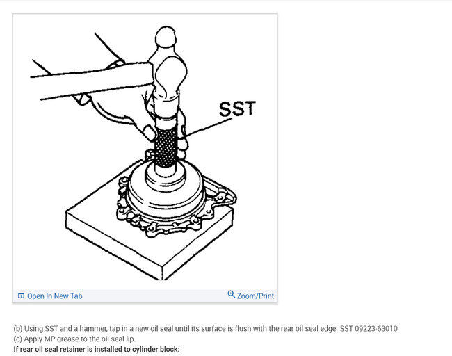

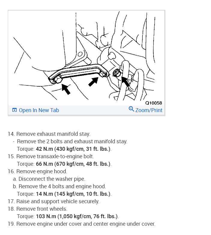

A local mechanic told me that I have a leaky rear main oil seal. The cost would be $750 to repair it. Being a budding do it yourself mechanic, I'm tempted to attempt the repair myself, (plus I enjoy trying car repair jobs). The limited feedback that I've gotten, specify that the seal is relatively simple to replace, it is just getting to it, that is murder. The manufacturer recommends dropping the transaxle out the bottom and going at the repair from this direction. The Haynes repair manual suggests taking the transaxle and engine out from the top, to get to it. I'm not willing to take the latter route. Would the manufacturer's recommendation be all that complicated to do? Is my success going to be largely due to whether or not I have the right equipment, more than the complexity of the actual disassembly/reassembly? Basically I just want to know if I'm getting in over my head, since I'm a fairly good weekend mechanic, but by no means a pro. Thanks for any input.

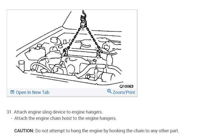

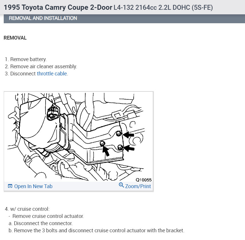

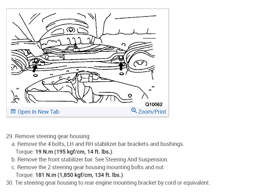

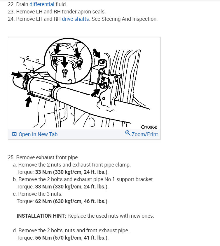

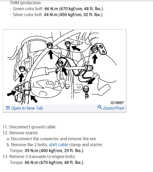

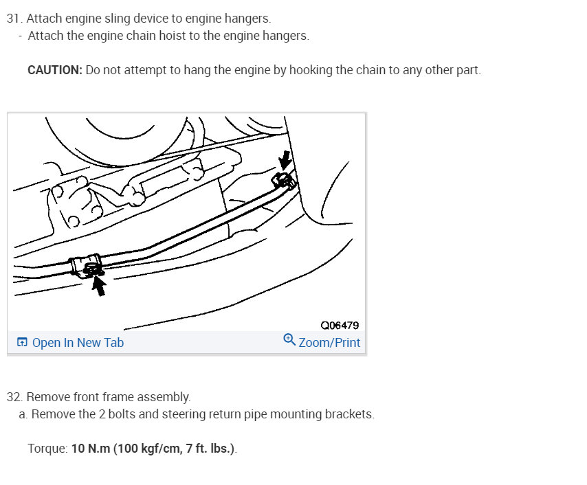

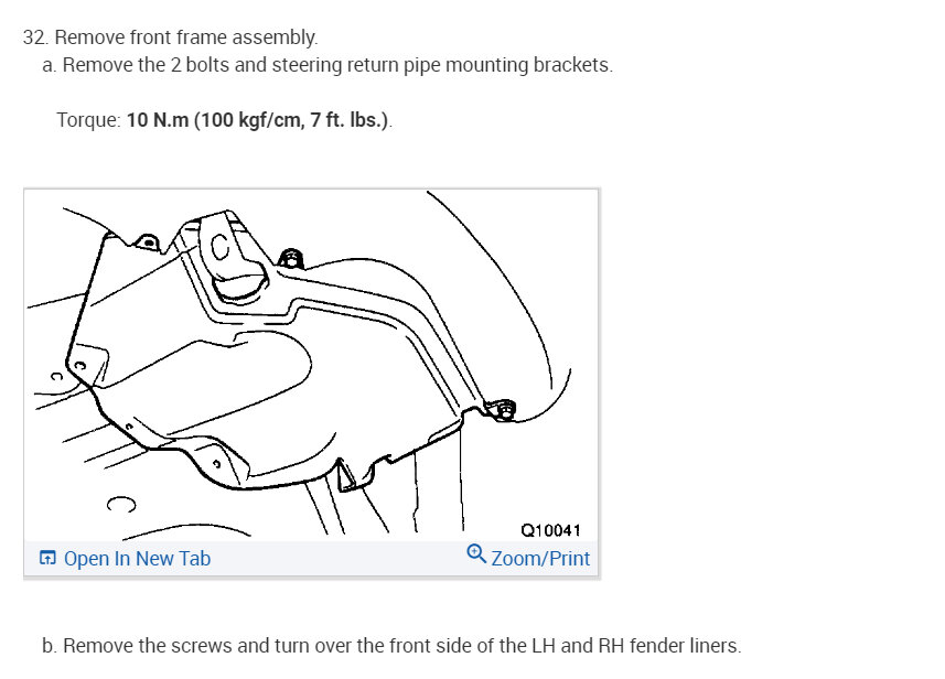

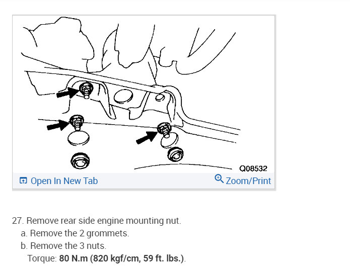

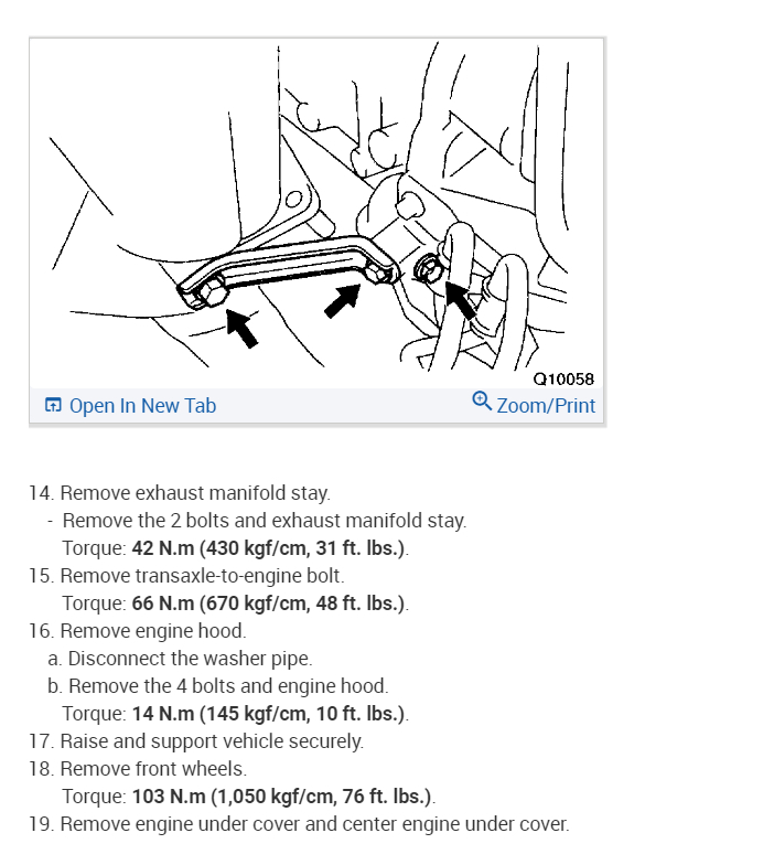

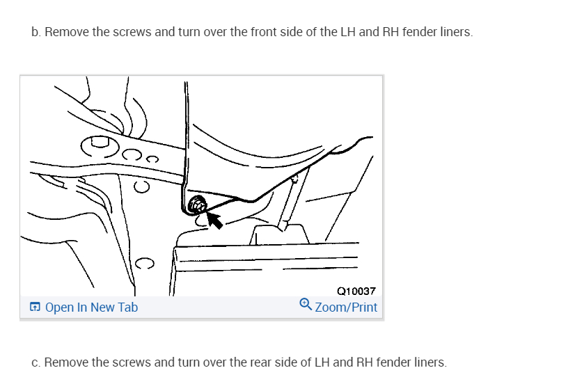

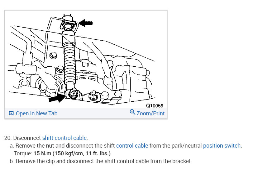

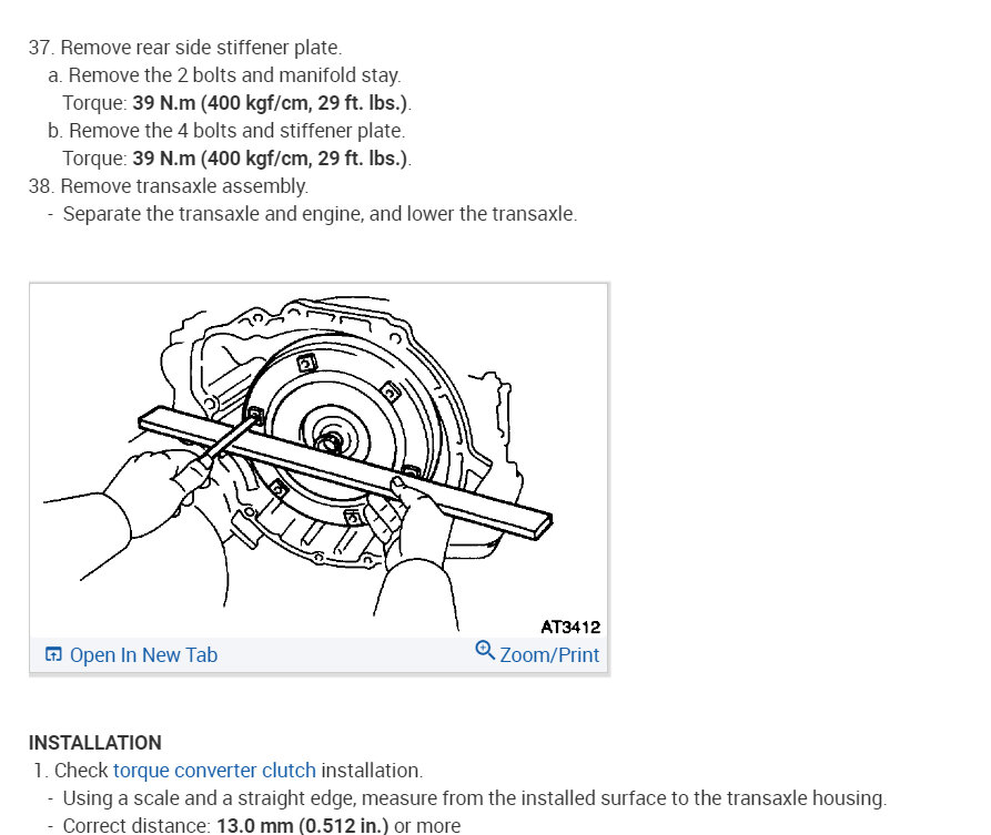

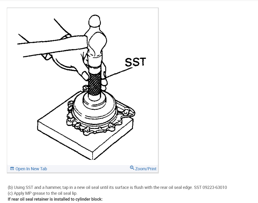

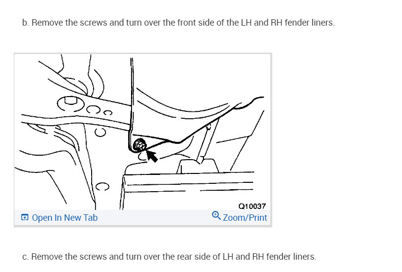

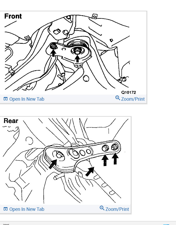

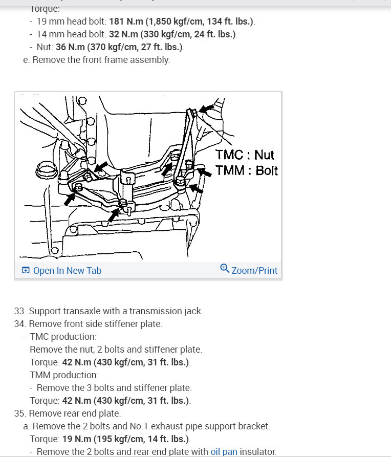

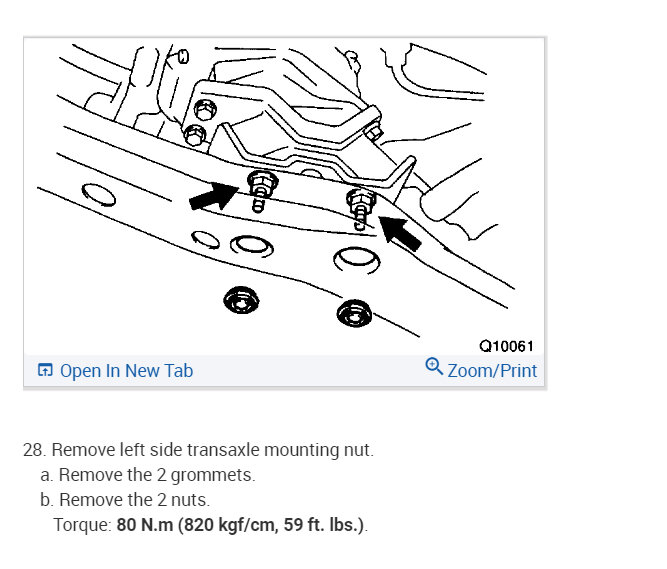

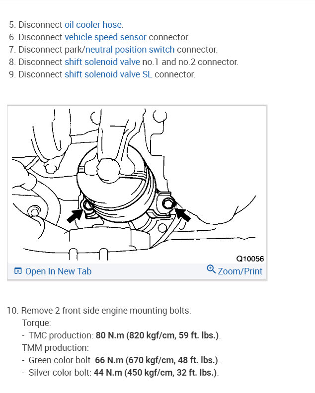

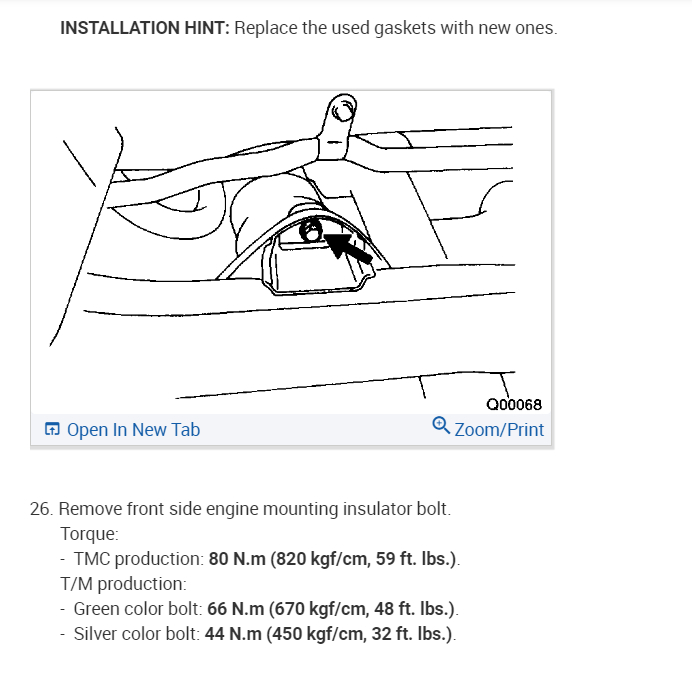

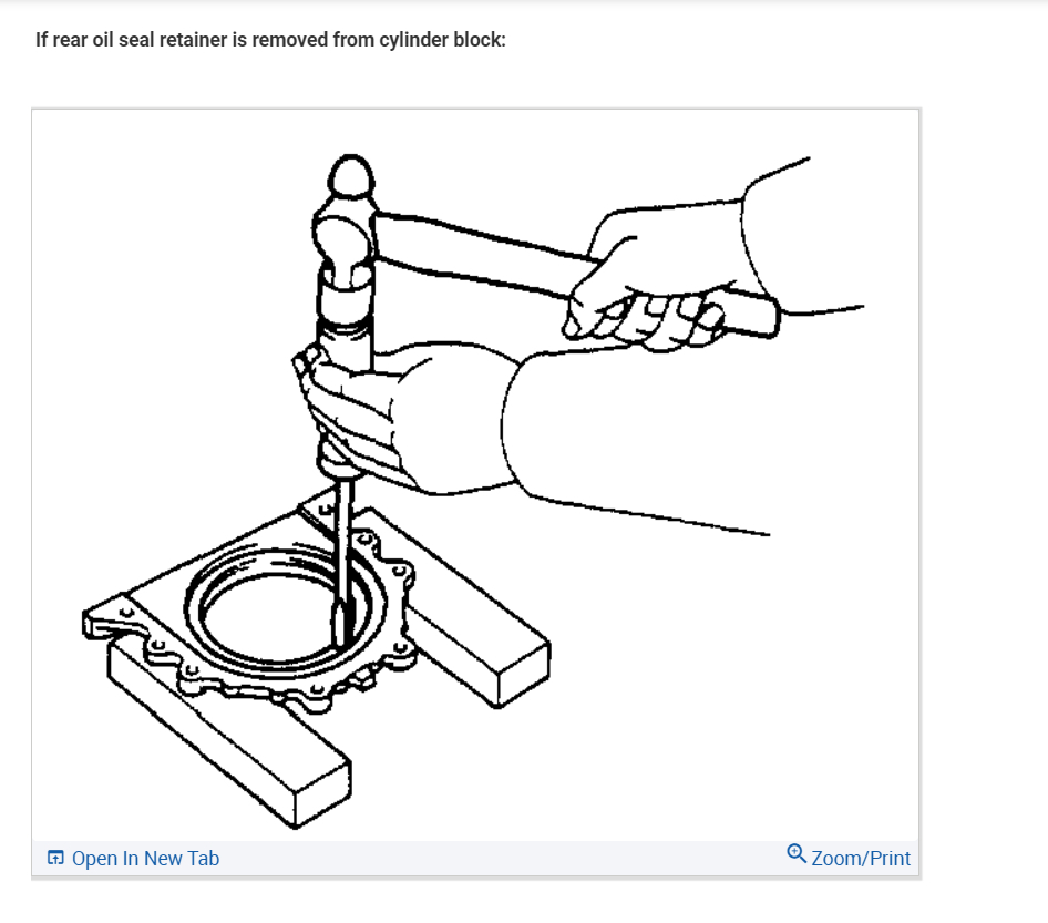

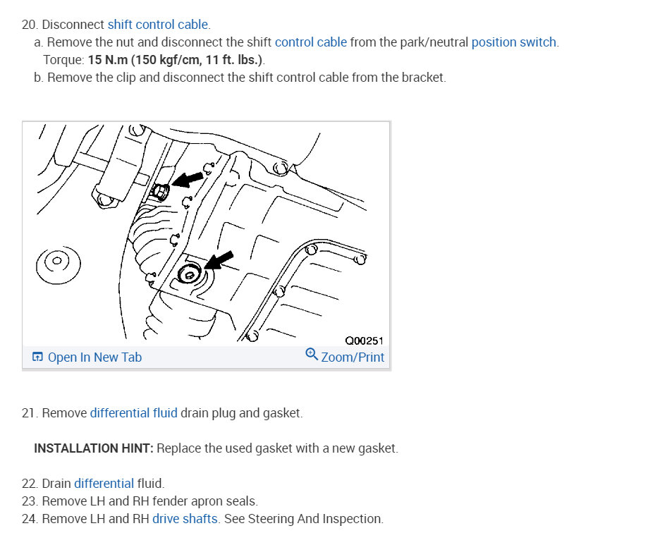

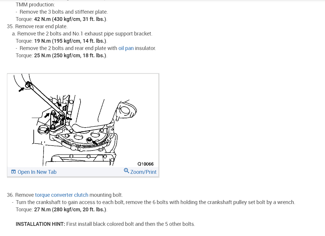

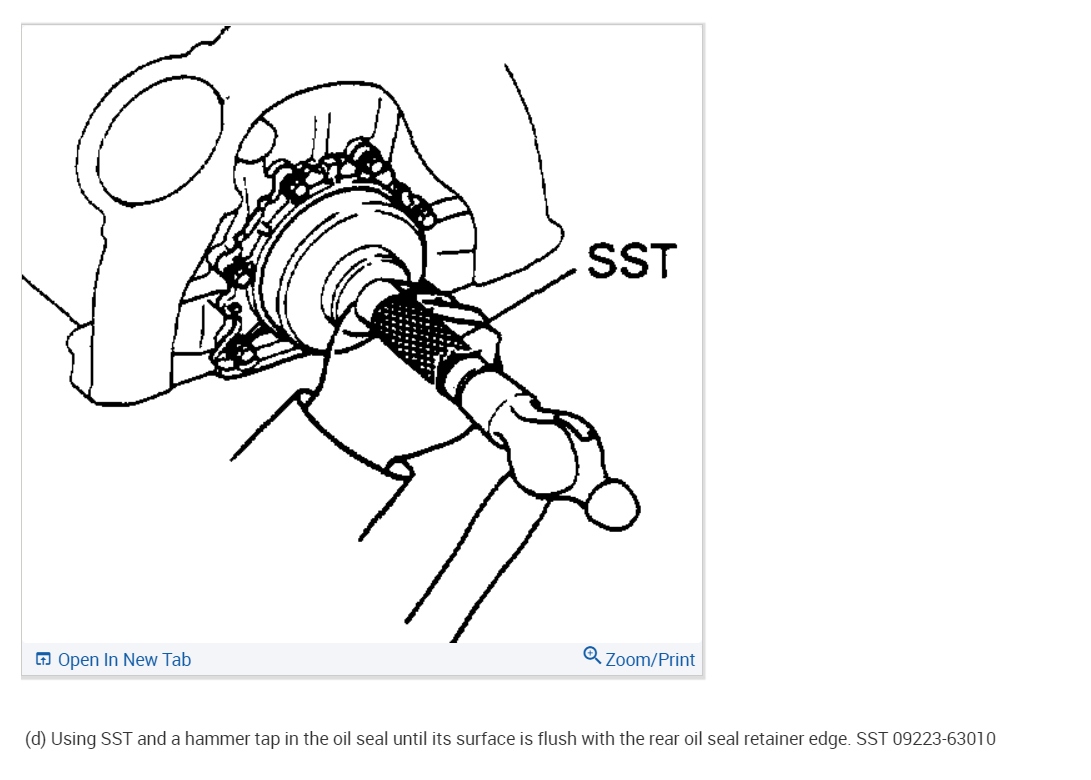

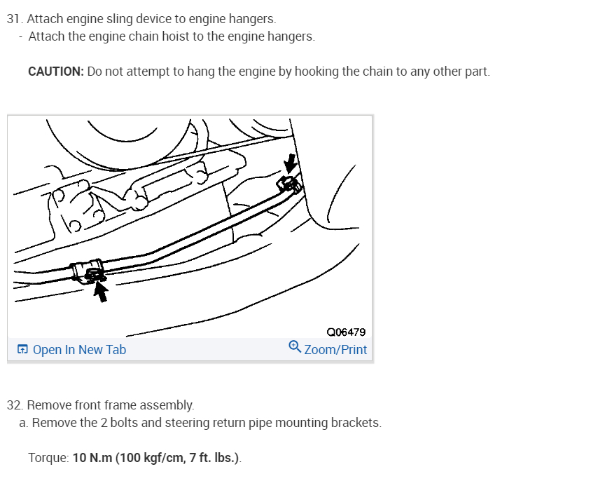

You would have to support the engine and remove the transmission. If you can afford to have the car out of service for a while, you could try it. I just replaced the transmission on a 1991 Corolla and replaced the rear main seal while I was at it. Just a lot of stuff to take off, so it would depend on what equipment/tools you have, and if you run into any problems. Here is a step by step instructions that will show you how to do the job. Check out the images (Below). Please let us know if you need anything else to get the problem fixed.

Suggested Repair
Support the engine and remove the transmission from below, then replace the rear main seal. The job is feasible for a capable weekend mechanic if the car can be out of service and the right tools are available; most of the work is access and disassembly rather than the seal itself.
