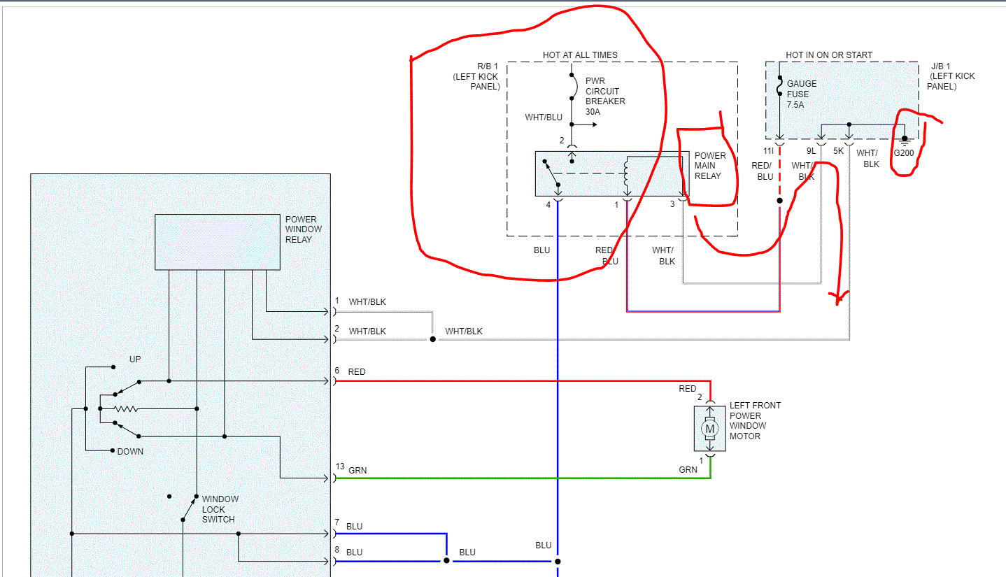

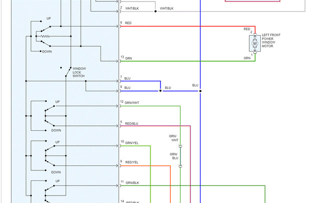

Since I purchased the car the windows and the power locks have not done anything. I don't know where to begin to look. I don't know what to look for. Any advice on this and diagrams whatever could help me. Thank you
Thursday, December 17th, 2020 AT 12:20 PM (Merged)
  • 52,797 POSTS

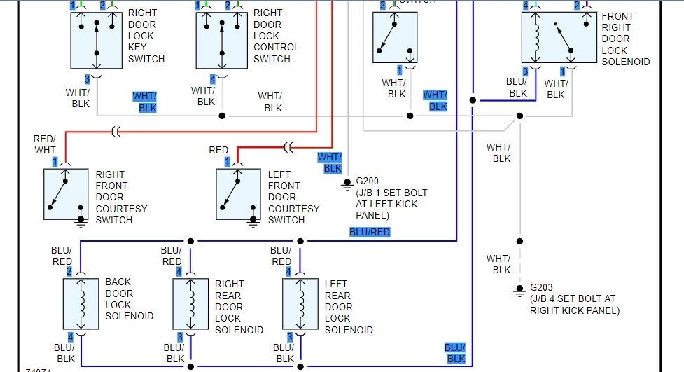

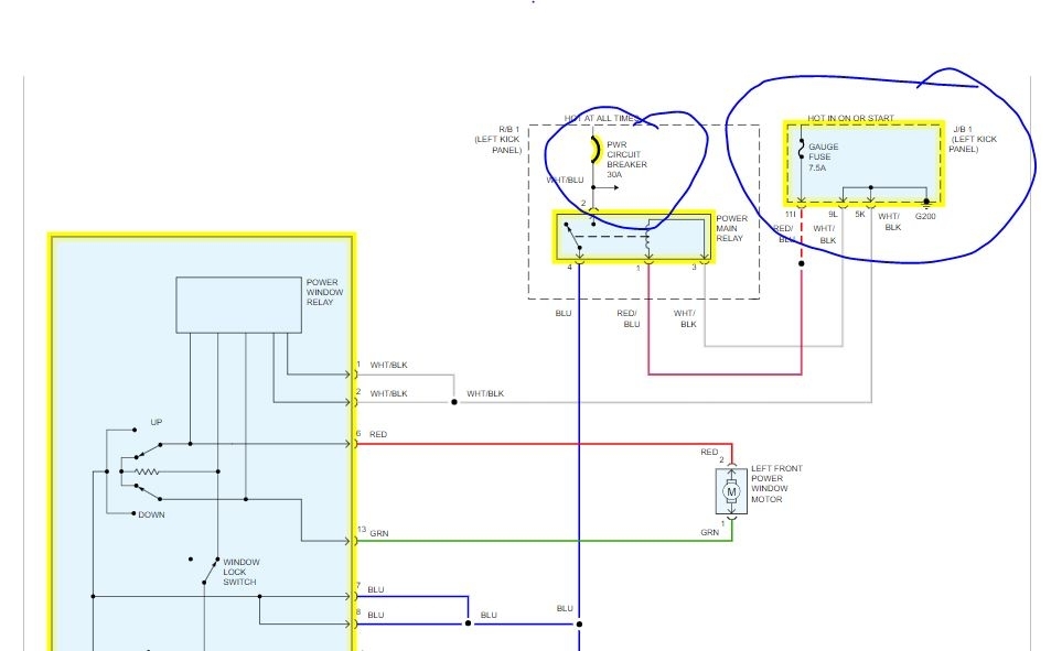

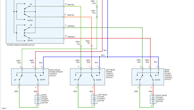

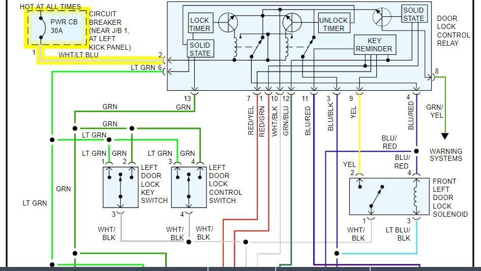

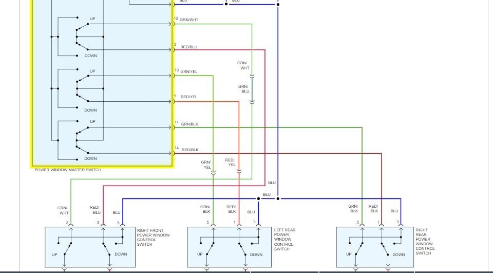

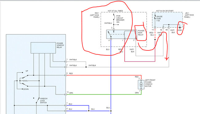

Good morning,
I attached the wiring diagrams for both areas. They are both powered off the same breaker in the fuse block. Verify power on both sides of the circuit breaker with the key in the on position.

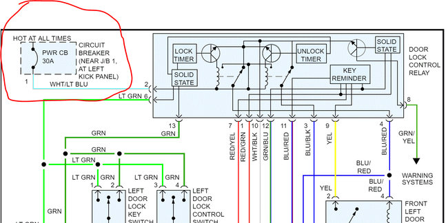

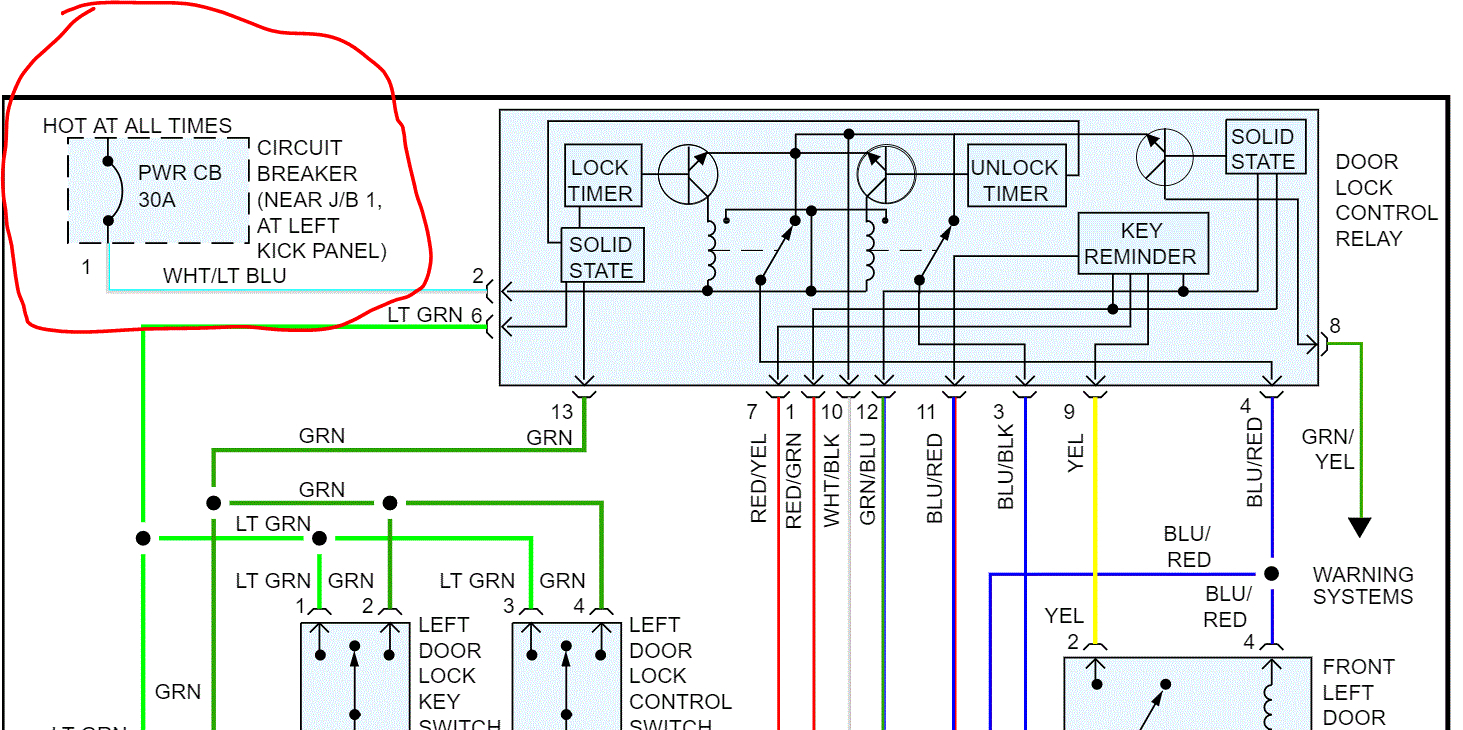

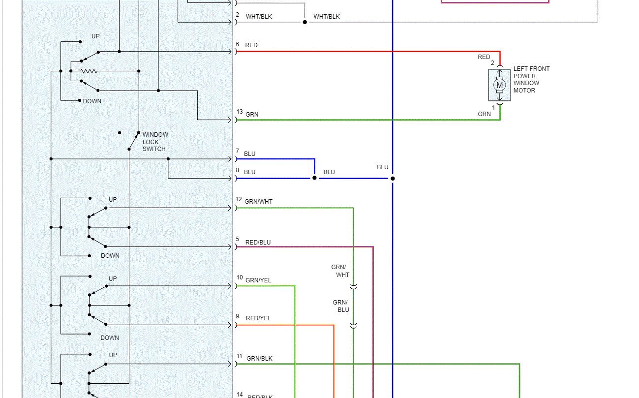

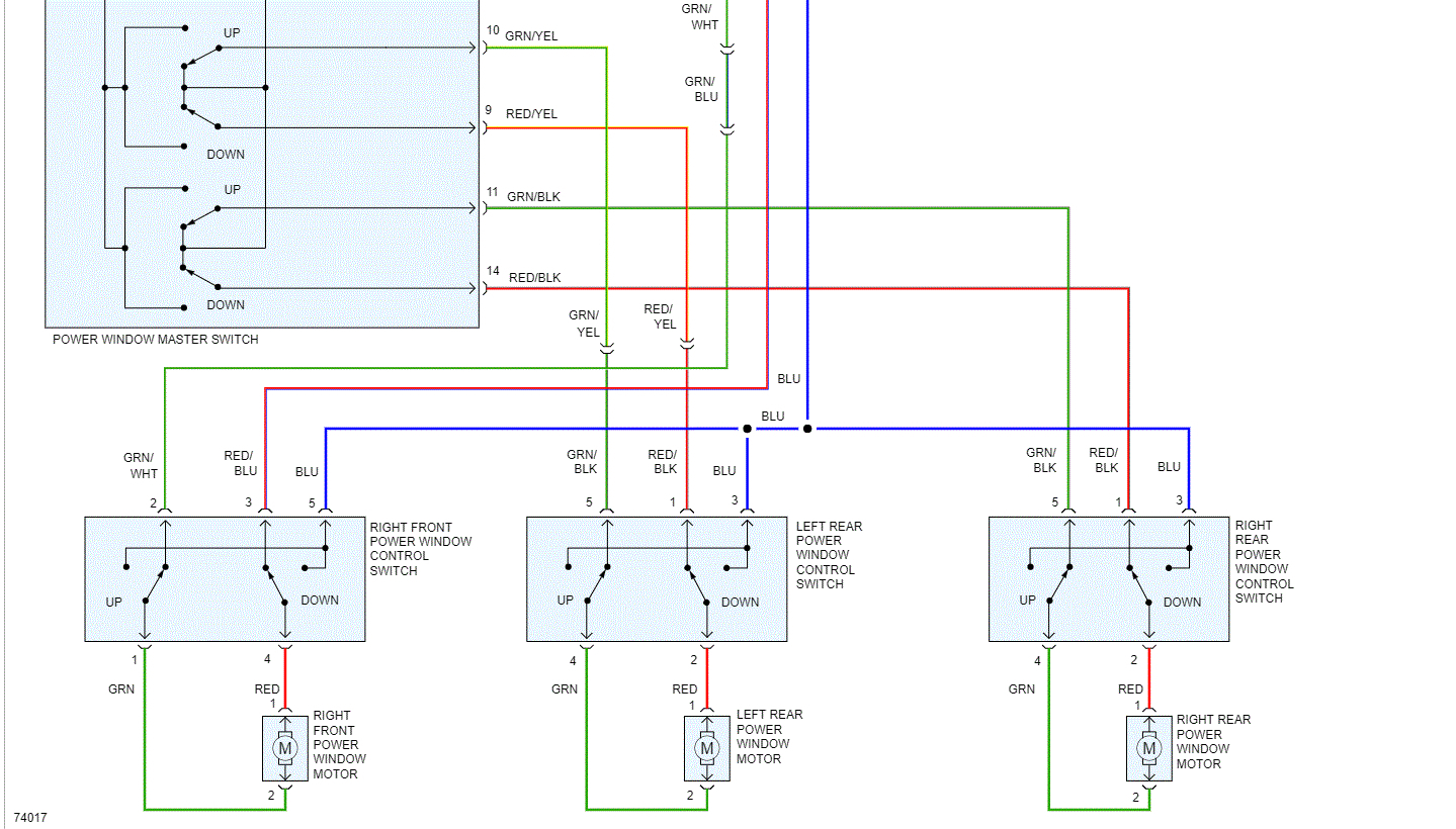

  • 109,885 POSTS
I have attached a few pics below of the wiring schematics. The first three pertain to the windows. Picture 4 shows power for the locks. Since none of them are working, the first thing you need to confirm is there is power from the circuit breakers. For the windows, you need to check for power to the blue wire and the white/black wire. As far as the locks, the white/light blue wire should always have power.
Here are a few links you may find helpful:
If there is power, check to make sure the grounds indicated are good.
