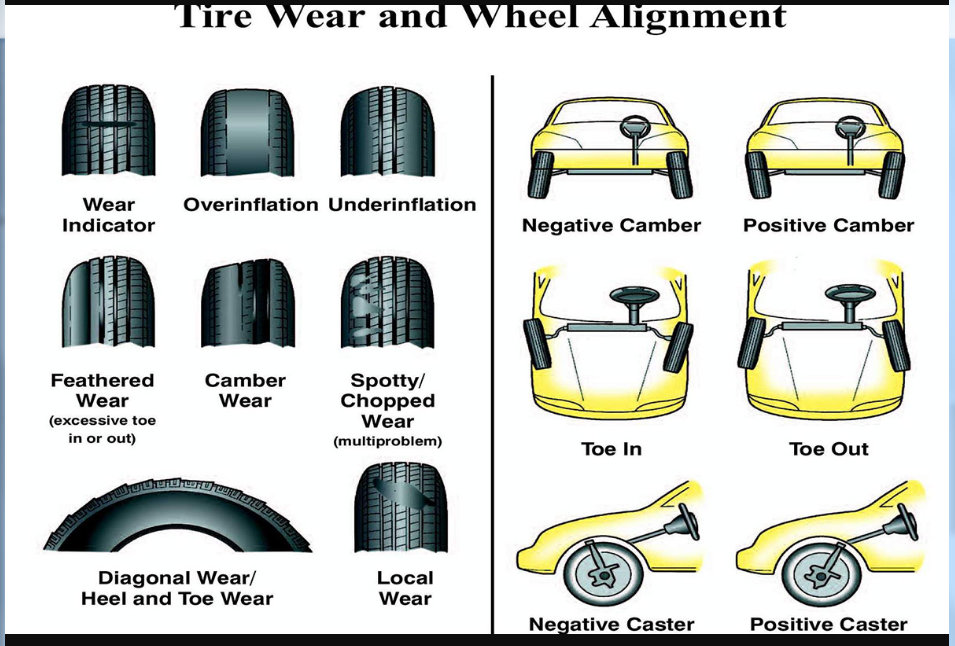

The next thing to do is check for tear wear issues. This guide will help with this, but this will not only point to a tire issue but an alignment issue as well:
https://www.2carpros.com/articles/how-car-tires-work
Please see the chart below for additional info on this.
If this turns nothing up, then we need to simply have the tires balanced.
