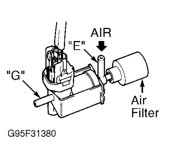

HMAC300
  • 48,601 POSTS
Start and run engine at idle air shold escape form filter in pic. Check resistance of piece with engine off it shold be 33-39 ohms at 68 degrees then check for continuity between each pole and body of valve if there is replace it.
