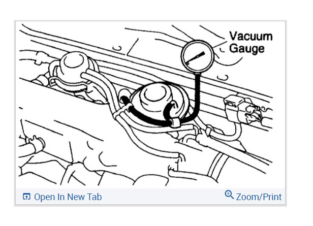

HMAC300
  • 48,601 POSTS
These codes can be caused by a faulty EGR valve here is a video that shows how to test it with the location of the valve in the diagrams below

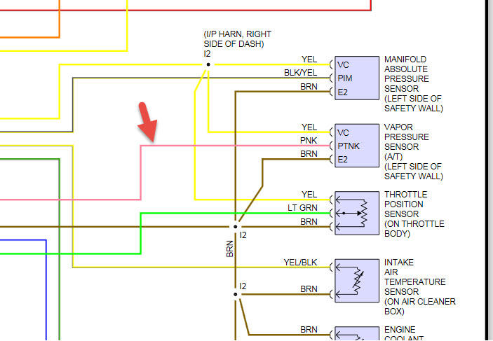

HMAC300
  • 48,601 POSTS
did you check the vsv likit said in second pic and test vacuum through it? is the egr plugged or partially plugged including passageways. it also can be a bad ecm.
Nov 14, 2020 at 2:29 PM (Merged)
JCANTERGIANI
  • 11 POSTS
Yes, I did. All the parts are new Toyota parts anyway. Nothing is plugged up. Is there a way to check using a multimeter to see if the ECU is switching the VSV on/off? I do get 12 volts at one of the terminals on the plug that connects to the VSV. Is the other terminal supposed to get 12 volts at times to "ground side switch" it? I'm not sure how that can be tested. Is there a way to test the ECU first?

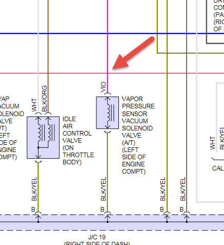

HMAC300
  • 48,601 POSTS
the pink wire on vsv sensor goes to port 7 on pcm so check that for continuity. the other wires tie in to different sensors as you can see in pic. the second pic with violet wire leads to pin 8 on pcm do the same with that. if everything is getting vacuum then I'd have to go with ecm isn't sending power to operate the system which a pro will have to install due to security systems in them. icannot send the wiring diagram as it's to big so if you want to delve further then you can either buy a manual, rent one from here under manuals for your car and I think they allow you for a week as I'm not sure or see if a library has one for it.

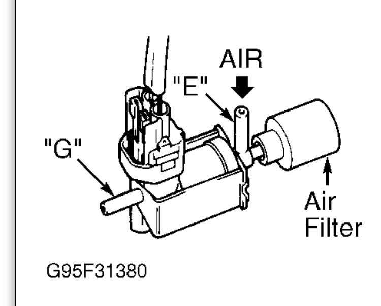

HMAC300
  • 48,601 POSTS
start and run engine at idle air shold escape form filter in pic. check resistance of piece with engine off it shold be 33-39 ohms at 68 degrees then check for continuity between each pole and body of valve if there is replace it.
