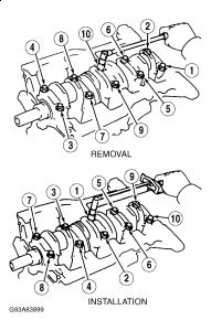

I need the torque specs on the Rod bolts and the main bolts

Connecting rod nuts tighten in 2 steps
step 1 is 18 Foot Lbs.
step 2 is additional 90 degrees
main bearing cap bolt tightens to 43 Foot lbs. using sequence shown below
