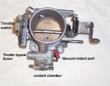

I am having this problem for almost one year:
symptom:
when car is cooling down (means when just start running in the morning or after car rest for few hours and start), it does not have problem described below
It happened when the car is getting warm up (after driving for around half an hour), when I stop the car at the traffic light or stop sign then try to go forward, it always hesitate to start, feel a stuck, has to press pedal hard, feeling like trying to separate two magnet
There is one time, I stop at a right turn corner, my steering wheel is at right turn position, then press pedal, the pedal completely stuck, which means I can not give gas, however, the car can move a little bit, I pull it over the side and stop engine restart car, then it can move again.
it bothers me a lot every day, I tried a mechanic, he open the front lid and put some oil at one place and said it fixed, but it does not at all
if any one experience same problem, please kindly help. Thanks in advance

Throttle plate no good
find a good used one and replace it
or adjust the base idle a pit up as that may help

Thanks a lot for your suggestion, I made some phone calls to different mechanics, each of them told me different way to solve problem, there is one guy also mentioned throttle plate, so i went to his shop, he took off the following parts and did a completely cleaning, now my car is running perfectly
http://www.2carpros.com/forum/automotive_pictures/210299_Throttle2_1.jpg
