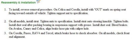

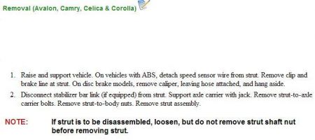

How do you remove and replace struts on a 1998 toyota camry 4 cylinder?

REAR STRUT ASSEMBLY
FRONT STRUT ASSEMBLY

You need a spring compressor to remove it
