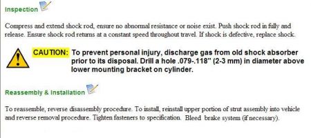

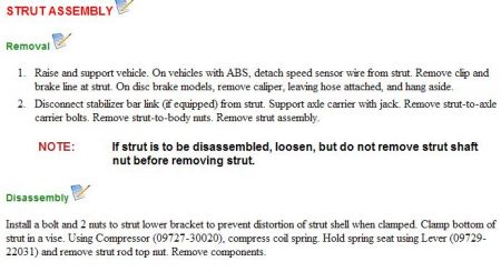

I don't know how to replace rear struts. Please I need help
Friday, September 25th, 2009 AT 1:10 PM
BLUELIGHTNIN6
MECHANIC
16,542 POSTS
Friday, September 25th, 2009 AT 10:49 PM
