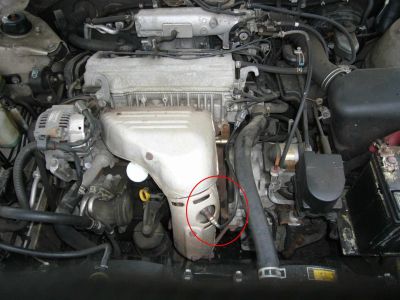

Based on Web information 1997 Toyota Camry LE V6 3 1MZFE has Two(2) O2 sensors (bank 1 Sensor one and two) before Catalyst convertor and One (1) O2 sensor after Catalyst convertor. Would please clarify if I have one or two O2 sensor before Catalyst convertor.
I have replaced new one (BOSCH 13354) before Catalyst convertor (in front of engine under hood) on Bank 1 Sensor 1(I think). The computer has been reset at Auto Parts Store. After resetting computer the engine signal goes away but it reappears next day. I am getting code P0135 "O2 Sensor Heater Circuit Malfunction". Car compuputer has been reset many times at different Auto Parts store but the engine light reappears next day.Would you please shed light why engine signal reappears in day or so even with new O2 sensor and resetting car computer. How I can solve engine light problem
Jul 10, 2008 at 4:48 AM
DOCFIXIT
  • 18,828 POSTS
You did bank two the code is for bank one is in exhaust between the manifold and the bulkhead to pass compart.

Hi, this is my first post here. Here goes my story: I got a 97 Camry LE some time ago. I've been driving it for a while. The mileage is about 100k. About 2 months ago, the dreaded "check engine light" goes on. Being a complete newb about cars, I did some research and decided to get a free code reading from Autozone. then I went to a mechanics and they ended up charging me $40 for figuring out what is wrong with the car: 1. oxygen sensor is bad (or air/fuel sensor) 2. EGR solenoid is bad basically i need to replace these parts. the quote i got from the mechanics is, parts: 1. around 200 2. around 100 labor: about 200 total so I'll pay about $500 being a poor college student ($500 is approximately the salary I get per semester for my part time job at my university!) I decided to do some more research. from this website http://replacement.car-stuff.com/parts/carstuff/quote.jsp?year=1997&product=C5015-131191&application=000590057&part=Air%20Fuel%20Ratio%20Sensor&category=C&returnurl=null&dp=true&showdc=true#top it seems that the O2 sensor is indeed $200 however, some friend told me that O2 sensor is usually around $60... I decided to replace the oxygen sensor by myself. (I've learnt how to replace spark plugs as a total newb) As for the EGR valve... I am told that I would need to lift the car up to replace it. Being a total newb, I'll leave this part for last after I am done with oxygen sensor. my personal philosophy: the decision of attempting to fix the car on my own is partly because of money and partly because of my personal philosophy. I believe in doing things on my own and learning from the experience. I would gladly spend $500 bucks and time trying to fix the car myself as long as I learn.
https://images.2carpros.com/forum/automotive_pictures/94178_car_1.jpg
I apologize for any newbish questions or spelling errors. Thank you for reading my long post. Any comment is appreciated.

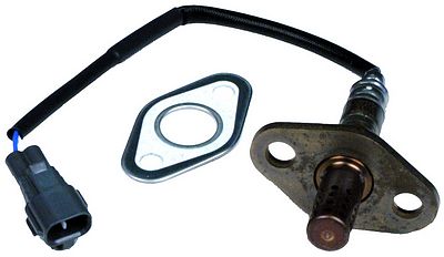

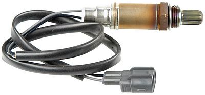

Go to your local parts store and ask them for Bosch 12109 for the front
https://images.2carpros.com/forum/automotive_pictures/55316_12109_1.jpg
and Bosch 12105 for the rear.
https://images.2carpros.com/forum/automotive_pictures/55316_12105_1.jpg
You don't have to have to use Toyota parts for your vehicle, aftermarket units works just as fine. The guy just just didn't want to take them back. Or you can try this website. rockauto.com
