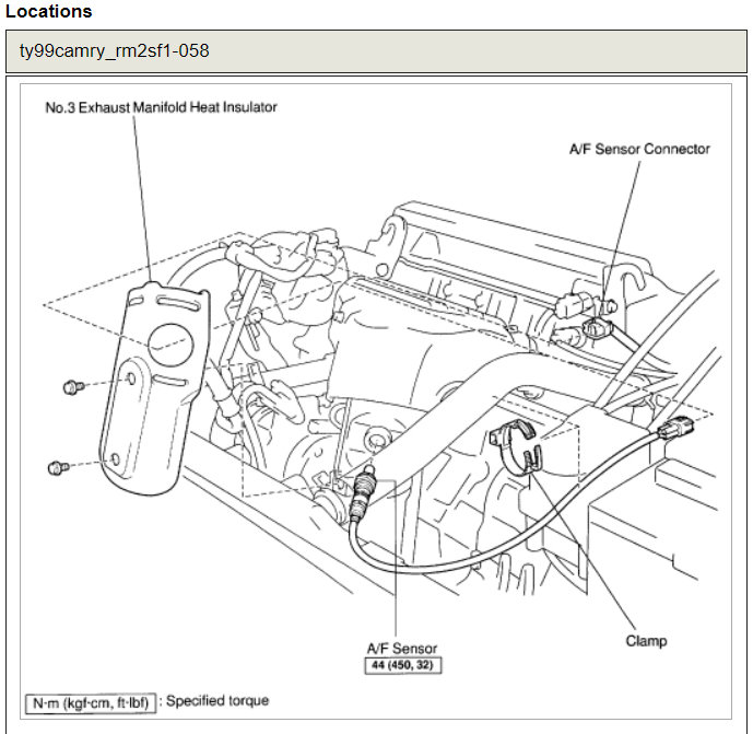

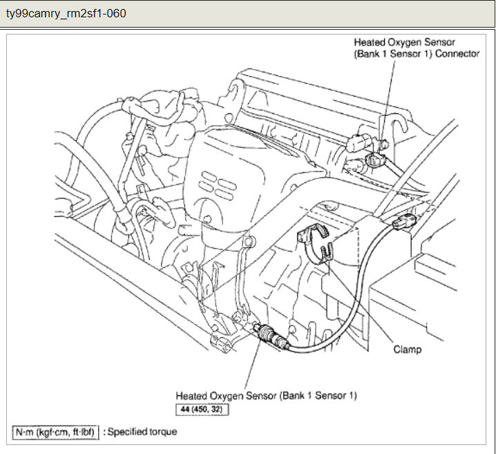

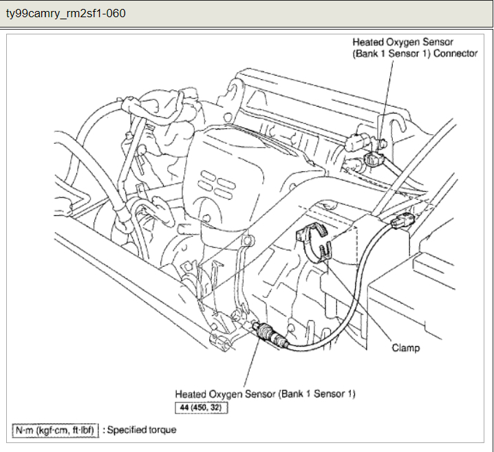

How do i replace the downstream oxygen sensor?
Jul 13, 2009 at 1:37 PM
STEVEW84
  • 673 POSTS
You may need to raise the car up first safely. Here is guide that will help you with that.
Here is a guide to show you what you are in for when doing the job.
https://www.2carpros.com/articles/how-to-replace-an-oxygen-sensor
Here are diagrams to show you the locations on your car so you can get the job done.
Cheers
