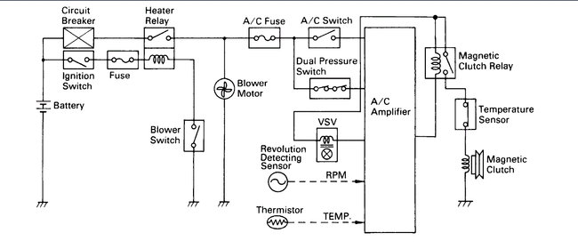

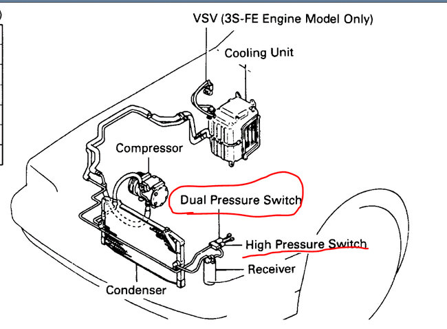

I am not getting any pressure on my gauges which tells me that I do not believe the air conditioner compressor coming on. Could you show me the electrical part of it the pressure switches? Any necessary information relays, fuses? I really appreciate you in this matter.
Friday, November 27th, 2020 AT 8:51 AM (Merged)
  • 109,885 POSTS
With the engine off, you should still see pressure. It's called static pressure. If there is nothing, the system has no charge, most likely the result of a leak.
Let me know if that is the case. I have sensor info, but doubt that is the issue.
Here is a link that explains what to check when the A/C isn't working:
Let me know exactly what is happening and what you have already done and found.
TIMOTHY J RADA
  • 21 POSTS
Yes Joe, I do have static pressure with the engine off and everything off it's reading kind of low, but it do have a reading on it so I do believe it's not the high pressure switch I can rule it out and I think it might be the low pressure switch or for some reason the compressor is not engaging cycling cycling on and off.
Friday, November 27th, 2020 AT 8:52 AM (Merged)
  • 109,885 POSTS
I attached two pictures related to the switch. Take a look. The third pic explains minimum and max pressures.
What is the static pressure? Also, what is the temperature where you are located?
