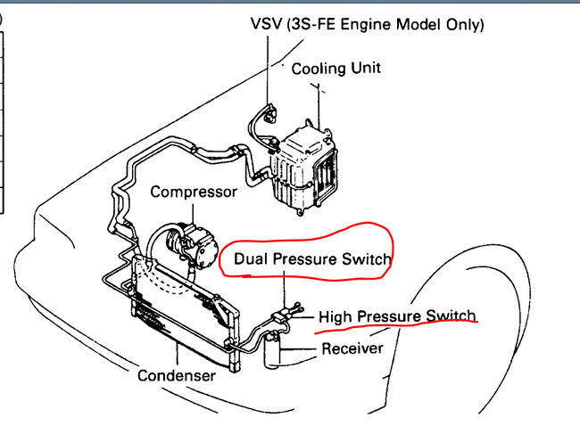

KHLOW2008
  • 41,814 POSTS
Hi Stan,
When the AC stops cooling, is the compressor working?
Are the radiator and condenser fans working?
You might need to check the thermistor.
Friday, November 27th, 2020 AT 8:50 AM (Merged)

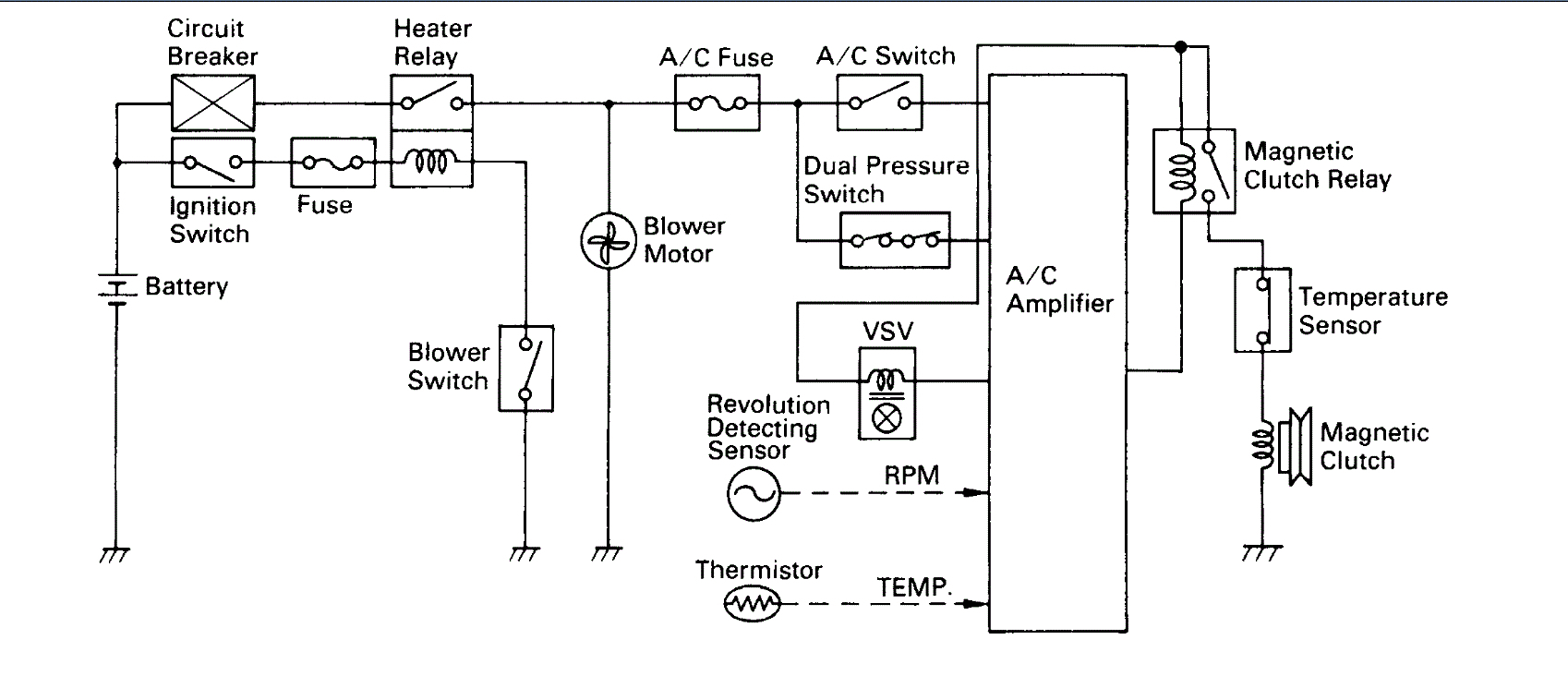

SIDNEYTHECAT
Sorry for taking so long to reply to your advice.
The only thing I haven't been able to check is the thermistor. Can you tell me where the plug connector for it is located?
I wanted to disconnect it and measure the resistance, while the a/c is running. I can put a resistor across the connection on the engine side so the a/c will continue to run.
Thanks,
Stan
KHLOW2008
  • 41,814 POSTS
Hi Stan,
The thermistor coupler is somewhere between the evaporator and radio panel, behind the glove box.
Are you able to control the temp setting and does it work with a higher setting, ie above 20 degrees?
