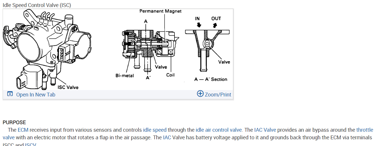

Very hard to start when cold, easily starts when warm

When was the last major tune-up?
Try having the coolant temperature and throttle position sensor and idle air control valve.

This is common when the IAC motor needs to be serviced or replaced, here is the location so you can fix it. This video will help as well
https://youtu.be/XMB16Gg-qNg?si=vGAi0H4Kgqfla-1K
Image (Click to make bigger)
