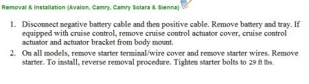

That sounds like your starter. Get a DVOM and test voltage at the starter. Have an assistant crank and check voltage at the starter connection. If you get 12V, but the starter doesn't crank, your starter is bad.

NIKITHEBOSS
  • 7 POSTS
I had the charging system and alternator tested at Autozone - it was working fine. As far as the starter goes, I was told that I'll have to remove the starter and bring it to Autozone for them to test it. I'll try to do that sometime this week - hopefully I should be able to do it using the Toyota Camry Repair Manual.
Thursday, May 23rd, 2019 AT 6:52 PM (Merged)
ZACKMAN
  • 4,202 POSTS
https://www.2carpros.com/forum/automotive_pictures/55316_99camrystarter_1.jpg
NIKITHEBOSS
  • 7 POSTS
I took it to firestone - they tested it. Initially, the mechanic didn't find anything wrong. He gave me a clean chit for the starter - saying that it was most probably the fuel injection system that needed cleaning (havn't done that for almost 70k miles now). However, after we were done discussing what was involved in the fuel injection clean up, fuel filter replacement and stuff, when he tried to start the car to pull it out of the shop, he couldn't do so - and diagnosed it as the starter - based on the clicks that he heard. I've given the camry to the firestone to get it replaced - will be getting it back later today.
