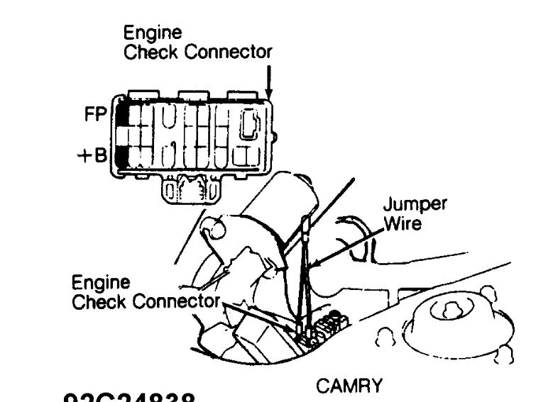

HMAC300
  • 48,601 POSTS
From your description does itnot turn over or does it just quit running? Have your battery checked first auto parts do it for free. Check fuel pressure it should be 38-44 psi. To check place a j;umper wire between engine check terminals B+ to FP. Then get the hose replaced that goes to throttle body from air cleaner as that may be the real culprit here.
