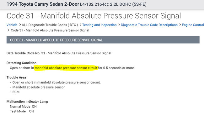

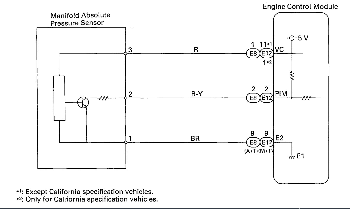

SPIDR8U

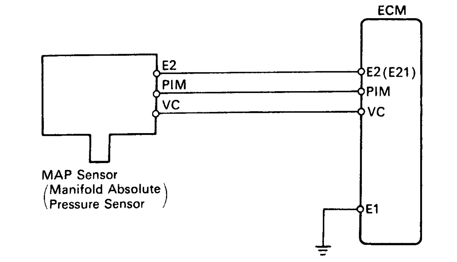

I smell fuel sometimes and I jumped a wire to get my codes and I got a 31. The check engine light is not on as if there were a problem. This happened six months ago and if I got it started and pushed on the gas it would barely run. Then I would start it again and it would drive fine for twenty feet and then if I have it gas it would die and not start at all. I could let it set for sometimes an hour or a month and then one day it would start and run fine for several months. A few weeks ago it started doing this again. I would crank it several times and then finally it would start and maybe run a little rough for a few seconds but then be fine. It would do this once a week for a couple weeks and then it started occurring several times last week. It sat for two days before it would start and then acted fine driving until I started to slow down to stop and it started shaking and shuddering and I tried giving it gas to keep it running but it still shut off. I cranked it over a couple times and then it started and I drove a half mile and it shut off again while I was slowing down to turn. It shut off and I can’t get it to start at all now after several days. I replaced the MAP sensor but still just cranks with no start. What should I do?
Feb 22, 2021 at 2:15 AM (Merged)
SCGRANTURISMO
  • 4,897 POSTS
The Direct Trouble Code (DTC) 31 for your vehicle is a DTC for the Manifold Absolute Pressure sensor (MAP) or the MAP sensor circuit, which will have an open (a break in the electrical path) so that your Power-train Control Module (PCM) is not reading the sensor. In the diagrams down below I have sent you not only the DTC description, but the circuit wiring diagrams and instructions for how to find an open in an electrical circuit for you. It will require you to use a multi-meter. so here is a link below for you if you are unfamiliar with how to use one:
Please go through these guides and get back to us with what you are able to find out.

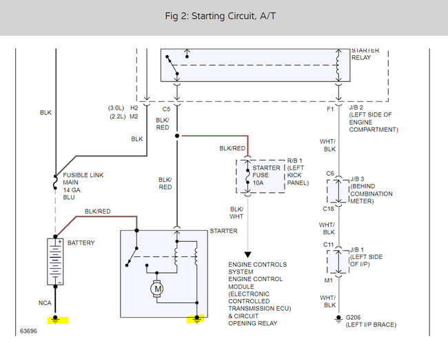

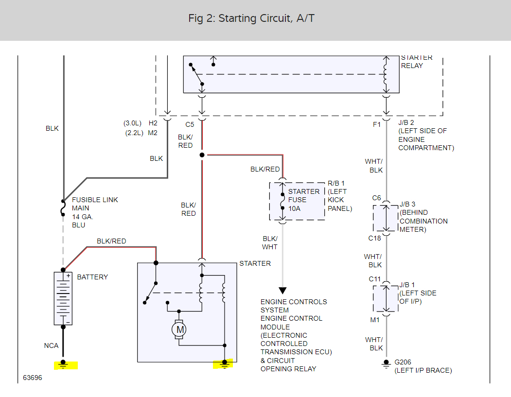

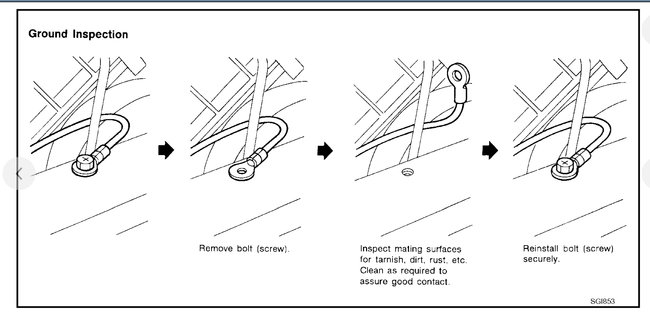

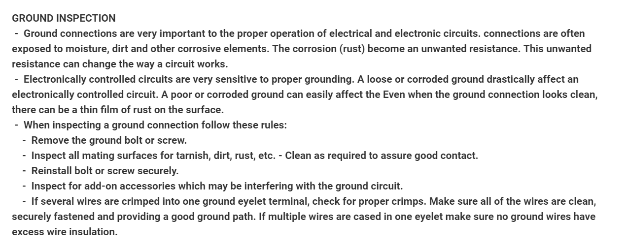

SPIDR8U
I try starting my car and it will crank but won’t start. After I try starting it a few times it will start. This doesn’t always happen, only randomly. Last week it started and then shut off after I turned on the A/C right away it shut off . I tried starting it and it only would crank not turn over and white smoke came from under the hood. I let it set about fifteen minutes and then it started right up and drove fine. Since then it would not start a few random times but after cranking it over a few times it started and was fine. Today it wouldn’t start again. Tried several times and then white smoke under the hood again. Still won’t start.
Feb 22, 2021 at 2:16 AM (Merged)
SCGRANTURISMO
  • 4,897 POSTS

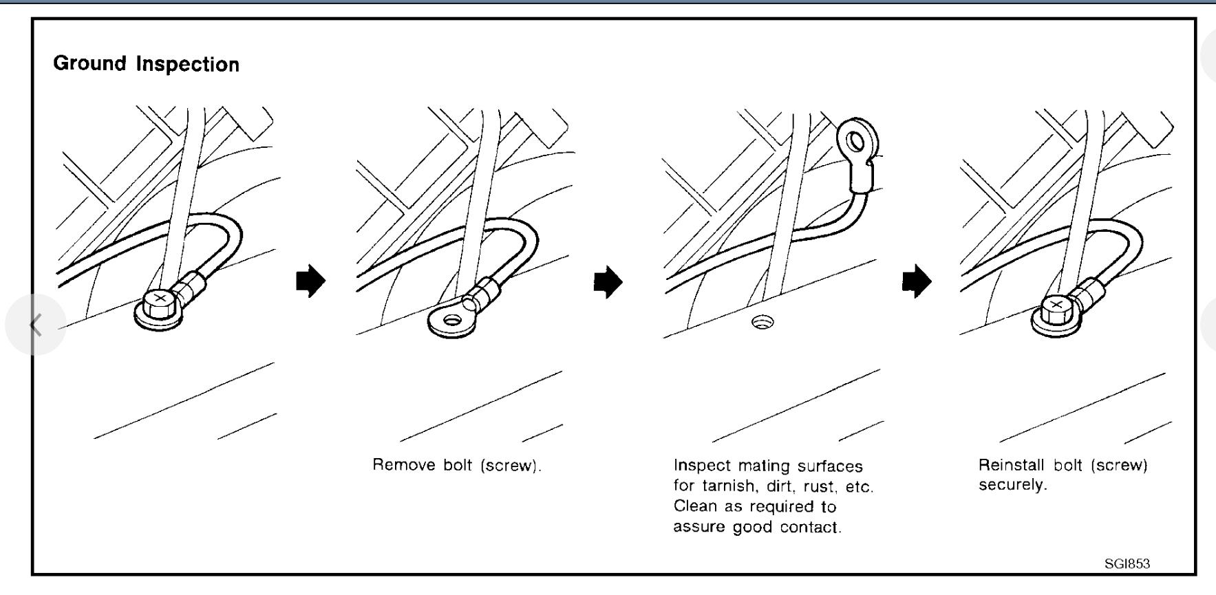

This could be a couple of things, it could be a bad wire, like maybe the ground wire from the starter back to the battery being loose or having a lot of resistance to it causing an electrical backup and smoking a wire, or it could be a bearing on a component the the serpentine belt drives that is failing and starting to freeze up causing the smoke. In the diagrams down below I have included a wiring diagram of your vehicle's starting circuit. Please check the grounds to the battery and make sure that they are clean, tight, corrosion free, and making good metal to metal contact and then please, get back to us with what you are able to find out. We can go from there.
Thanks,
Alex
2CarPros

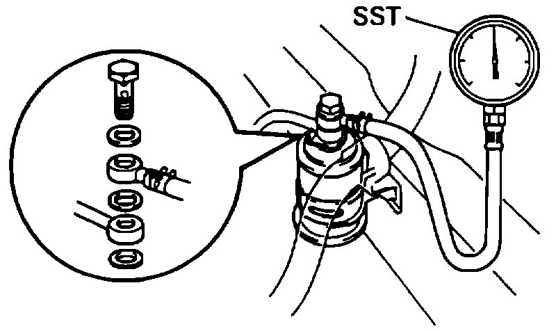

JOY BLACK
I was driving and came to an incline and halfway up it lost power and never regained it. then it started sounding like a hissing sound almost like a hose was off but can't find one missing and when I made it to a friends driveway close by soon as i turned in it quit running on me. The car will crank back but when you give it gas it spits and sputters and cuts off..
Feb 22, 2021 at 2:28 AM (Merged)

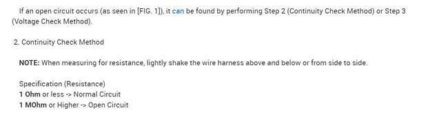

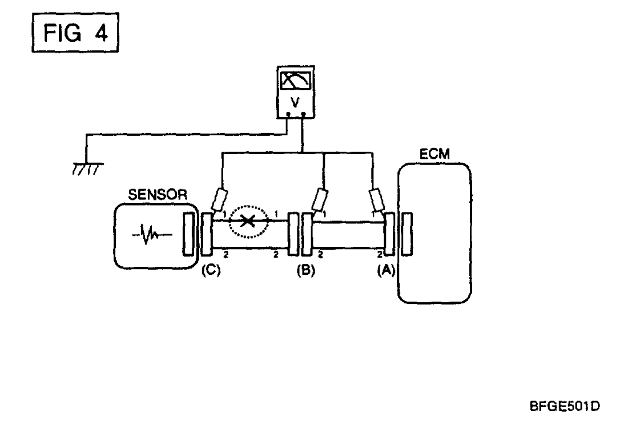

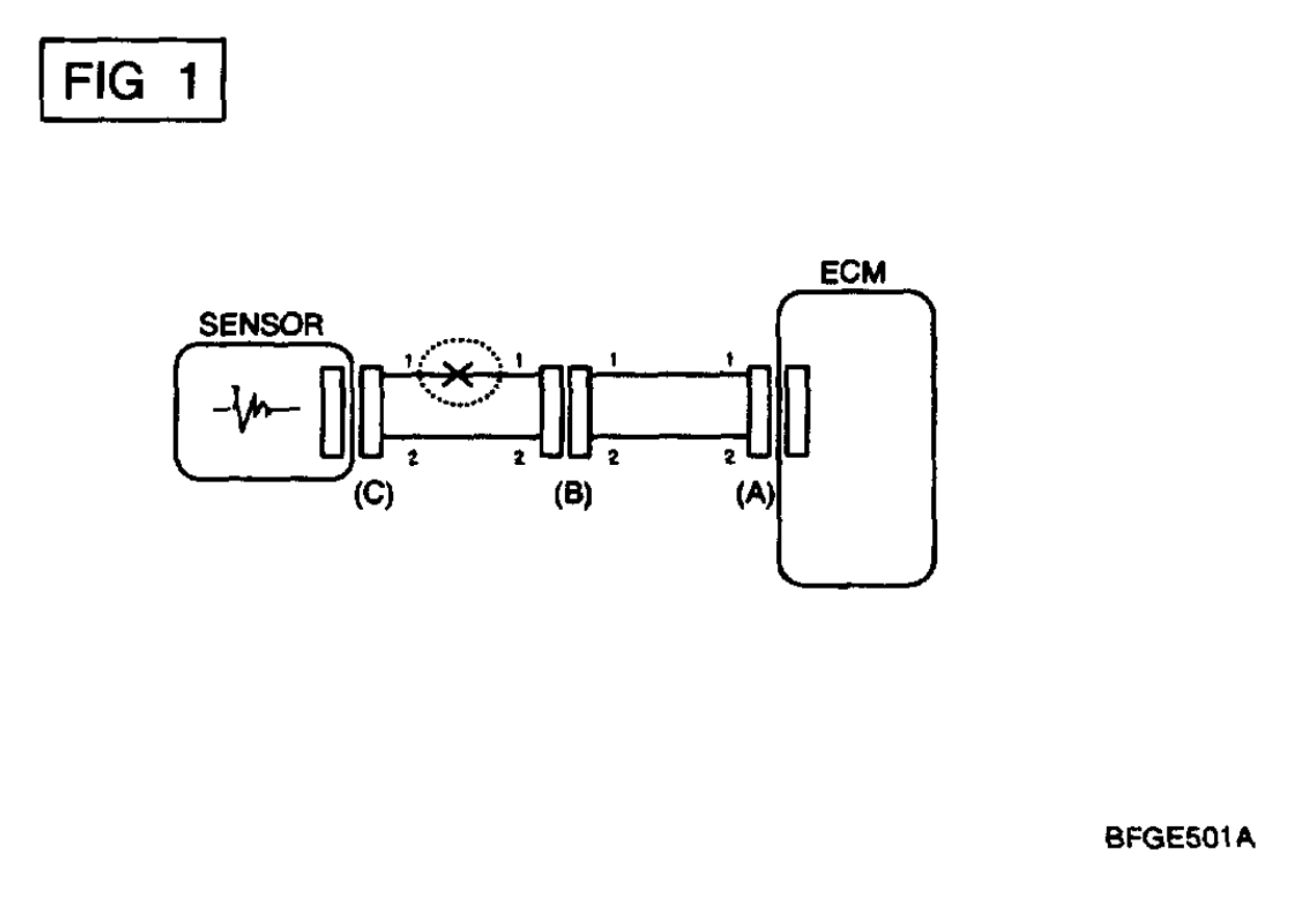

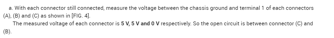

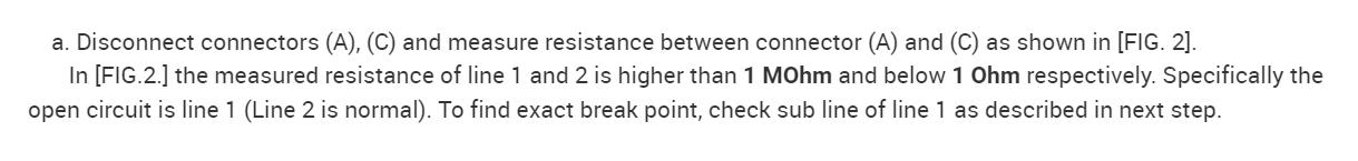

  • 110,248 POSTS
Many things can cause this. However, based on your description, the first thing I would check is fuel pump pressure. If it is weak, this can be the result.
Here is a link that shows in general how this is done:
Here are the directions specific to your vehicle. The attached pictures correlate with these directions and the manufacturer's specs are included.

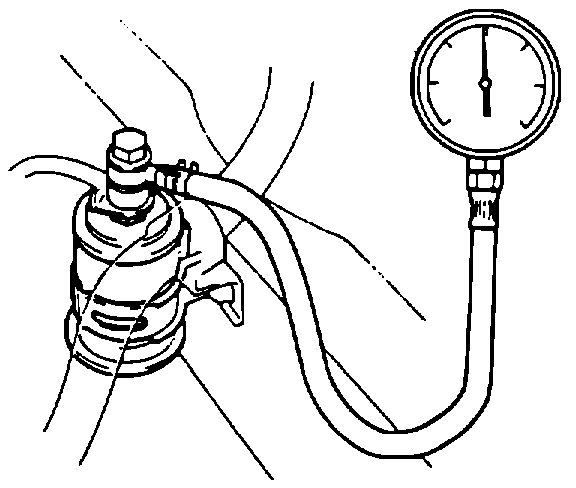

FUEL PRESSURE TEST
Pressure Gauge Connection
Picture 1
- Check that the battery voltages is above 12 volts.
- Disconnect the cable from the negative (-) terminal of the battery.
CAUTION: With Airbag, work must be started after approx. 30 seconds or longer from the time the ignition switch is turned to the LOCK position and the negative (-) terminal cable is disconnected from the battery.
- Put a suitable container or shop towel under the fuel filter.
- Remove the union bolt and two gaskets, and disconnect the fuel in let hose from the fuel filter outlet.
- Install the fuel inlet hose and pressure gauge to the fuel filter outlet with three new gaskets and the union bolt.
Torque: 29 N.m (300 kgf.cm, 22 ft.lbs)
- Wipe off any splattered gasoline.
- Reconnect the battery negative (-) cable.

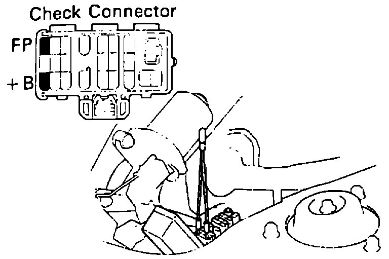

Installing Jumper Wire
Picture 2
- Using a jumper wire, connect terminals +B and FP of the check connector.
- Turn the ignition switch ON.
Reading Pressure Gauge
Picture 3
- Measure the fuel pressure.
Fuel pressure:
265-304 kPa (2.7-3.1 kgf/cm2, 38-44 psi)

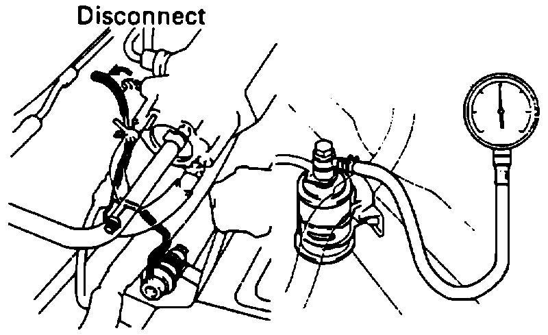

Checking Fuel Pressure - No Vacuum To Regulator
Picture 4
- Disconnect the vacuum sensing hose from the air intake chamber and plug the air intake chamber outlet.
- Measure the fuel pressure at idling.
Fuel pressure:

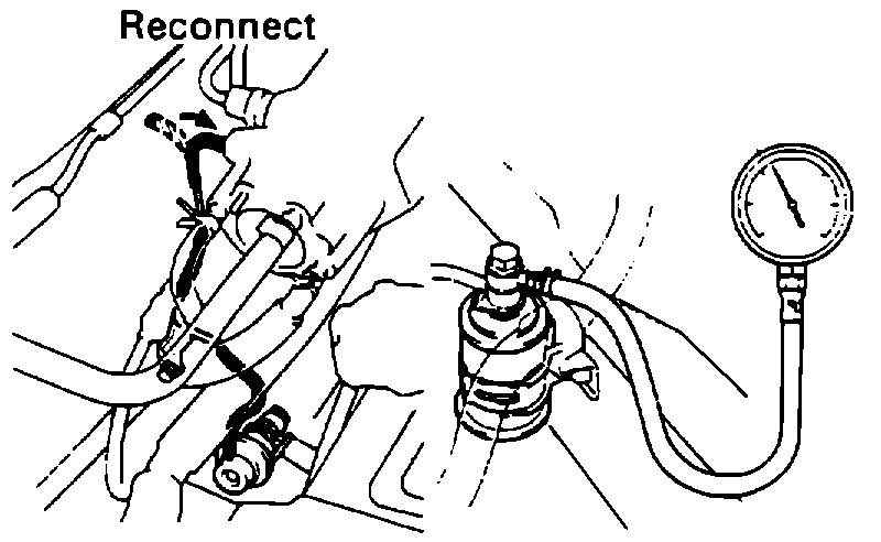

Checking Fuel Pressure - Vacuum To Regulator
Picture 5
- Reconnect the vacuum sensing hose to the air intake chamber.
Fuel pressure:
206-255 kPa (2.1-2.6 kgf/cm2, 31-37 psi)
- If pressure is not as specified, check the vacuum sensing hose and fuel pressure regulator.
