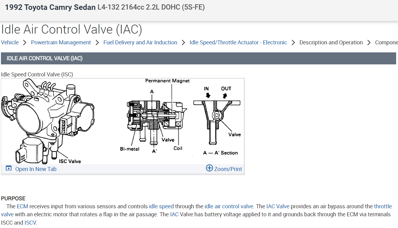

I drive my car to school and it is fine starting up. I let my car sit for a couple of hours and then go to start it. It idles funny and then acts like it wants to stall. I drive it, then at each stop light it wants to stall and kinda shakes and wants to stall this happens for five minutes of driving then is fine. It does not happen anymore throughout the day untill the next day same situation. Could there be air in the line?

Have the coolant temperature sensor and the idle air control valve check. If not it come on back.

Yep, the idle air control valve should be serviced along with the throttle ore, these guides can help fix it and I included how to do the work on your car as well.
https://youtu.be/XMB16Gg-qNg?si=2uDoLCpVI07O4FJL
and
Check out the images (below). Let us know what you find.
