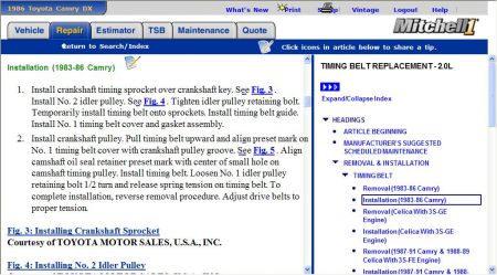

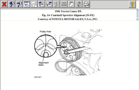

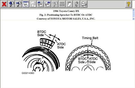

I need to know where the points are for the head and the block, and do I need to take off the lower pulley to take off the belt cover?
Tuesday, March 25th, 2008 AT 5:50 PM
  • 75,992 POSTS
See below
https://www.2carpros.com/forum/automotive_pictures/12900_t1_1.jpg
https://www.2carpros.com/forum/automotive_pictures/12900_t2_1.jpg
https://www.2carpros.com/forum/automotive_pictures/12900_t3_1.jpg
https://www.2carpros.com/forum/automotive_pictures/12900_t4_1.jpg
https://www.2carpros.com/forum/automotive_pictures/12900_t5_1.jpg
It took me nearly 23 mins to get this data -Today must be your lucky day from me. Good Luck
