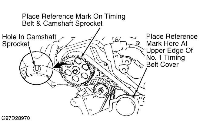

My old man has been trying to replace our timing belt. And he almost had it timed everything was turning, he went to bed got up went back to it and now the crank is hitting the rod cap bolts. How do I fix it and why did it do this when it was completely fine the first fifty times he tried?
Friday, June 30th, 2017 AT 4:22 AM
14 Replies
MHPAUTOS
  • 31,937 POSTS
There is a small hole in the cam gear that will align with a mark on the timing cove, this it the cam alignment mark. The crank gear has a notch and alignment mark at TDC, align both these. See picture for cam position information.

He knows that, he is trying to hand turn the pulley and it is hitting the rod bolts keeping it from turning a full 360 degree rotation. The valves are fine.

OK this is what happened, the motor mount on the top right is bad and he had removed the jack from under neith and when he did that made the motor shift by a hair now making the rod cap hit side of the block. That's what caused it
