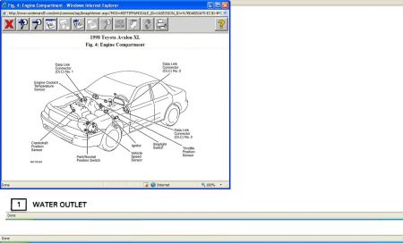

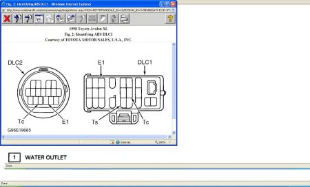

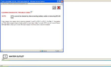

how do you clear abs codes on my 98 toyota avalon.

There you go the connector's you need are behind the left side of the dash. It sounds like you may have a wheel speed sensor that is out. These videos will help us find the problem. https://youtu.be/rTtAnsOlZU4 and https://youtu.be/Pb6nXV-iamI and https://youtu.be/ANWVTh2RQoQ and https://www.2carpros.com/articles/abs-warning-light-on-easy-repair-guide Please run down these guides and report back.
