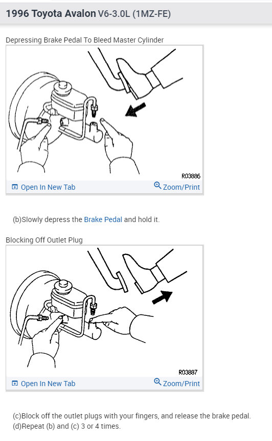

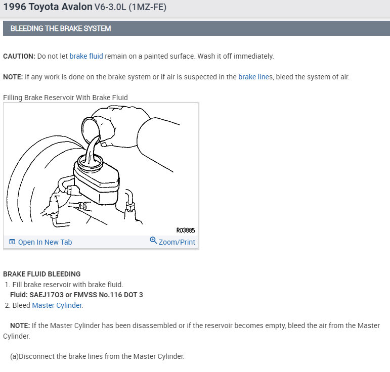

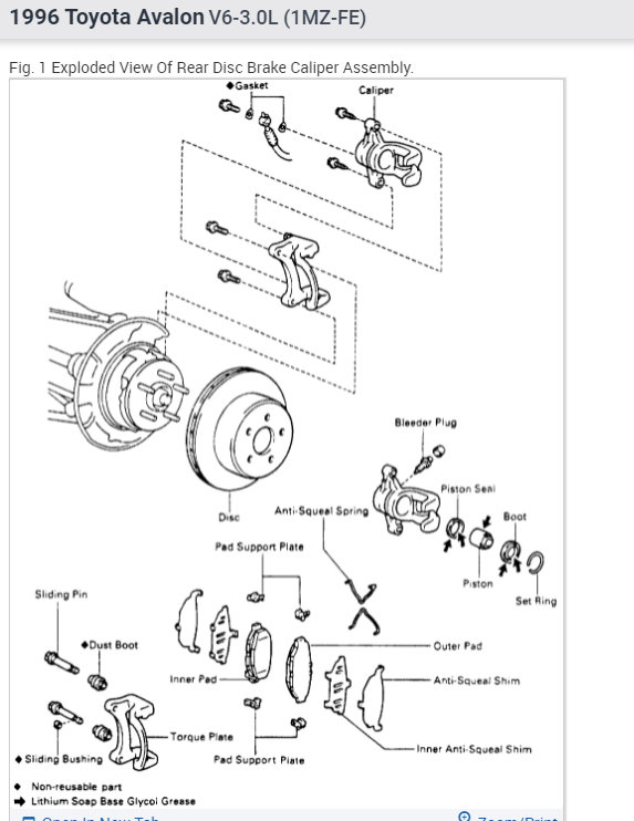

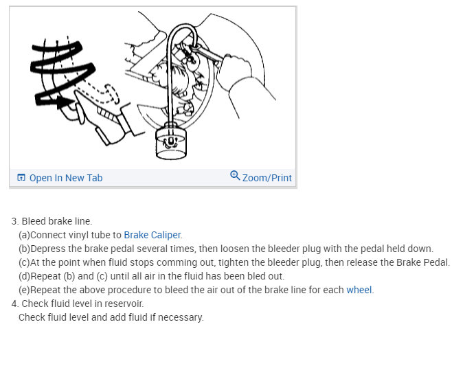

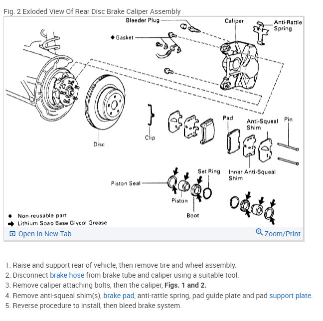

How do you properly bleed a brake system for a 1996 toyota avalon xl? How do you install new rear calibers?

We have a very helpful video that shows the proper step by step procedure of brake bleeding. It is important to follow the steps in the correct order to correctly bleed the brake system.

The rear calipers can be changed easily with using standard hand tools.
And of course, the brakes need to be bled after any caliper replacement.
https://www.2carpros.com/articles/brake-caliper-replacement
I have attached brake bleeding instructions and caliper diagrams for your reference.
