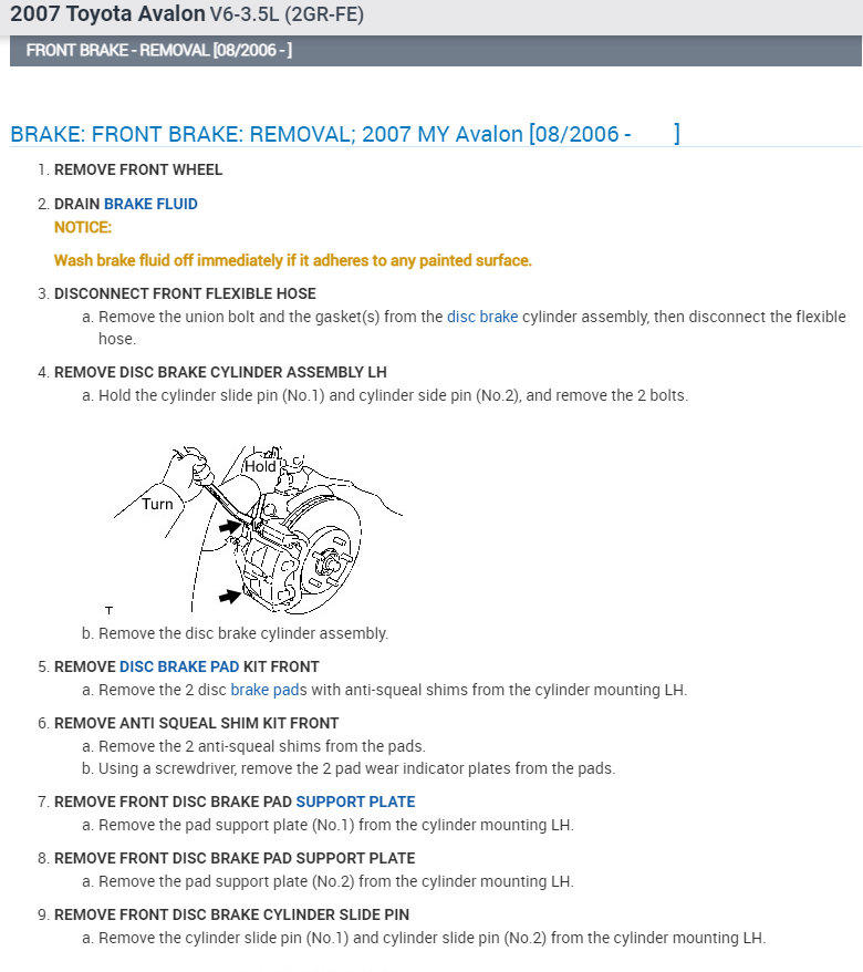

I cannot seem to get the front rotors off the car
2007 TOYOTA AVALON
MIKEMN
I cannot seem to get the front rotors off the car. Any tricks involved? I have removed the calipers no problem but cant seem to get the rotors to budge.
Jul 9, 2009 at 12:07 PM
SQM
  • 6,383 POSTS
Be sure to remove those two screws at the center of the rotor. After the caliper is out of the way there is nothing else that holds the rotor in place.
It is likely just seized on the hub.
Simply use a mallet or hammer to tap on the rotor to release it from the hub.
