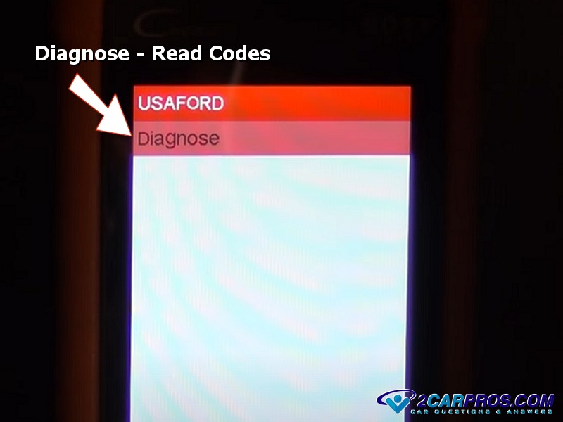

2. Turn the ignition system on to power up the scanner, this will  bring up the first prompt screen with you will be required to input information about the car. Some high end scanners will self detected the car so this step can be skipped.
scanner choose manufacturer
3. Once the scanner information had been inputted you can initialize the ABS and Traction scan code scan, this can take a few moments.
initializing ABS and traction control diagnostic scan
