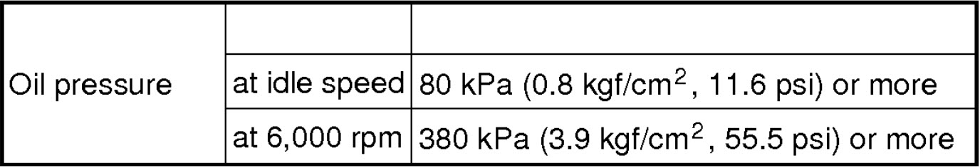

I would check the oil pressure, possibly leaving the gauge attached then go on a drive to try and duplicate it. Maybe there is an oil pressure drop due to a partial blockage at the oil pickup screen, anything is possible and I've seen some crazy stuff in my 27 years of turning a wrench.
Apr 13, 2020 at 2:50 PM
Great point. If it is that infrequent then I suspect there is something floating around the oil. If nothing else drop the oil pan and see if there is something there that can block the pick up tube. You will know this by verifying oil pressure is low as bmdouble says when the issue is happening.
