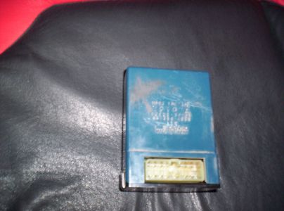

4runner 1990, 4W SRS5 171000 mileage motor 3.0, my door control switch dont work, and all individual control from each door dont work, i check all fuses and all fuses is in good condition, i chek the electrical power in the driver door and i dont have voltaje in the connector, then i plug out and plug in the device that say "door control", and dont work, what can i do to resolve this problem. i need to check another device like relay or switch break.[img:a96cb16787]http://www.2carpros.com/forum/automotive_pictures/70934_100_1893_1.jpg[/img:a96cb16787]

I would check the 20amp door lock circuit breaker and then report to the door lock control relay-you find these items your home sweet home-sorry don't know the location, BTDT on a different Toy.
Check the 20amp door lock CB first that's the one that powers the door control relay before it gets to t he M/S.
