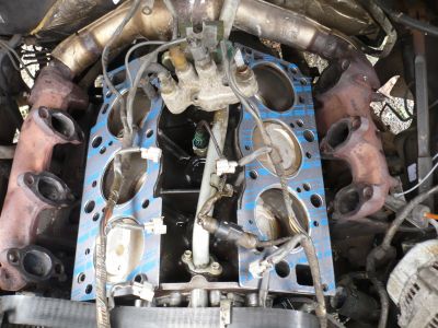

1989 Toyota 4Runner 6 cyl Four Wheel Drive Automatic 160 Th miles
This engine before I changed bad Head Gaskets, and Installed new Fuel Injectors. Problem is Engine will not start. I marked all Elect. connections and hoses.
1 - The injector resistance tests ok 13.7 Ohms.
2- Test circuit with noid light- test ok.
3 - I can hear injectors clicking while engine is being turned over.
Engine will fire, I believe off of the cold start injector and then DIE. QAny help will be Greatly Appreciated.

Check the valve and ignition timing if its correct and also check the fuel pressure if its within specs.

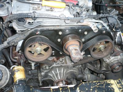

Timing seems to be right on , engine will fire up , and then die right out. Ill have to buy a fuel pressure tester. Why would fuel pressure be in question when engine ran before beinging repaired?

Check it so that we can take it out of the equation and concentrate on other areas of concern. Or do this direct battery voltage to the fuel pump and see what happens.
