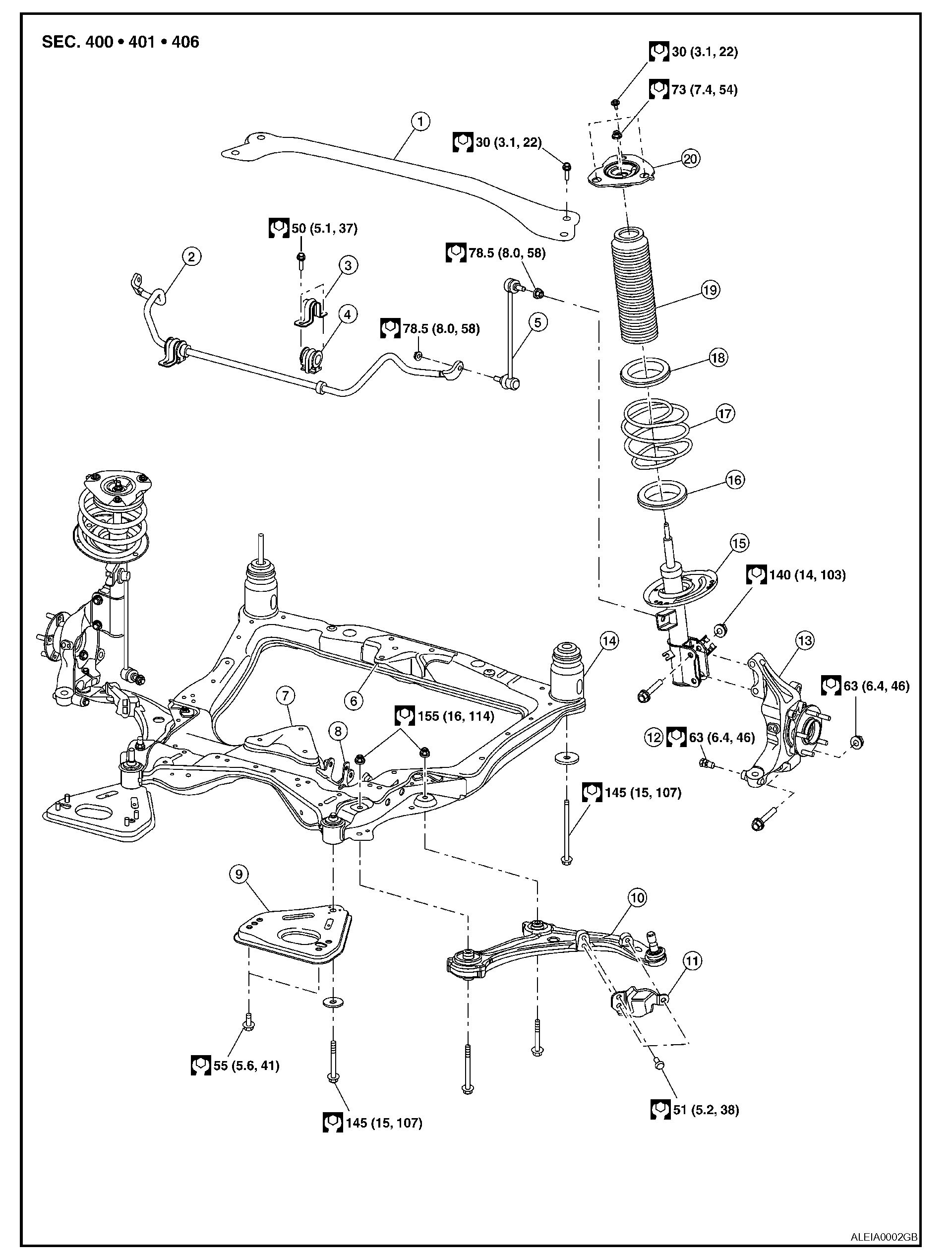

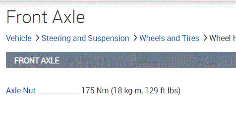

What are the torque specs for tightening the right hand passenger side axle nut, spindle knuckle bolts and the 2 13mm bolts for the Carrier Keeper? What if I don't have a power tool can I use a ratchet and breaker bar to remove these bolts/parts? And Use a torque wrench to tighten them back? which torque wrench should i use?
Dec 16, 2020 at 11:37 AM
  • 110,194 POSTS

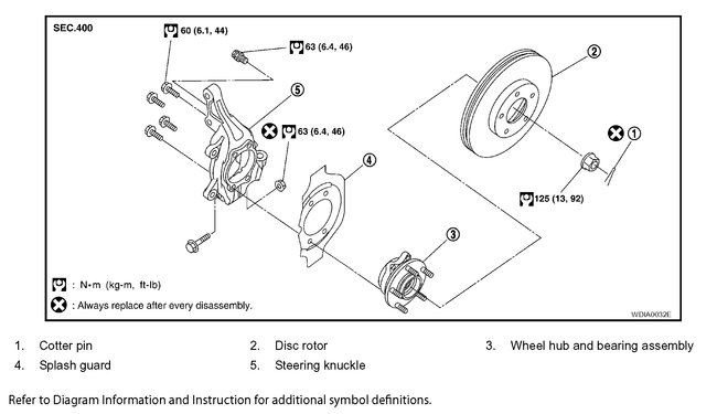

Pics 1 and 2 show the torque specs. Pic 1 is the axle nut and pic 2 is for the ball joints which I believe what you are referring to when you say steering knuckle.

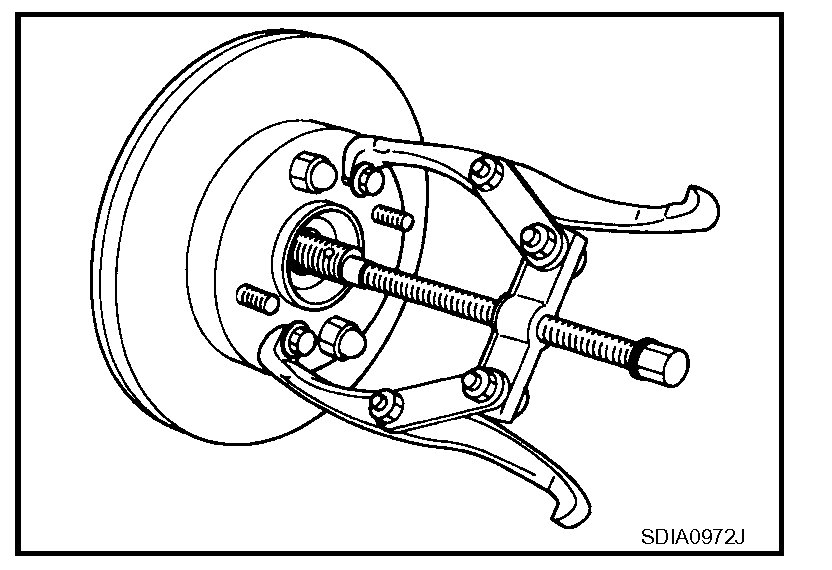

I don't know if you need it, but here are the directions for replacing the axle. The remaining pictures correlate with the directions.
_____________________________________________
2007 Nissan-Datsun Altima L4-2.5L (QR25DE)
Front Axle
Vehicle Steering and Suspension Steering Front Steering Knuckle Service and Repair Removal and Replacement Front Axle
FRONT AXLE
FRONT WHEEL HUB AND KNUCKLE
Removal and Installation

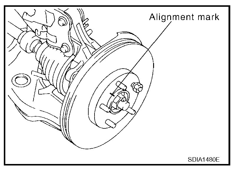

Exploded View FSU-13 (Part 1)
pic 3

Exploded View FAX-7
pic 5

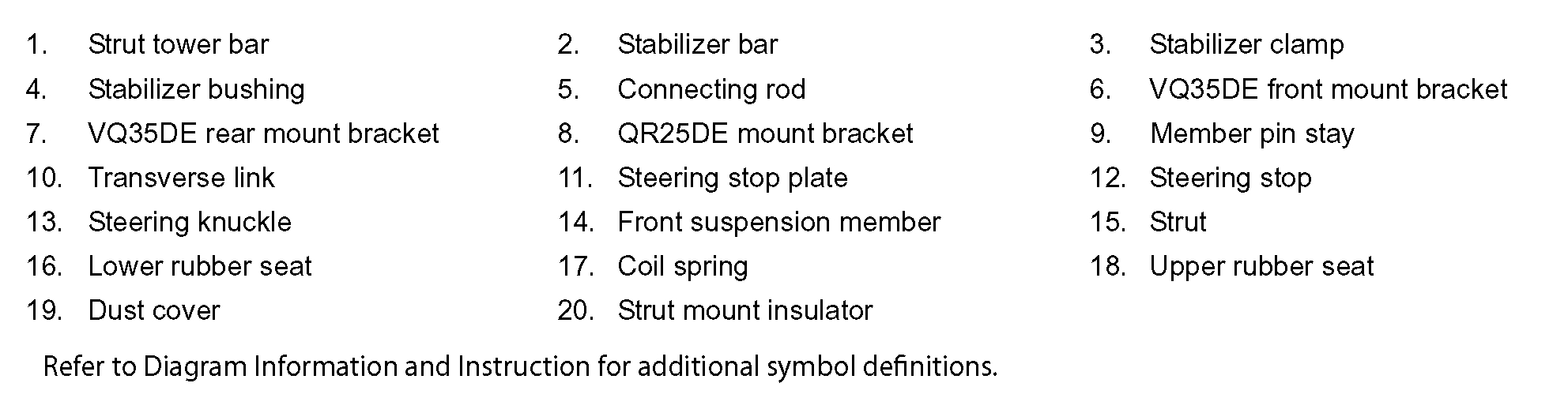

pic 6

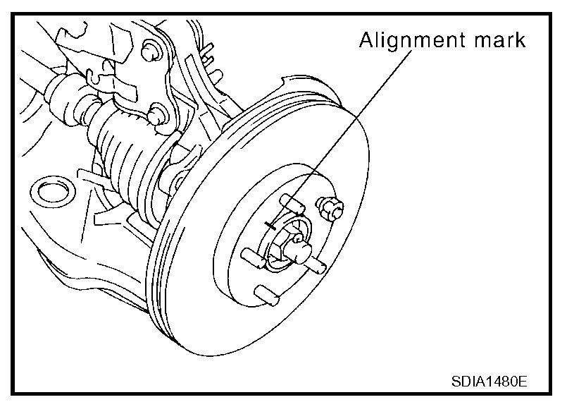

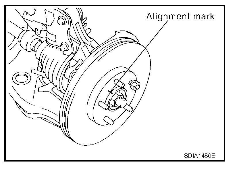

3. Put alignment marks on disc rotor and wheel hub and bearing assembly, then remove disc rotor.

5. Remove cotter pin, then remove lock nut from drive shaft using power tool.

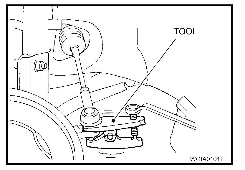

6. Remove steering outer tie-rod cotter pin at steering knuckle, then loosen nut using power tool.
Pic 7
7. Disconnect the outer tie-rod end from steering knuckle using Tool. Be careful not to damage ball joint boot.
CAUTION: To prevent damage to threads and to prevent Tool from coming off suddenly, temporarily tighten mounting nut.
Tool number: HT72520000 (J-25730-A)

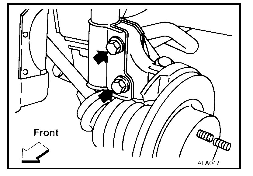

8. Remove transverse link and steering knuckle pinch bolt and nut using power tool. Refer to Exploded View FSU-13.
pic 8
9. Remove wheel hub and bearing assembly from drive shaft using a puller or suitable tool.
CAUTION:
^ When removing wheel hub and bearing assembly, do not apply an excessive angle to drive shaft joint. Also be careful not to excessively extend slide joint.
^ Support drive shaft when removing.
10. Remove wheel hub and bearing assembly bolts using power tool.
11. Remove splash guard and wheel hub and bearing assembly from steering knuckle.
pic 11
12. Remove the lower strut bolts and nuts using power tool. Refer to Exploded View FSU-13.
13. Remove steering knuckle from vehicle.
