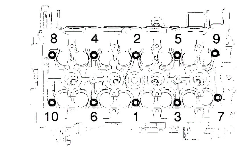

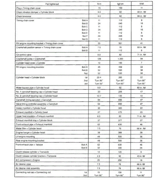

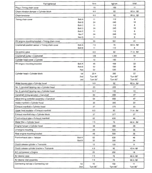

I need to know all torque specs of 2nz fe engine.
Sep 2, 2020 at 12:00 PM
Good evening,
I attached the torque specs for the engine plus a little more on sequences.
Let me know if you have any other questions.
TORQUE SPECIFICATION
Cylinder Head
Torque: 29.4 Nm (300 kgf-cm, 22 ft. lbs.) Initial +90 +90

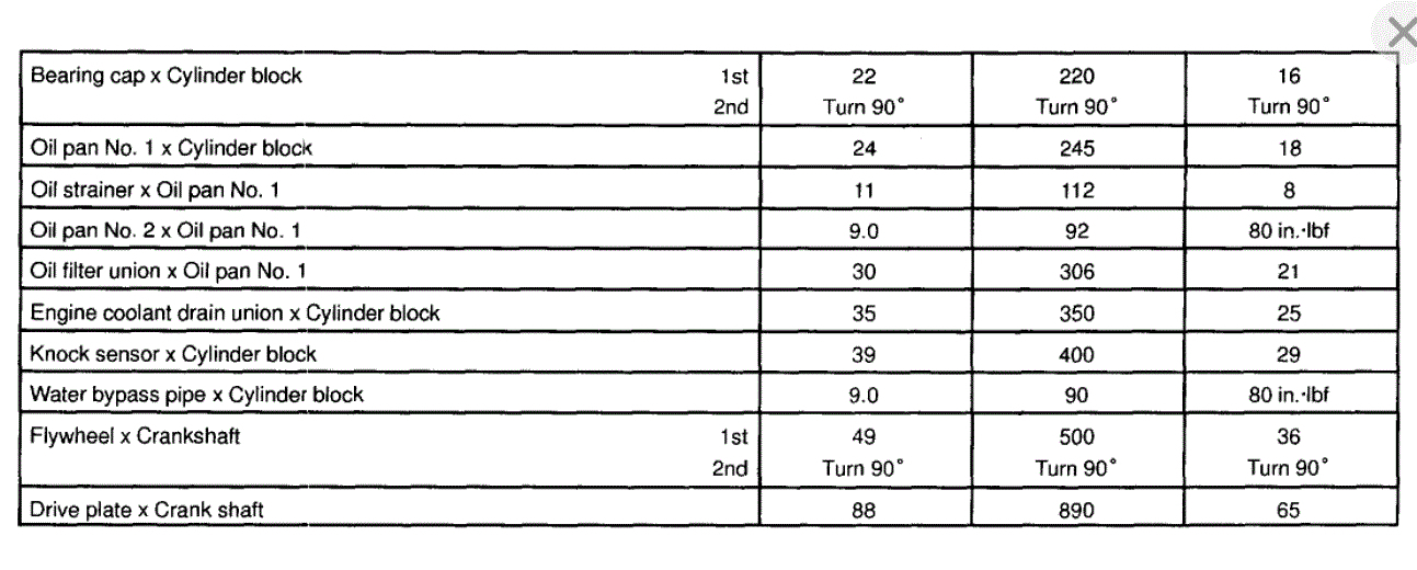

Main Bearing Cap
Torque:
1ST 22 Nm (220 kgf-cm, 16 ft. lbs.)
2ND Turn 90°
Rod Bearing Cap Bolts
Torque:
1ST 15 Nm (150 kgf-cm, 11 ft. lbs.)
2ND Turn 90°

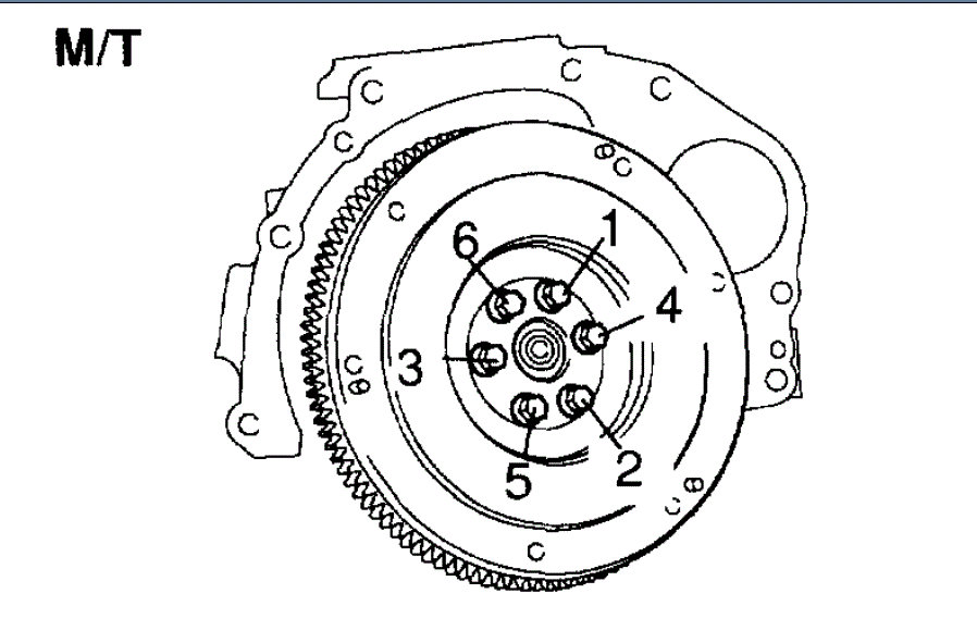

Flywheel
Torque: 49 Nm (500 kgf-cm, 36 ft. lbs.)
b) Mark the flywheel bolt with paint.
c) Retighten the flywheel bolts by an additional 90°.
d) Check that the painted mark in now at a 90° angle to (b).
Oil Pump
Torque:
Bolt 9.0 Nm (92 kgf-cm, 80 inch lbs.)
Screw 11 Nm (110 kgf-cm, 8 ft. lbs.)
Crankshaft pulley
Torque: 128 Nm (1,300 kgf-cm, 94 ft. lbs.)
Intake Manifold
Torque: 30 Nm (300 kgf-cm, 22 ft. lbs.)
Exhaust Manifold
Torque: 27 Nm (275 kgf-cm, 20 ft. lbs.)
Camshaft Bearing Cap Torque
No. 1 camshaft bearing cap x Cylinder head .................... 23 Nm (235 kgf-cm, 17 ft. lbs.)
No. 2 camshaft bearing cap x Cylinder head .................... 12.7 Nm (130 kgf-cm, 10 ft. lbs.)
Pump pulley x Water pump
Torque: 15 Nm (150 kgf-cm, 11 ft. lbs.)
