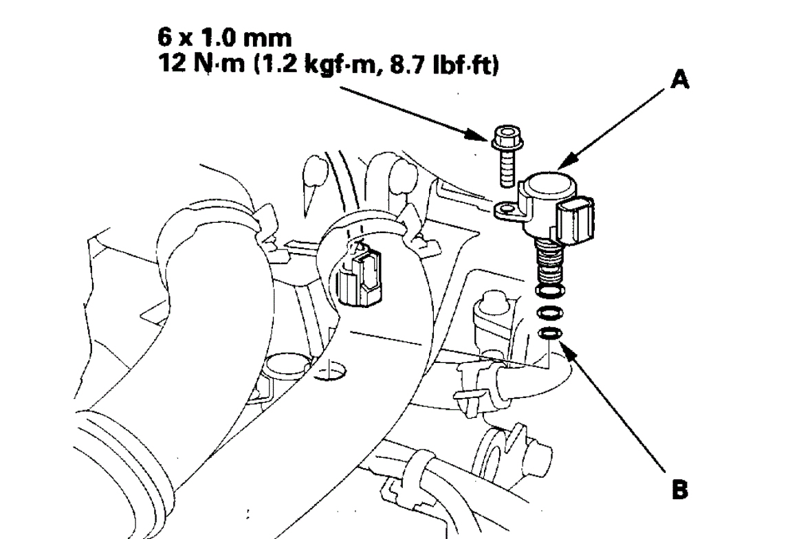

One of the solenoid bolts is stripped and I cannot remove the solenoid

In this picture the housing the radiator hose goes to which in the picture is above the solenoid hole, my question is it possible to get more room to drill out the broken bolt with extractor by removing the metal pipe?
Tuesday, November 2nd, 2021 AT 12:56 AM
  • 109,885 POSTS
Have you removed the hoses? And yes, anything you can get moved will help.
Tuesday, November 2nd, 2021 AT 4:56 PM

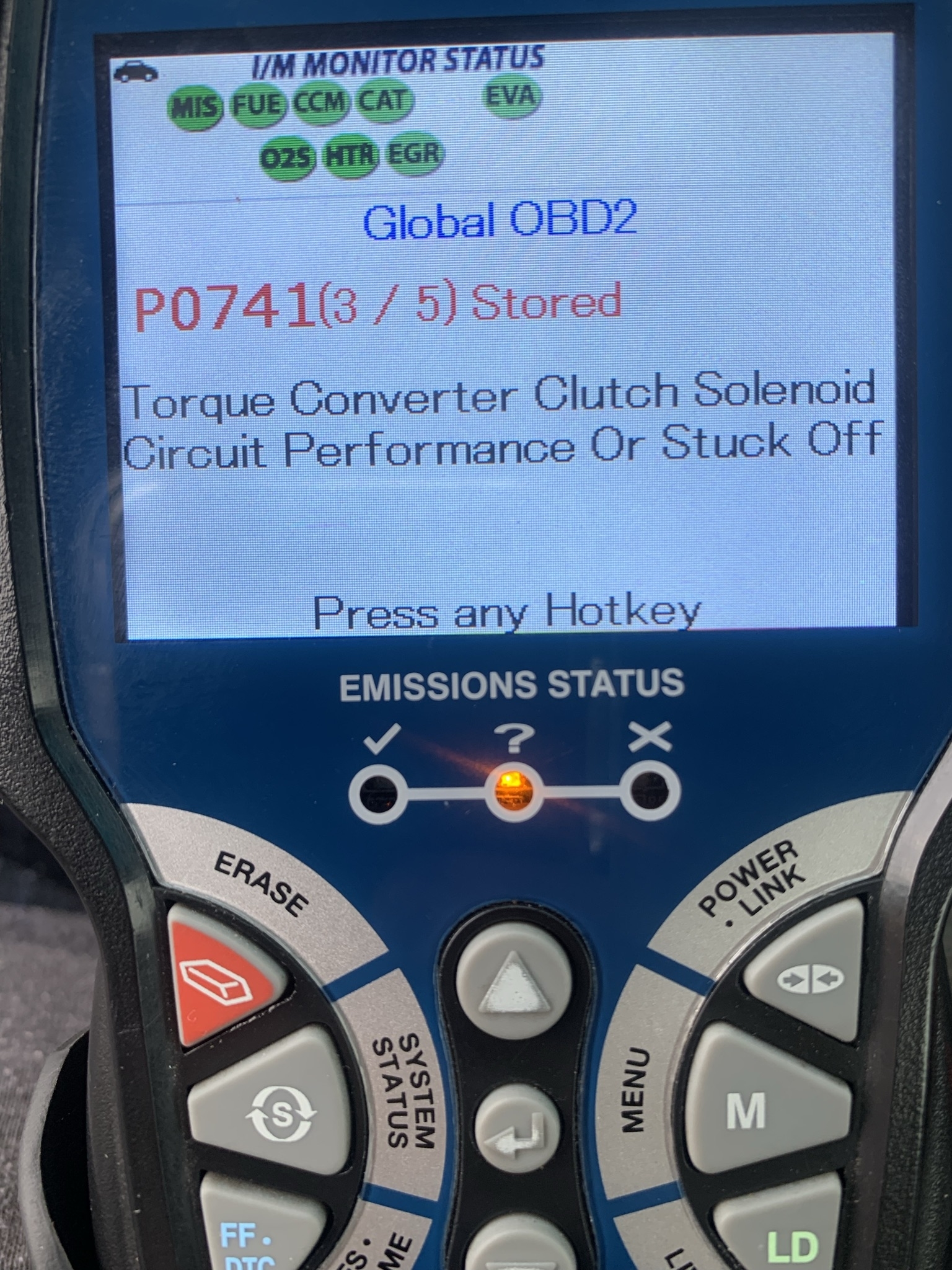

Do you think I need a new solenoid?
Tuesday, November 2nd, 2021 AT 4:58 PM
  • 109,885 POSTS
In your first post, you mentioned how to reset/clear the code. Was there a diagnostic trouble code related to this sensor? If so, I would replace it. If not, let me know what the code was so I can better direct you.
Tuesday, November 2nd, 2021 AT 6:43 PM

Here’s code.
Tuesday, November 2nd, 2021 AT 6:54 PM
  • 109,885 POSTS
Based on that code, I suggest replacing it. Chances are that is what set the code.

There are 2 sensors right next to each other, do both need replacing?
Wednesday, November 3rd, 2021 AT 1:54 PM
  • 109,885 POSTS
Since the code is specific to the TCC solenoid, that is the only one I would replace.

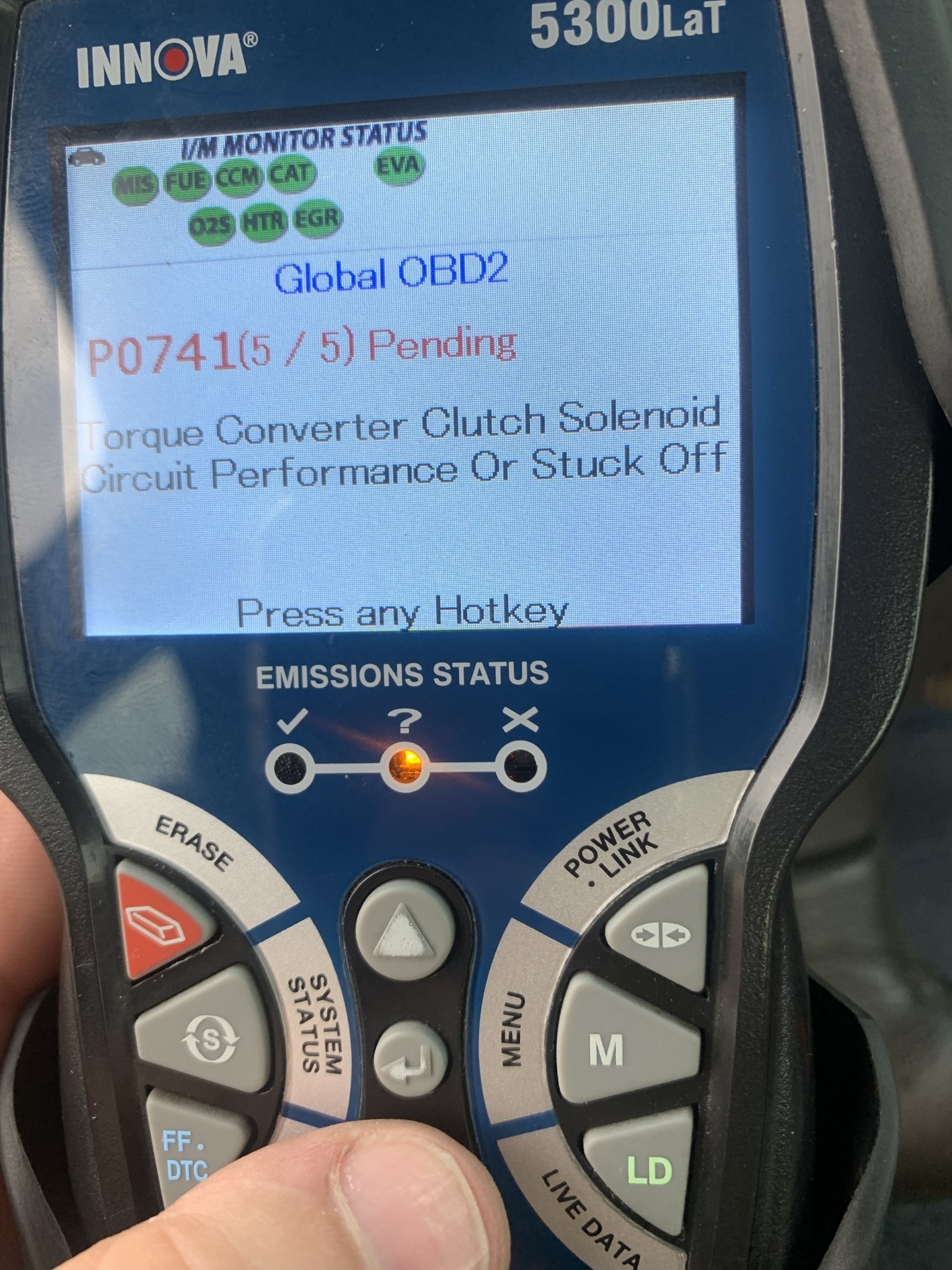

So, I replaced the torque converter solenoid and still doesn’t seem to want to move, it has a whiny noise near transmission, I am stumped what can be done.
