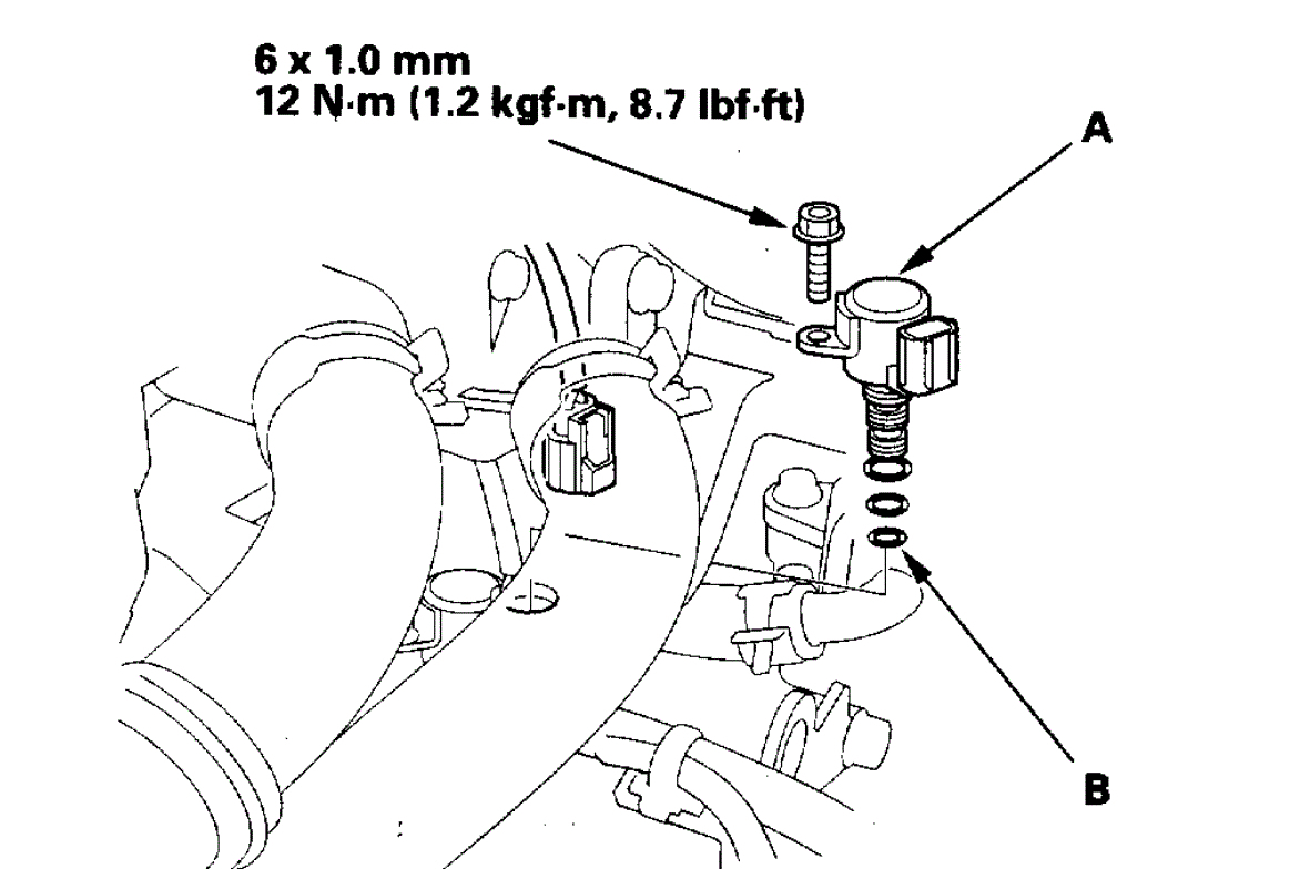

One of the solenoid bolts is stripped and I cannot remove the solenoid

The solenoid I’m referring to is under the upper radiator hoses down near engine kind of hard to get at, how can I get this solenoid out and how can I force reset the check engine without a scanner?

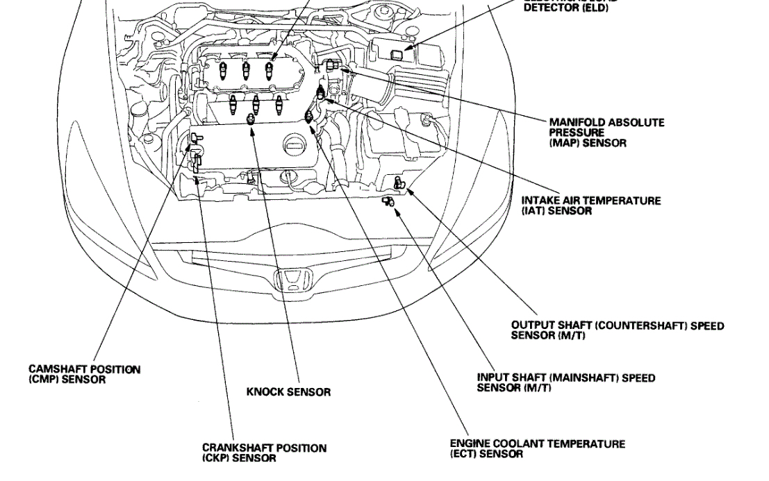

Hi, David.
I need you to take a picture of the component you are referring to. There really aren't any solenoids where you mentioned.
Take a look at the pic below. Do you see what you are referring to or can you tell me the location? Also, can you tell me what diagnostic trouble code was found?
See pic below.

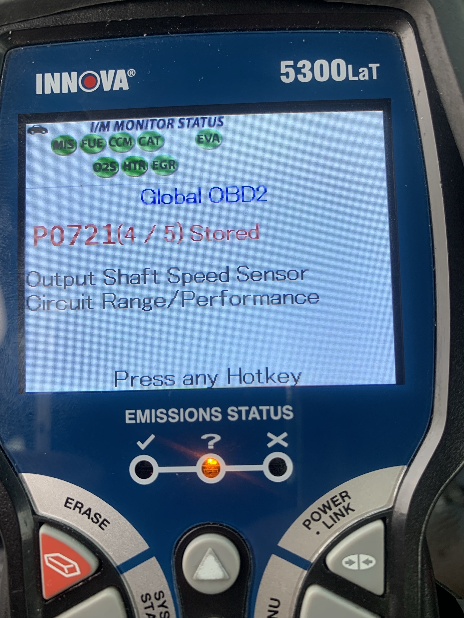

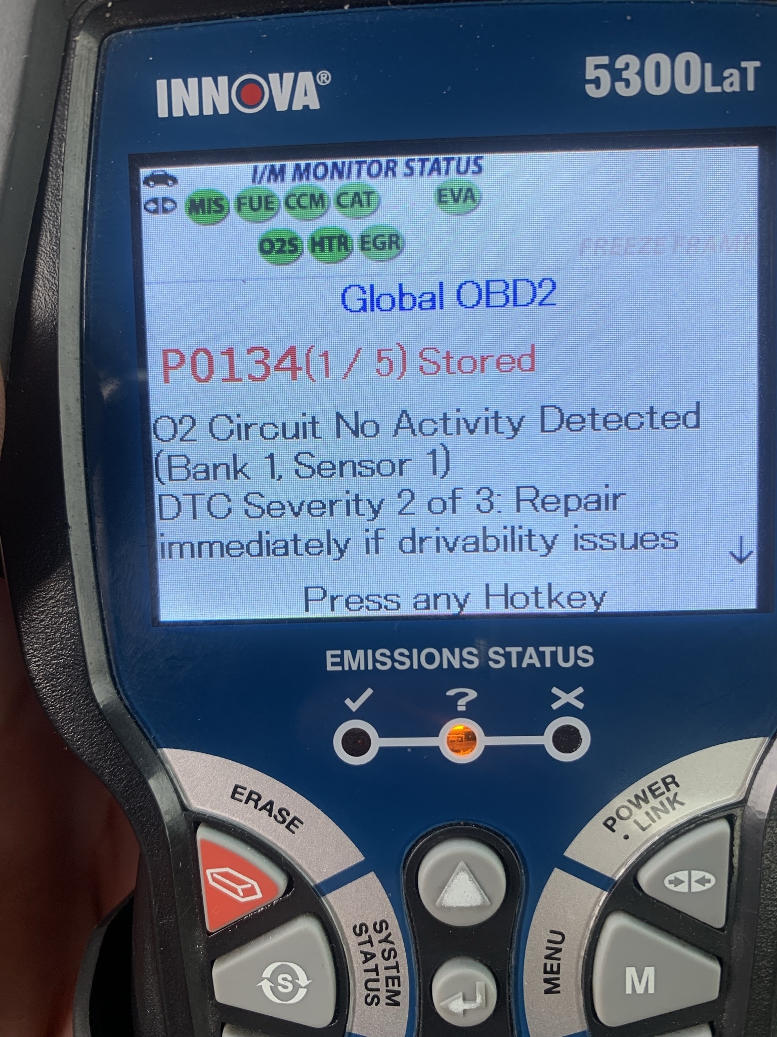

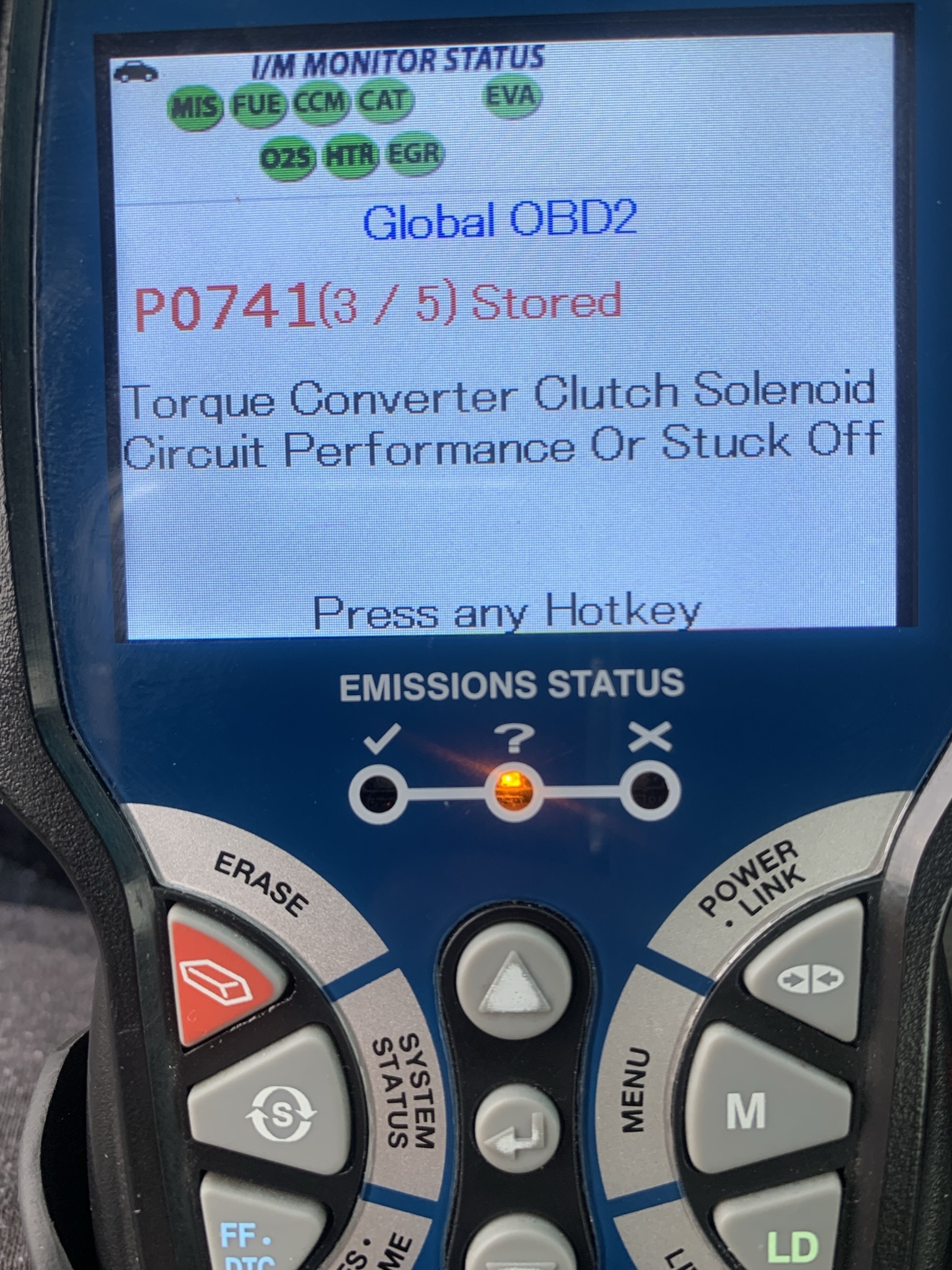

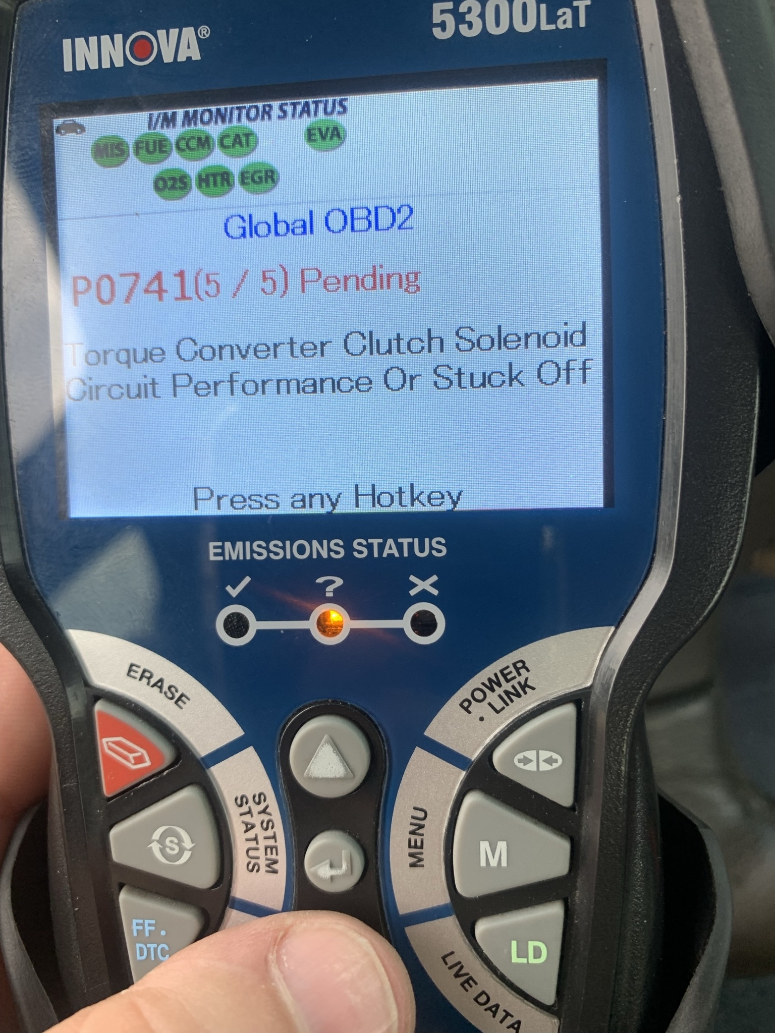

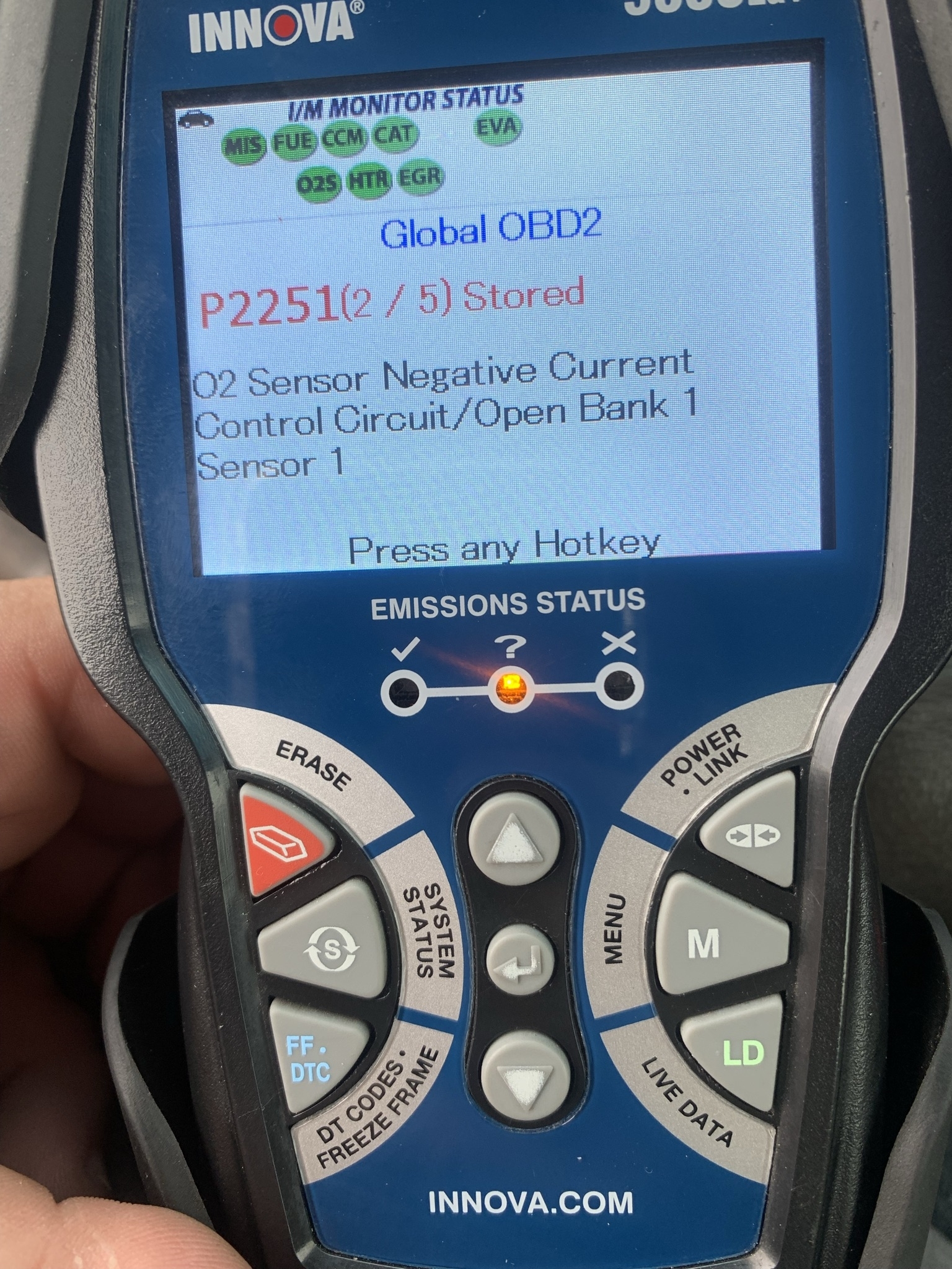

I have uploaded the codes for you.
Oct 15, 2021 at 2:50 PM
  • 110,244 POSTS

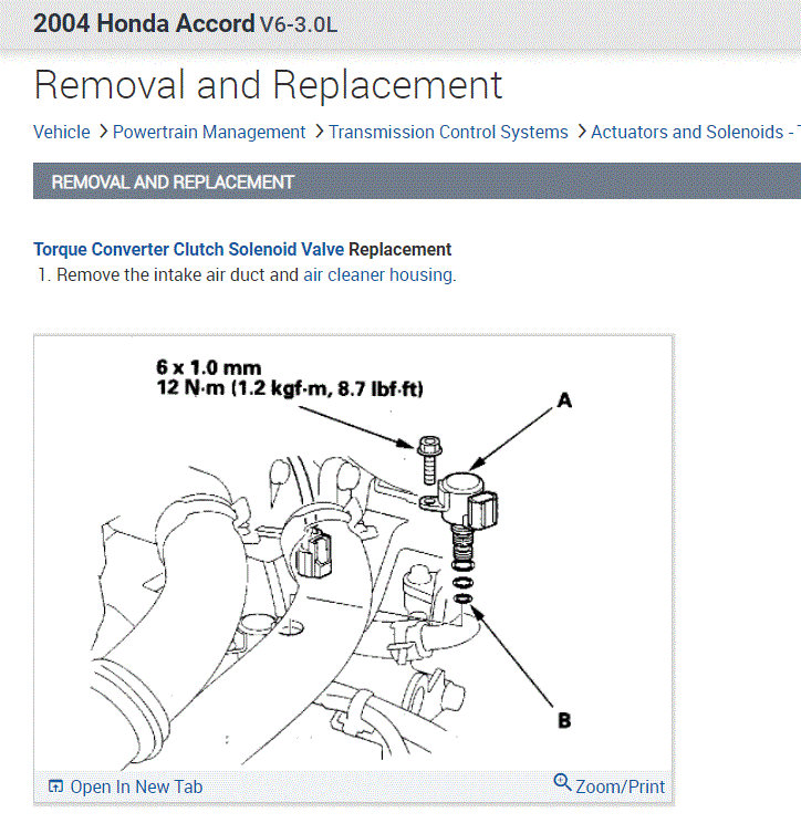

The codes are related mostly to the torque converter clutch solenoid. Take a look at the pic below and let me know if that is the component you are referring to.
If that, is it, what is stropped? Is it where the wrench goes on it or are the threads stripped causing the bolt to just turn and not come out?

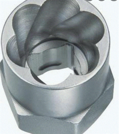

If it is where the wrench attaches, use a bolt extractor. Basically, it is similar to a socket, but it's designed to cut into the stripped bolt so it can be removed. I attached a pic of what they look like.
As far as the reset, you can disconnect the battery terminals (negative first) and tie the two cables together with a zip tie. Allow it to sit that way for approximately 10 minutes. That will drain any power from capacitors. That should reset it. If it doesn't, it will turn itself off after a few trips where there isn't an issue.
When reconnecting the battery, start with the positive and then connect the negative.
Let me know if this helps.

FARR2007
  • 244 POSTS
Yes, the solenoid I can’t get out looks like that there are 2 side by side.

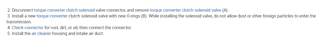

  • 110,244 POSTS
The pic above is the TCC solenoid. As far as the bolt, is it the head of the bolt that is bad or the threads? If it's the bolt head, see if you can get your hands on a set of the extractors like I attached. Oftentimes, a parts store will lend them to you.
Then, find the size that fits snug over the stripped bolt head, and try loosening it with that on the bolt. They are made to cut into the bolt in the reverse direction so you can remove the bolt.
I attached the directions below for replacement. As far as torque, the manual isn't supplying them. I would think 7 - 10 ft pounds would be good.

Without the tool, if the hex head is stripped, the best you can try is to use something like vice grips, or tap on a smaller socket, or anything that will grab that bolt.

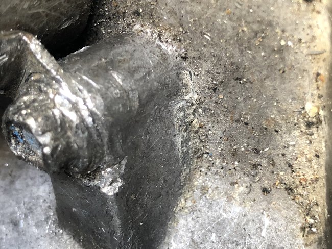

FARR2007
  • 244 POSTS

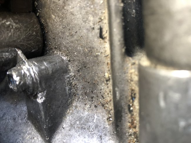

It looks like a previous owner welded the solenoid bolt to the transmission and I need to get the dang bolt out, what can I do?
Oct 22, 2021 at 4:48 AM

Wow! That isn't good. Can you take a pic and upload it for me to see it? That will help me come up with a few ideas.
Often times when I have an issue with a bolt, I will take an air Dremel and with a burr and slowly remove the area that is bad. In this case, the weld.
I need to see exactly what you are dealing with to be sure it would work.

FARR2007
  • 244 POSTS
Here are the best pics I could get:
Oct 22, 2021 at 1:34 PM
FARR2007
  • 244 POSTS
I hope that helps!
Oct 22, 2021 at 1:52 PM
  • 110,244 POSTS
It does help. I don't see anything that appears welded. Were you able to try one of the bolt extractors I mentioned above? I feel that would remove the bolt for you. Simply get one that is slightly tight on the bolt, tap it on lightly, and then turn it to remove. It should bite into the bolt. There is enough left of it.

If you place the socket on an extension, can you get it to a point that it's more accessible? The nice thing about the extractor I mentioned is even if you can't tap it gently into place, most times the pressure of pushing on it with your fingers will cause it to grab.

Sorry to inform you the bolt extractor set failed and would not budge this bolt. I don't know what else to do!

Since the space is limited, I'm not sure how I would handle it. Heat could help, but I don't like heating aluminum, but it can be done carefully. We can't cut it because then the threaded part will need drilled out and likely rethreaded.
At this point, I feel heating it may be the only choice. Are you able to heat the bolt with a torch? If so, heat the head of the bolt. In this case, the aluminum it's attached to will draw in the heat. Heat the bolt itself by keeping the flame about 2 to 3 inches away from the bolt head. Try to avoid directing the flame right at the aluminum. Focus it on the bolt head.
Once the bolt gets hot, allow it to cool to room temperature. See if it will come out then. If it doesn't then try heating it again. Eventually, the expansion and contraction of the different metals should break free from corrosion.
I wish I had an easier way to do it, but you have tried all the traditional ways.

According to my repair manuals, it appears to be Honda part number 28500P6H003. Please confirm that when making a purchase.

In your first post, you mentioned how to reset/clear the code. Was there a diagnostic trouble code related to this sensor? If so, I would replace it. If not, let me know what the code was so I can better direct you.
Nov 2, 2021 at 11:43 AM
FARR2007
  • 244 POSTS
Here’s code.
Nov 2, 2021 at 11:54 AM
  • 110,244 POSTS
Based on that code, I suggest replacing it. Chances are that is what set the code.

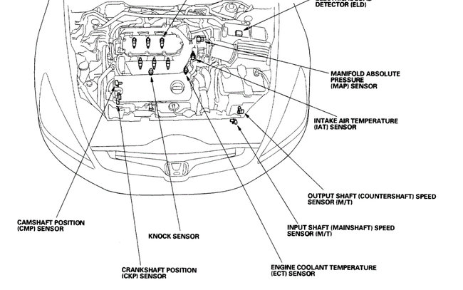

There are 2 sensors right next to each other, do both need replacing?
Nov 3, 2021 at 6:54 AM
  • 110,244 POSTS
Since the code is specific to the TCC solenoid, that is the only one I would replace.

So, I replaced the torque converter solenoid and still doesn’t seem to want to move, it has a whiny noise near transmission, I am stumped what can be done.
