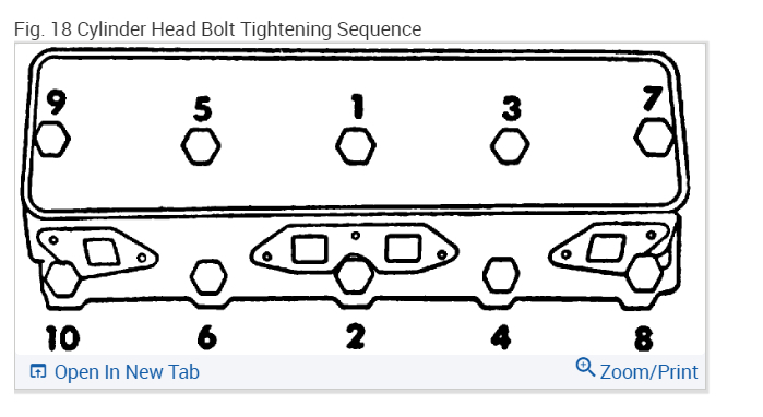

Hello, just needed to know if the truck listed above uses normal or flex bolts? My heads are cast iron?
Apr 20, 2023 at 6:21 AM
  • 55,433 POSTS
Here are the torque specs for the engine and I have included how to use a torque wrench video in case you need it. There are two different kinds of bolts the torque to yield bolts will need to be replaced, see below:
https://youtu.be/juOClONIWeY
On engines with non-flanged hex head bolts, using sequence shown in Fig. 18, torque cylinder head bolts in two steps; first to 55-65 ft lb, then to 65-72 ft lb.
On engines with flanged hex head bolts (torque to yield), using sequence shown in Fig. 18, torque cylinder head bolts in three steps; first to 25-35 ft lb, second to 45-55 ft lb, then tighten an additional 1/4 turn (85-95 degrees).

Check out the images (below). Please let us know if you need anything else to get the problem fixed.
