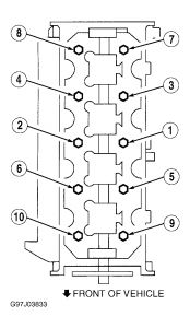

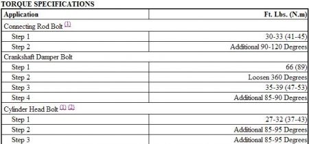

Ive been trying to find out what the head bolt torque spec and sequence is for my truck. It is not the Lighting mode. I dont know if there is a difference in the engines.
Oct 9, 2009 at 1:20 PM
BLUELIGHTNIN6
  • 16,542 POSTS
https://images.2carpros.com/forum/automotive_pictures/261618_Noname_1060.jpg
https://images.2carpros.com/forum/automotive_pictures/261618_Noname2_303.jpg
FIG.5
https://images.2carpros.com/forum/automotive_pictures/261618_Graphic_194.jpg
