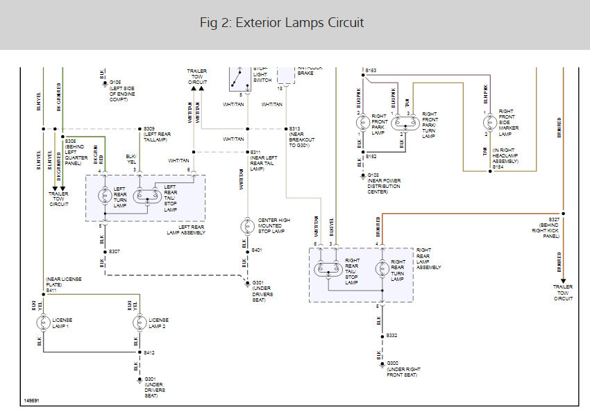

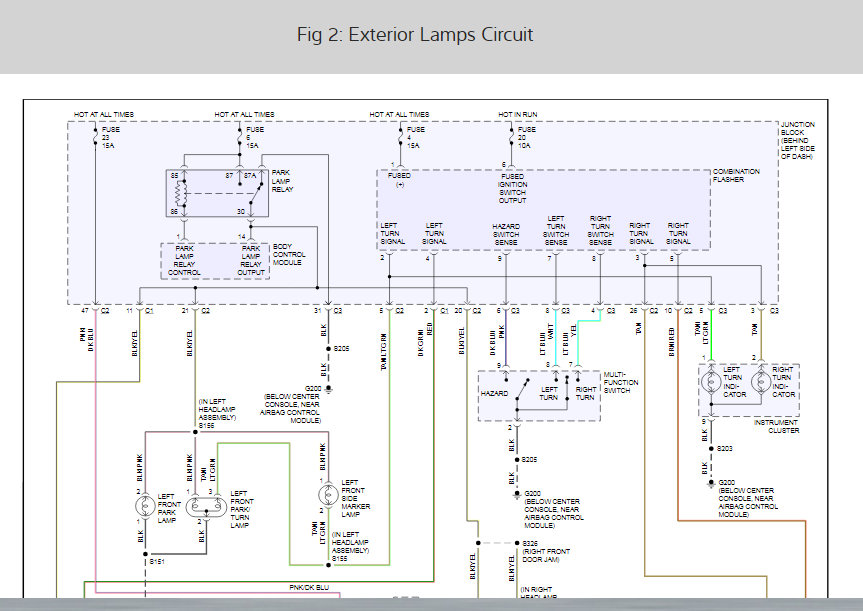

Alright. Turn signals won't work, have checked fuses, replaced relay, and switch still nothing. If I disconnect the plug from the switch and touch the high beam or hazard post said unit will turn on. But nothing from turn signals. I can't find proper voltage any where for what should be coming in from the JB. Any help is appreciated
Jul 17, 2019 at 4:06 PM
SCGRANTURISMO
  • 4,897 POSTS

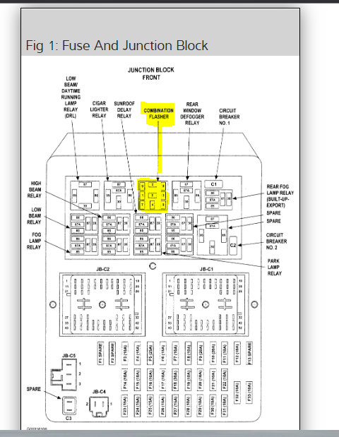

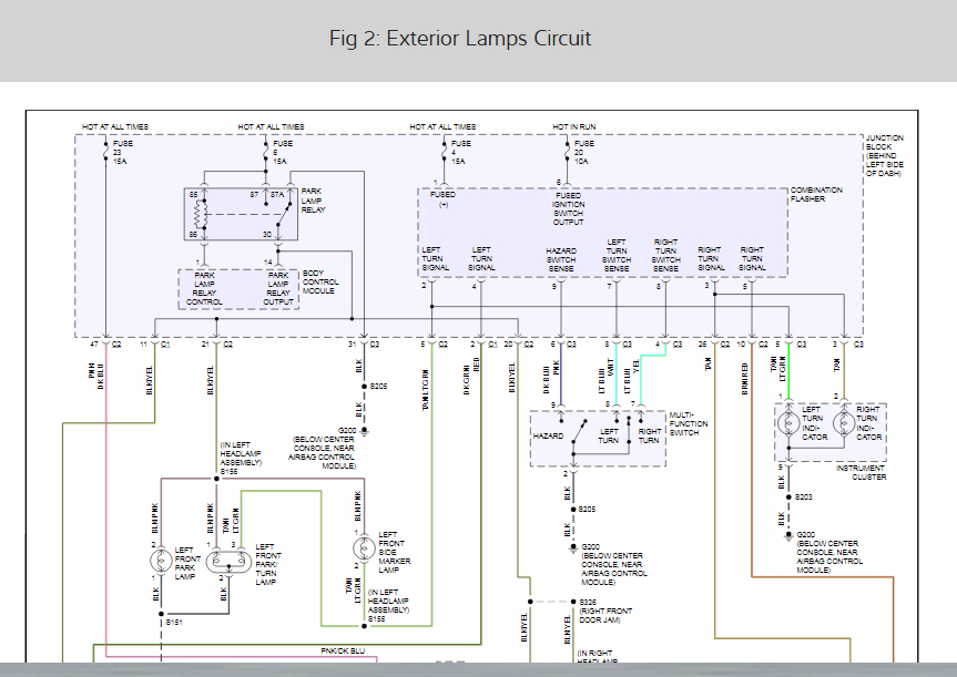

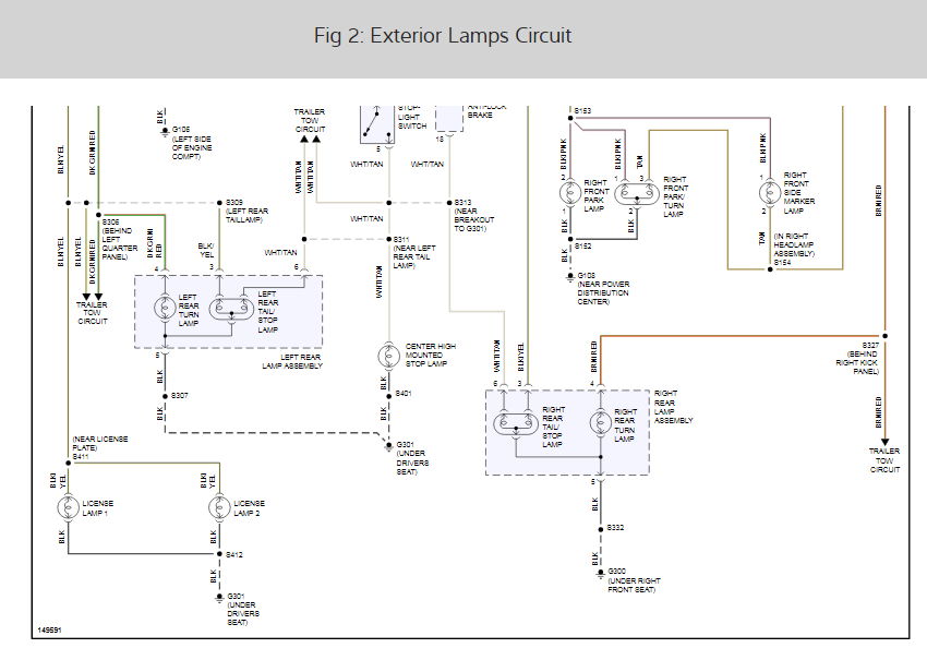

This sounds like you could have a problem with your vehicle's Combination Flasher, which is located on the junction block. In the diagrams down below I have included a wiring diagram for your vehicle's exterior lighting as well as a diagram of the junction block with the combination flasher highlighted for you. Please go through these guides and get back to us with what you are able to find out.

Thanks for responding. but as previously stated that has already been replaced (twice).

Do you have power at the fuses(23,6,4,20) at the Junction Box?

Okay. I can get you through the process to find the problem real easy. I just wanted to rule out the fuses in the circuit first. After the fuses we will be taking voltage readings, so you will need a multimeter. We will cross that bridge when, and if we have to, though. Check the fuses and get back to us with what you find out. We will go from there.
