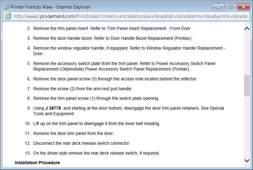

Louie. This is a GT Sedan. The front drivers side window regulator has broken somewhere. It has power windows, and the regulator goes down, but you must push the window down by hand. The window will come back up with the regulator, but it comes in a cocked position, and this makes the glass get jammed up and won't allow it to rise all the way. You must use your hands to wiggle the glass into a position so the power regulator can raise it all the way up. I'm guessing the plastic clips that bolt the regulator to the glass has broke. Do you know of any sites that tell/show how to do this procedure? I've found a site that sells a new regulator with motor for about $36.00, which I think is a very good price, especially after checking the prices at Auto Zone and Advance Auto. I also found just the plastic clips for sale too, but for $36.00, I can replace the whole thing if it isn't too hard of a job. I never done this before, but I'm sure I can do the job myself. I just don't want to start it before checking to see if there are any tricks I should know, or if maybe something else has broken I'm not aware of. I told you I'd be contacting you again soon. LOL. Thanks again my friend

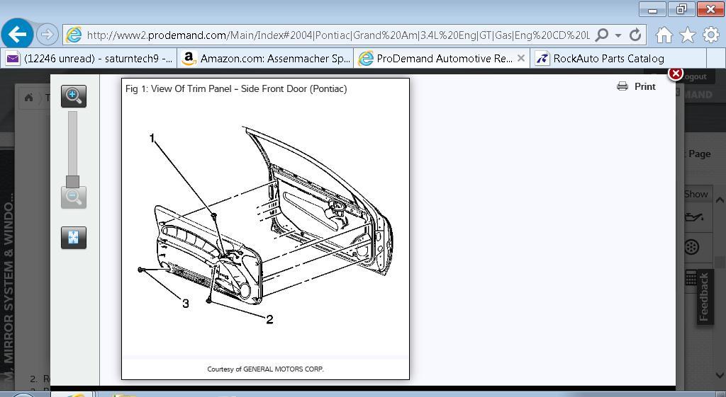

Hey there I looked at your window regulator its two pieces connected with cables its like the chevy trucks tahoes etc. The plastic pieces break.I recommend getting the dorman one there life time warranty. They sell themfor about 60 on rock auto dot com plus shipping I have a 5 percent discount code if your interested helps off set the shipping. Once the inner door panel is off its pretty straight forward unbolt the window then slide the window up and unplug the window motor and and unbolt the regulator.I then slide it out when you put the new regulator in make sure the cables between the two pieces are twisted when installing the new regulator.I posted instructions.

Hello once again my friend. The task does look simple enough, and I'm sure I can do it. Thank you for your input and especially the pictures on how to do the job, I did find several sites on EBAY selling the plastic clips that are on the regulator and bolt to the window, but I also found a sight that says these clips aren't replaceable. A bit confusing to me. Either they can or they can't be replaced. I will try to find this out just to clear things up for myself. The regulator is going up and down or I wouldn't be able to push the window down and then the regulator bringing it back up. I'm sure it's the clips, or the sash clips have come unglued from the window, which would produce the same results. I found a site that sells them too. If I decide to buy a regulator, I will follow your suggestion to buy a Dorman from Rock Auto. I've dealt with them before and was very satisfied. We just had a snow storm, followed by an ice storm, and they are calling for more snow over the week end. Being I'm doing this in my driveway, it will have to wait till "Mother Nature" allows me to do so. I will keep you informed. Again, thank you for all your help. Take care.
