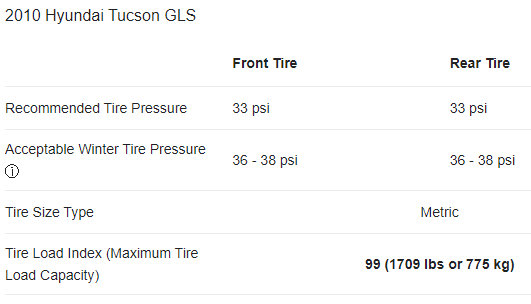

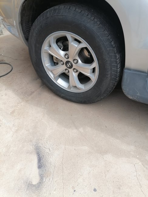

My tire pressure 30 PSI as per manufacturer's' recommendation but it looks not enough as you see in the image.
Seem like a low pressure.
Jul 17, 2021 at 12:11 PM
SQM
  • 6,383 POSTS

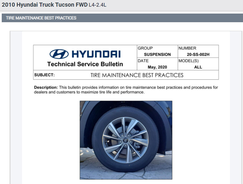

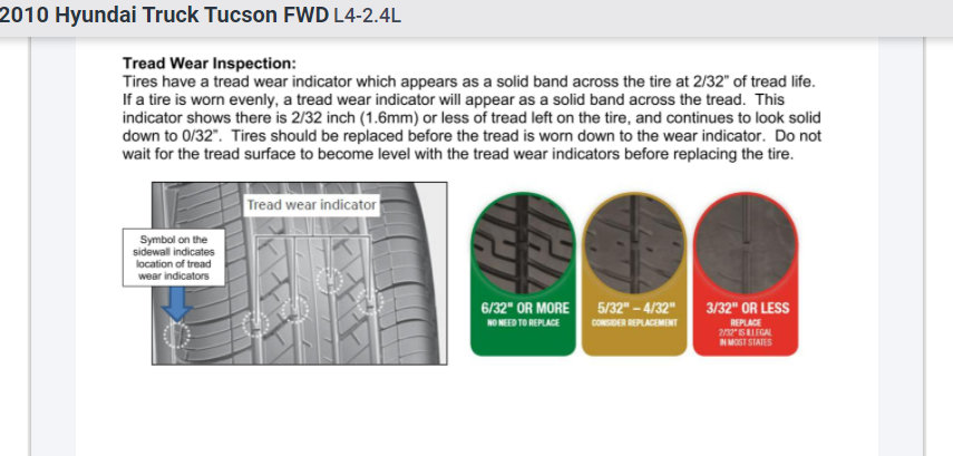

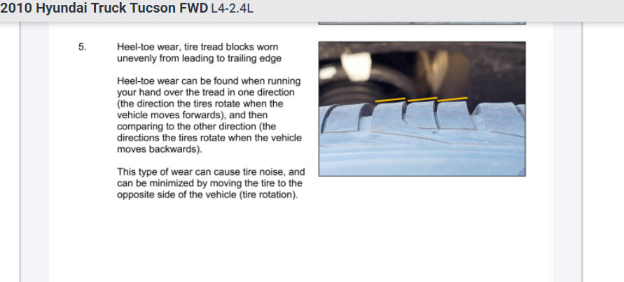

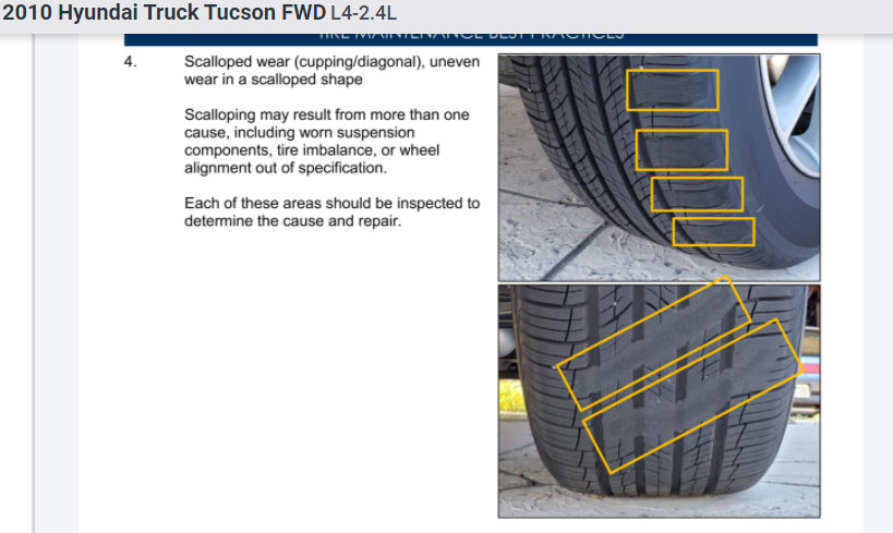

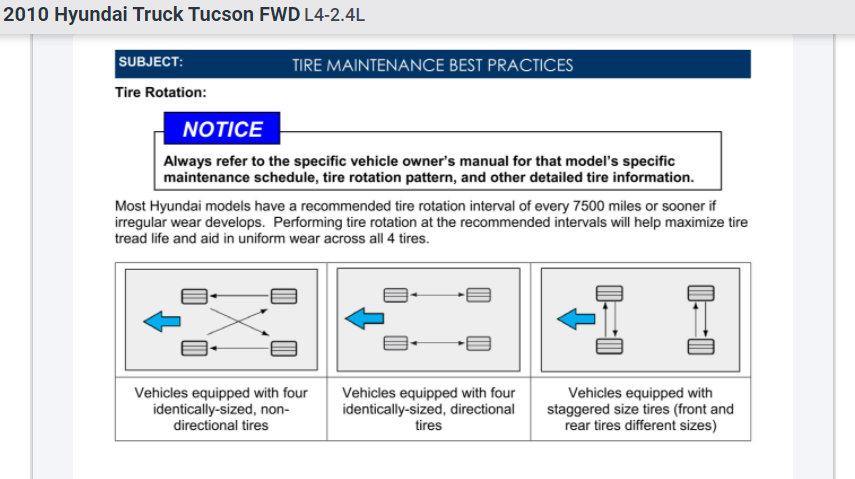

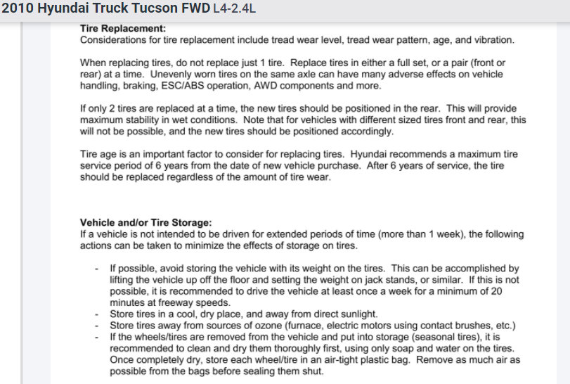

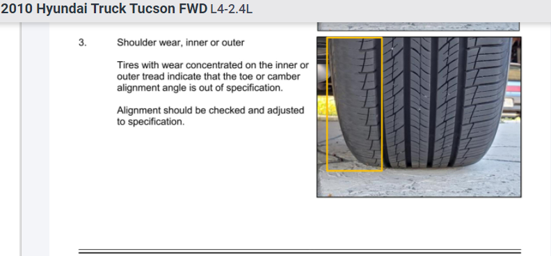

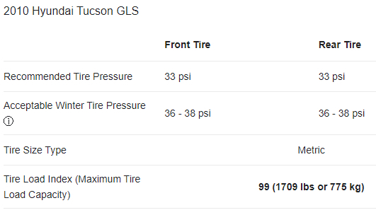

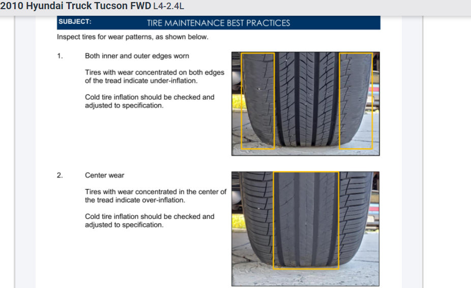

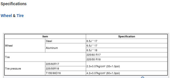

According to our charts the correct tire pressure should be 33 PSI. I have attached the recommended pressure and some tire maintenance best practices for your reference.
Also if the load rating on the tire is lower than the ideal load rating for your vehicle it can appear low even when you have correct pressure.
Here is a helpful article about tire pressure and more info on tires in general:
https://www.2carpros.com/articles/how-to-use-a-tire-pressure-gauge
