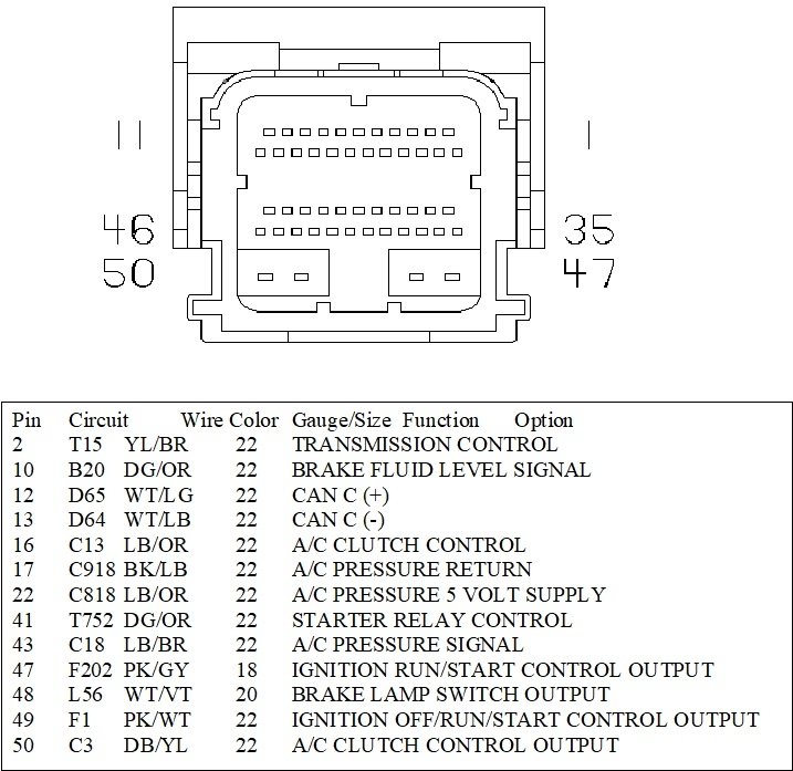

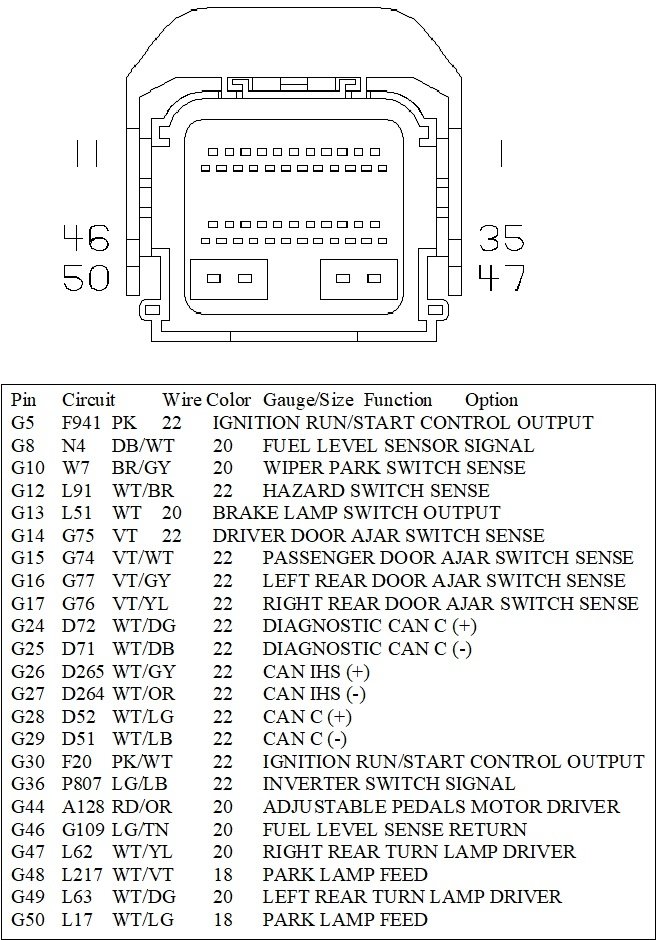

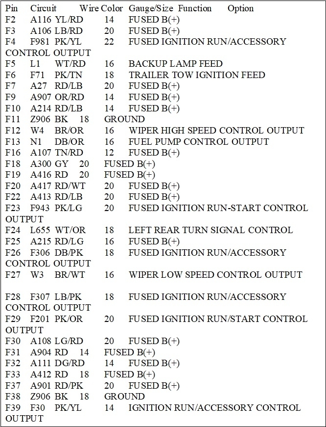

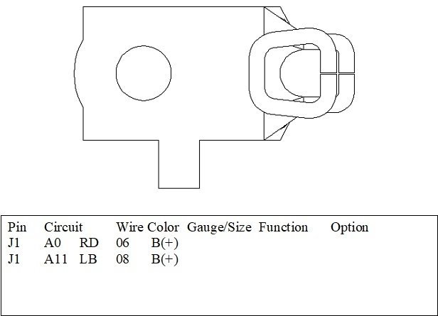

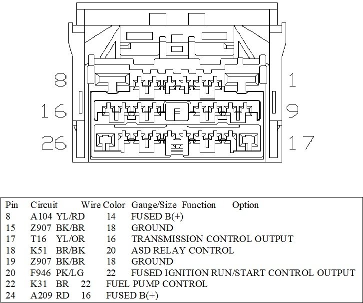

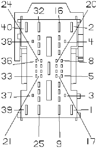

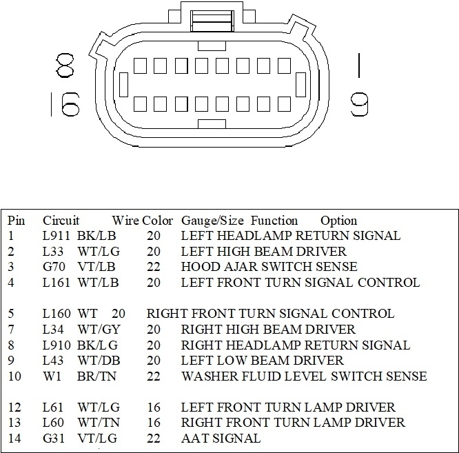

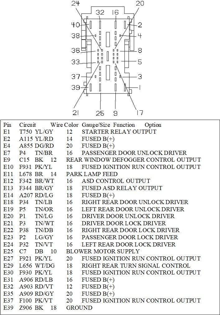

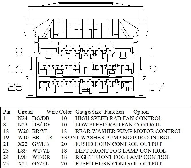

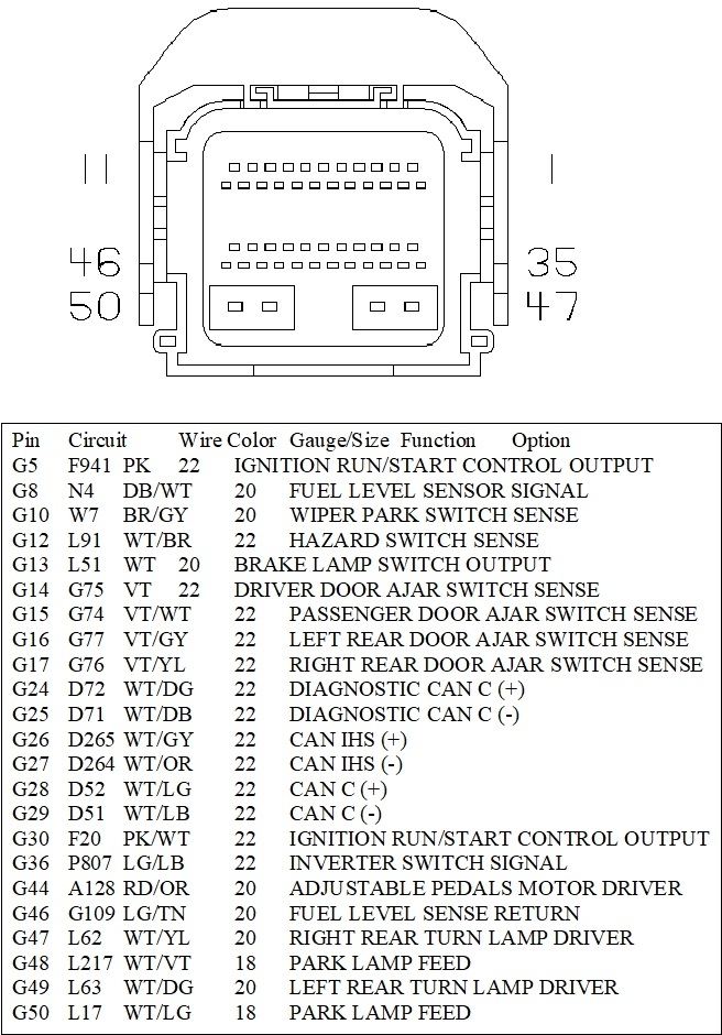

I have the truck listed above 1500 and I am looking for a diagram or something that would show me the TIPM (under fuse box) harness connectors-(I.e. C2 through C6) pin numbers with the corresponding wires. I can't seem to find this info anywhere and this particular truck has a couple harnesses made by Tyco? The 9,000 page pdf shop manual that I have shown different TIPM harness connectors than what the truck has. I've looked everywhere and can't find this info. Please help. Thanks

This fuse box is the same from 2010 through 2022 1500 models and should be the same for 2010 through 2012 2500s. The differences will be in the options on any truck. Some fuses may be missing, and a few can have different fuse ratings for different trucks. You'll see optional circuits listed in parenthesis on the underside of the fuse box cover.
You are likely to also find some wires and terminals missing in your fuse box if the option listed isn't on your truck.
