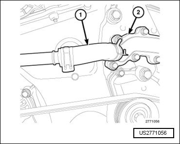

- Remove the upper radiator hose (2) and thermostat housing (1). Refer to => [ Thermostat ] See: Thermostat, Engine Cooling > Removal and Replacement > Thermostat.

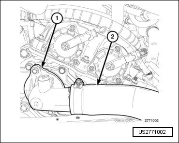

- Remove the heater core return hose (1) from the water pump housing.

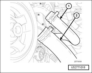

- Remove the lower radiator hose (2) from the water pump housing.

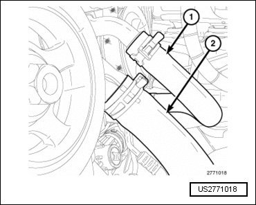

- Remove the heater core supply hose (1) from the coolant outlet housing (2).

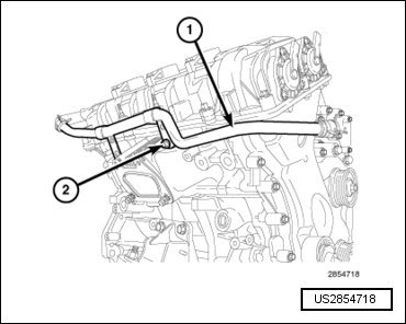

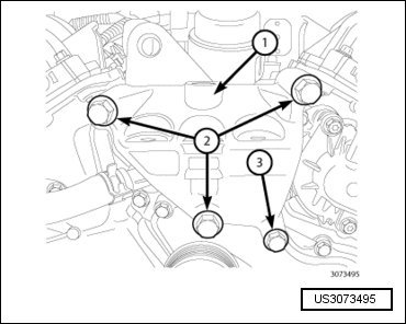

- Remove the bolt (2) and reposition the heater core supply tube (1).
pic 4

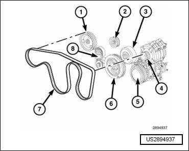

- Remove the accessory drive belt (4). Refer to => [ Accessory Drive Belt ] See: Drive Belt > Removal and Replacement > Accessory Drive Belt.

- Remove the accessory drive belt tensioner (7). Refer to => [ Accessory Drive Belt Tensioner ] See: Drive Belt > Removal and Replacement > Accessory Drive Belt Tensioner.
- Remove the accessory idler pulley (1). Refer to => [ Accessory Drive Belt Idler Pulley ] See: Drive Belt > Removal and Replacement > Accessory Drive Belt Idler Pulley.
- Remove the power steering pump pulley (5).
- Remove the crankshaft vibration damper (6). Refer to => [ Vibration Damper ] .

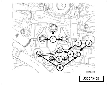

- Remove the right engine mount bracket. Refer to => [ Right Engine Mount/Bracket ] See: Engine Mount > Removal and Replacement > Right Engine Mount/Bracket.

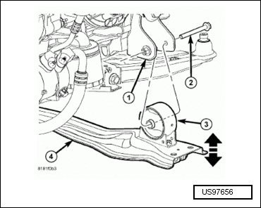

- Temporarily reinstall the front fore and aft crossmember (4).
pic 6
- Remove the right engine mount isolator and bracket (1). Refer to => [ Right Engine Mount/Bracket ] See: Engine Mount > Removal and Replacement > Right Engine Mount/Bracket.
pic 7

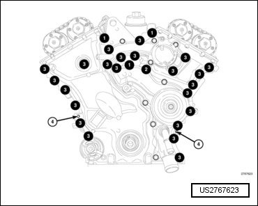

- Remove the twenty-three M6 bolts (3) from the timing cover.
pic 8

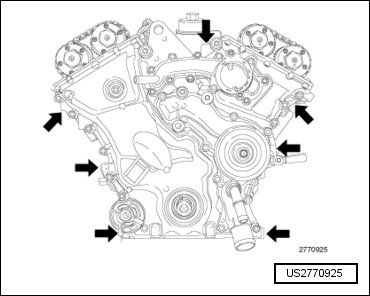

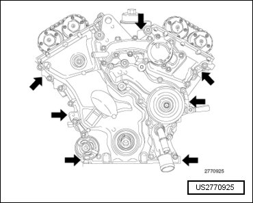

- Using the seven indicated pry points, carefully remove the timing cover.
pic 9

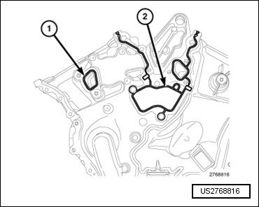

Do not use oil based liquids, wire brushes, abrasive wheels or metal scrapers to clean the engine gasket surfaces. Use only isopropyl (rubbing) alcohol, along with plastic or wooden scrapers. Improper gasket surface preparation may result in engine fluid leakage.
- Remove all residual sealant from the timing chain cover, cylinder head and engine block mating surfaces. Refer to => [ Engine Gasket Surface Preparation ] See: Engine > Procedures > Engine Gasket Surface Preparation.

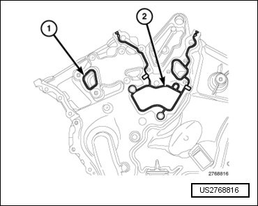

- Remove and discard the coolant outlet housing gasket (1) and the water pump gasket (2).
pic 12

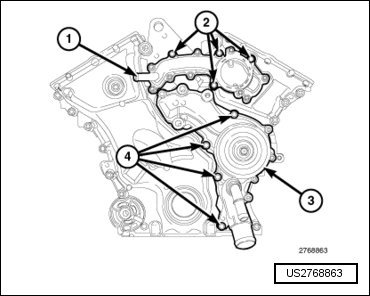

- If removed, install the coolant outlet housing (1) to the timing cover with a new gasket using only the four bolts (2) shown tightened to 12 Nm (106 in. lbs.).
pic 13
- If removed, install the water pump (3) to the timing cover using only the four bolts (4) shown. Refer to => [ Water Pump ] See: Water Pump > Removal and Replacement > Water Pump.
- Install the coolant outlet housing gasket (1) and the water pump gasket (2).
pic 14
pic 15

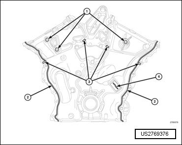

- Apply a 2 to 3 mm wide bead of Volkswagen genuine Engine RTV Sealant to the front cover as shown in the following locations:
Three cylinder head bosses (1)
Right and left flanges (2)
Four cylinder head to engine block T-joints (3)
Cover to right cam chain tensioner gap (4)
pic 16
- Align the locator pins (4) on the engine block to the engine timing cover and install the cover.

do you have some good pictures of the case cover itself? I would like to see the bottom, where any alignment pins are. Is the idler pulley and power steering pump pulley removal required? Looks like you could remove cover with out those or the frame member removed.
Is the diagram with the arrows the correct pry points for removing the case cover?
